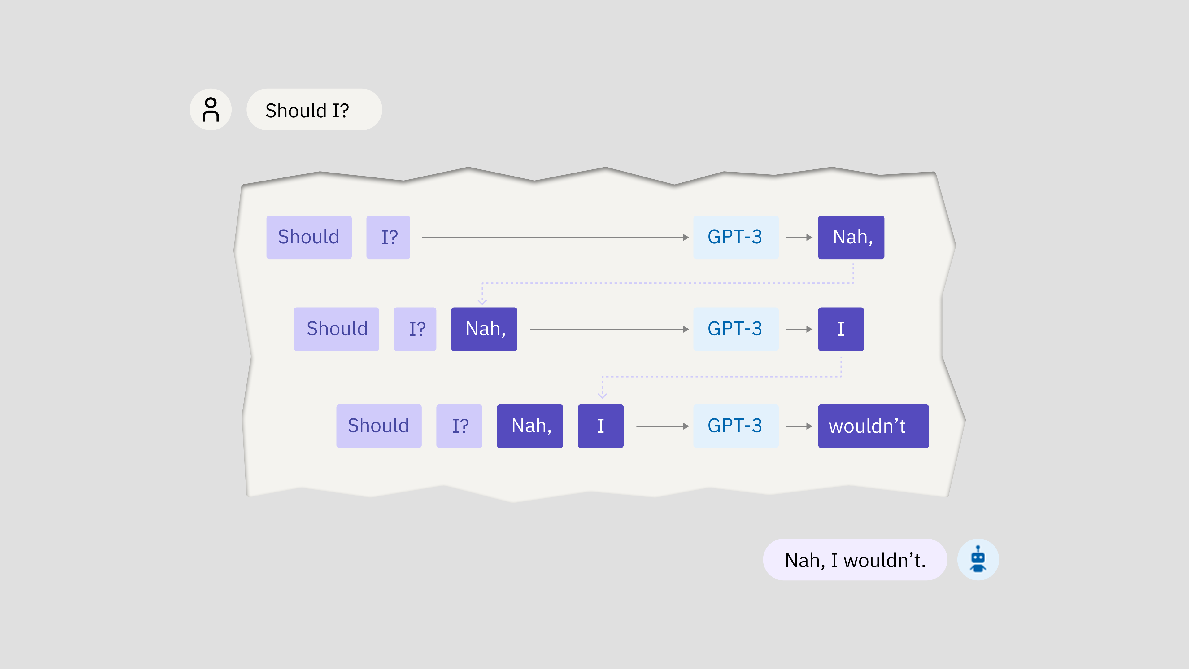

GPT-3, at last, can reply!
Not
And for the briefest moment, time stands still. GPT-3 pauses. In fact, it’s stuck.
Not
There GPT-3’s drafted response hovers, unfinished, fragmentary. For now, just a single word.
Even after that incredible 175-billion-parameter journey, all GPT-3 can do is spit out “Not.” All its circuitry ever evolved to do was to fill in the blank, to guess a single next word. It can’t produce a full response. Not with just one incredible journey, that is.
But it’s nothing that can’t be fixed with brute force. One journey across 175 billion numbers yielded one word? Then a second will yield a second.
In the blink of an eye, ChatGPT copy/pastes its fresh word (“Not”) onto the end of the initial human query. There is now a new and secret prompt, grown by just one word, a mix of the user’s question plus a nub of response:

Not
And now, all on the backend, that new query runs the whole entire numerical gauntlet again. Another incredible journey, this time with a newly added traveling companion in pole position, “Not.” The same dizzying dance through all 96 layers. This in turn yields one more piece of verbal fruit: “if.” Which is now copy/pasted back again.

And another journey! And another and another and another! Each fresh bit of output becoming a fresh bit of input, until finally the system decides that the “best next word” is no word at all, but silence. At last, GPT-3 has cobbled together a full response, which it can return to the user (who, thanks to the marvels of modern GPU chip processing, has waited all of a second).
“Should I eat this hot dog?” the user has asked.
“Not if you’re serious about that diet,” GPT-3 claps back.
Yet, to get that response took not one computational journey through the 577 spreadsheets, but seven, one for each word of the response. Seven frenzied daisy chains of mathematics involving every single one of the 175 billion parameters in the model.9
GPT-3 generates the first word of its response, then (invisibly) appends that to the user’s query for another pass. A three-word response involves three distinct passes through GPT-3’s 577 spreadsheets. GPT-3 generates the first word of its response, then (invisibly) appends that to the user’s query for another pass. A three-word response involves three distinct passes through GPT-3’s 577 spreadsheets.
