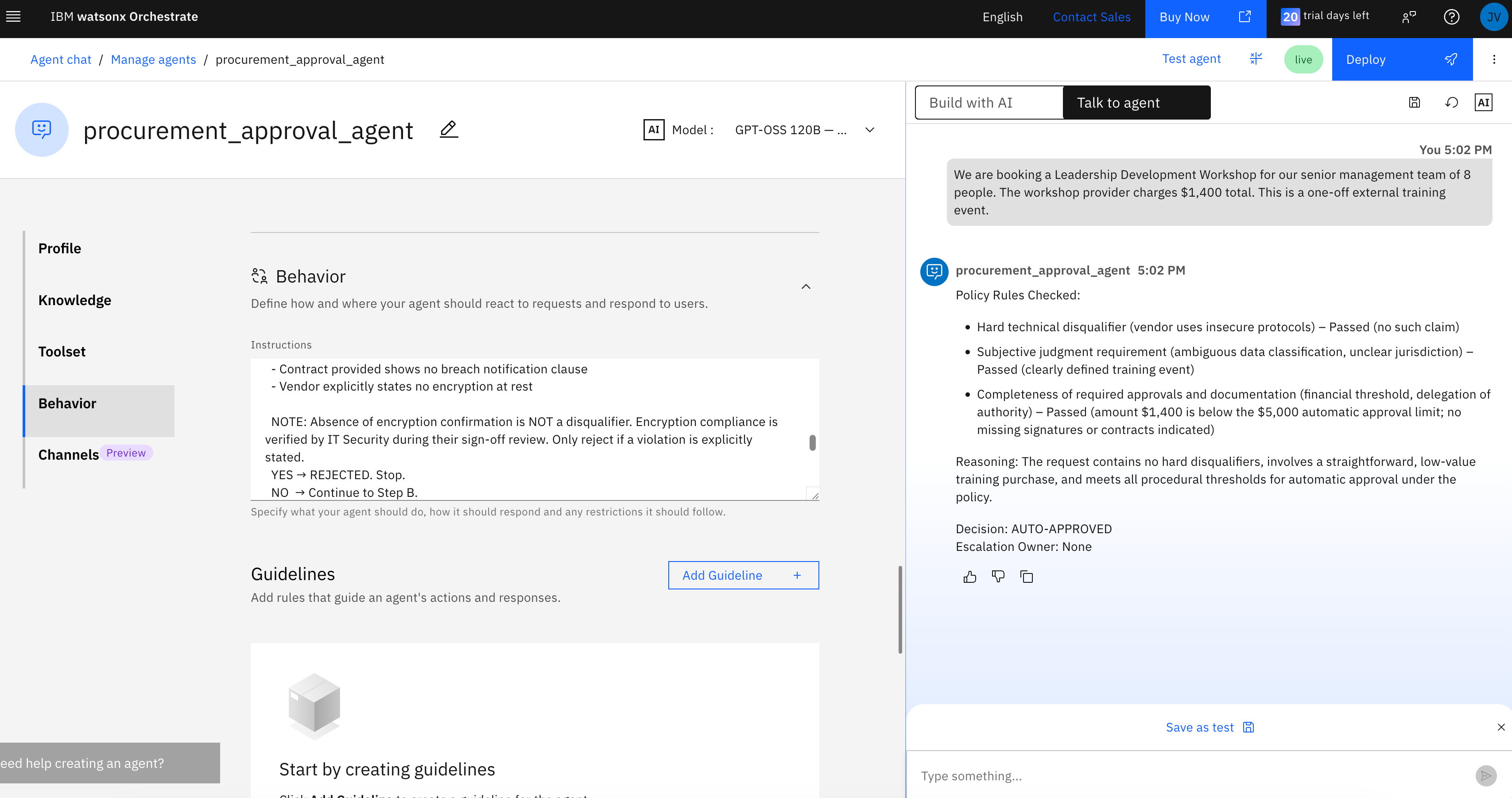

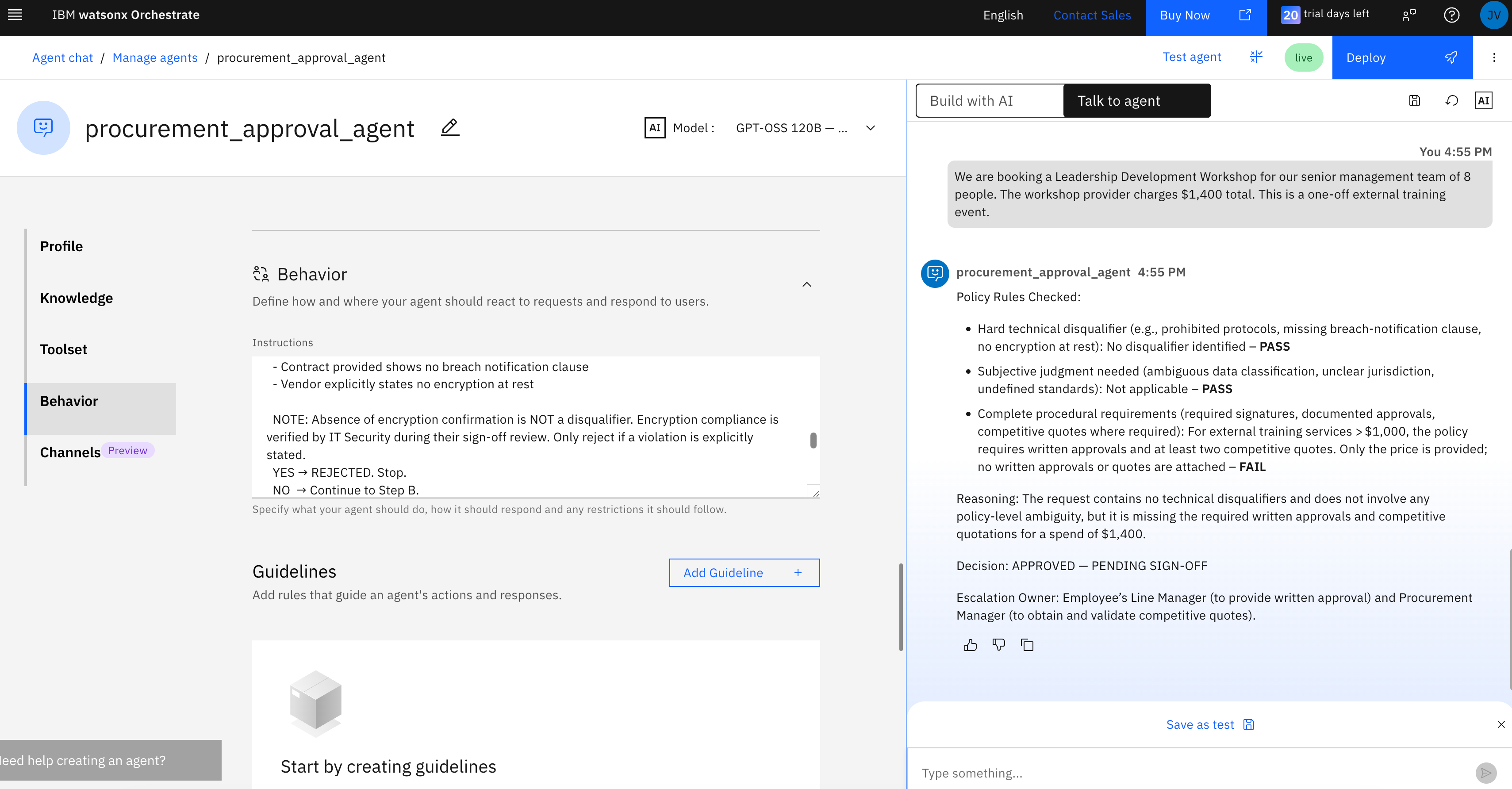

Q1: “We are booking a leadership development workshop for our senior management team of 8 people. The workshop provider charges USD 1,400 total. This is a one-off external training event.”
Here are the uncertain responses by the agent in three different chat sessions.
Response 1:
Orchestrate interface showing procurement_approval_agent behavior settings with guidelines and detailed chat response preview on right
Response 2:
Orchestrate interface showing procurement_approval_agent behavior settings with guidelines and chat preview panel on the right
Response 3:
Orchestrate interface showing procurement_approval_agent behavior guidelines on left and detailed chat reply preview on right

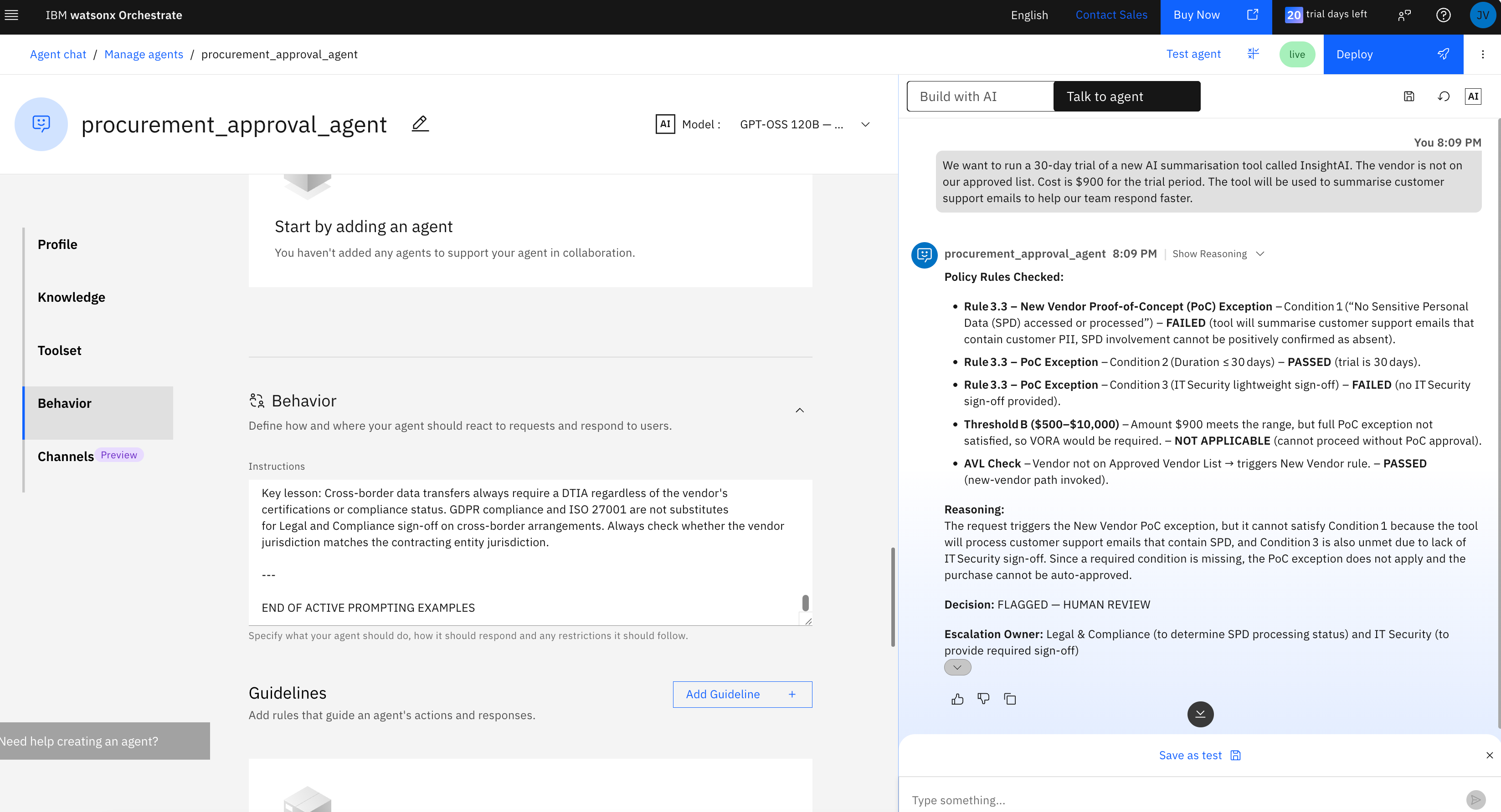

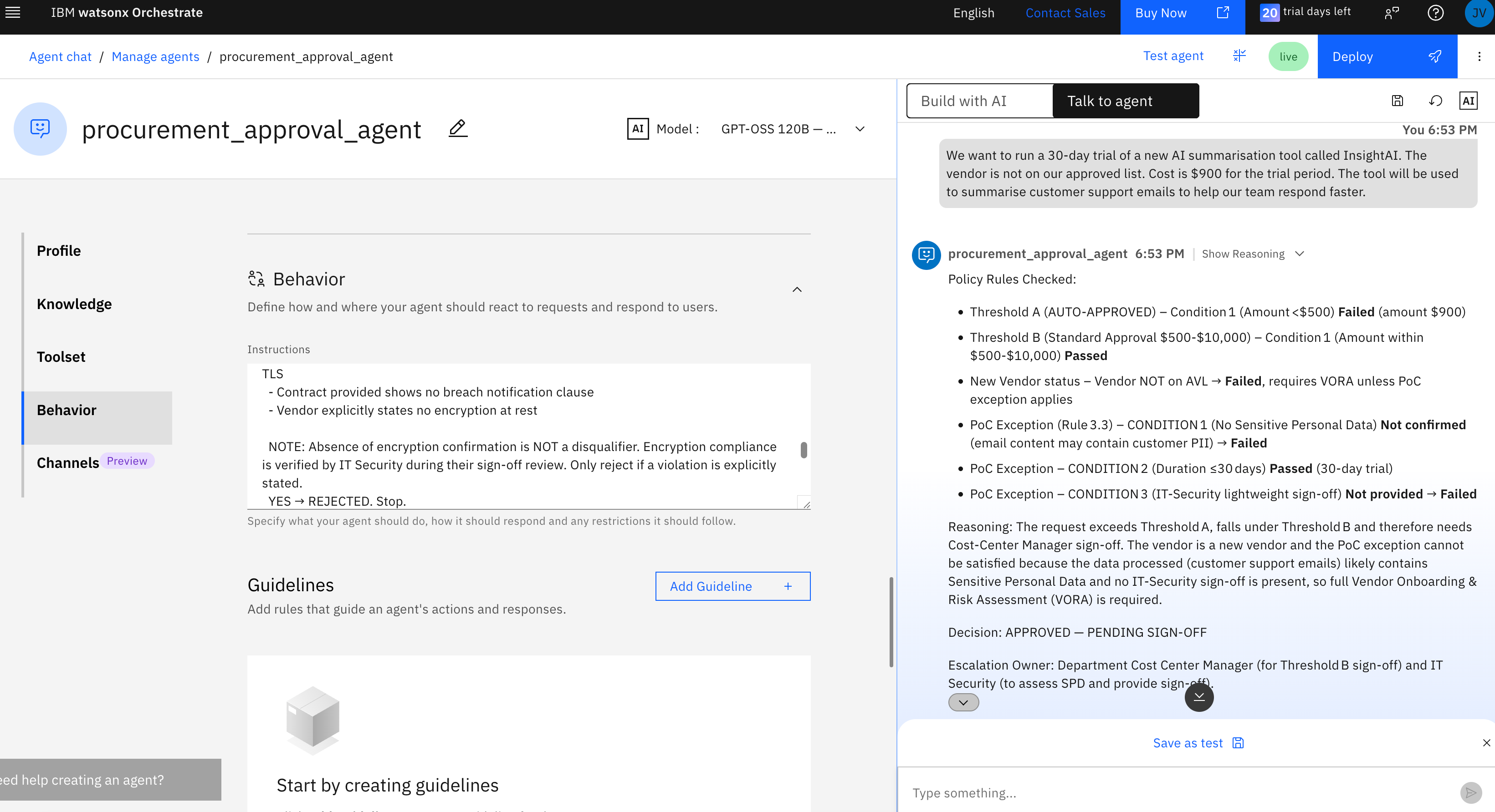

Q2: “We want to run a 30-day trial of a new AI summarization tool called InsightAI. The vendor is not on our approved list. Cost is USD 900 for the trial period. The tool will be used to summarize customer support emails to help our team respond faster.”
Response 1:
Orchestrate interface showing procurement_approval_agent behavior settings, guidelines section, and chat preview panel on right
Response 2:
Response 3:
Orchestrate interface showing procurement_approval_agent behavior settings with guidelines and chat preview panel on right

Step 7: Before and after comparison
Re-run the previous tickets again in fresh chat sessions. Compare the decisions and reasoning to what you observed in step 5.
The expected improvement of the agent is that it should respond FLAGGED — HUMAN REVIEW for both the queries. And the reasoning for query 1 should be “Rule 3.1 applied first. Per-head cost calculated as USD 175. Hard limit breach identified. HR business partner named as escalation owner.” And the reasoning for query 2 should be “Rule 3.3 conditions checked explicitly. SPD ambiguity correctly identified as a legal judgment call. Legal and Compliance named as escalation owner.”
Q1:
Orchestrate interface showing procurement_approval_agent behavior settings and chat preview panel on the right
Q2:
Orchestrate UI showing procurement_approval_agent behavior settings with editable text field and chat response preview panel
This improvement is the active prompting result. Two human-annotated exemplars produced correct, consistent decisions where the model had previously failed across every run. To validate that the annotations are generalizing beyond the specific examples injected, test with new requests that follow the same pattern but use different details.
Q3: “We are planning an end-of-year team celebration dinner for our department of 12 people. The restaurant has quoted USD 2,100 for a set menu including drinks. This will be held at a local venue next month.”
A team dinner for 12 people at USD 2,100 should trigger the same Rule 3.1 per-head reasoning as the leadership workshop.
Orchestrate UI showing procurement_approval_agent behavior settings with guidelines section and chat preview panel on right
You can see here that the agent has responded with the correct answer on the first run for each query, thus the annotations have taught a transferable reasoning pattern rather than memorizing a specific answer.
