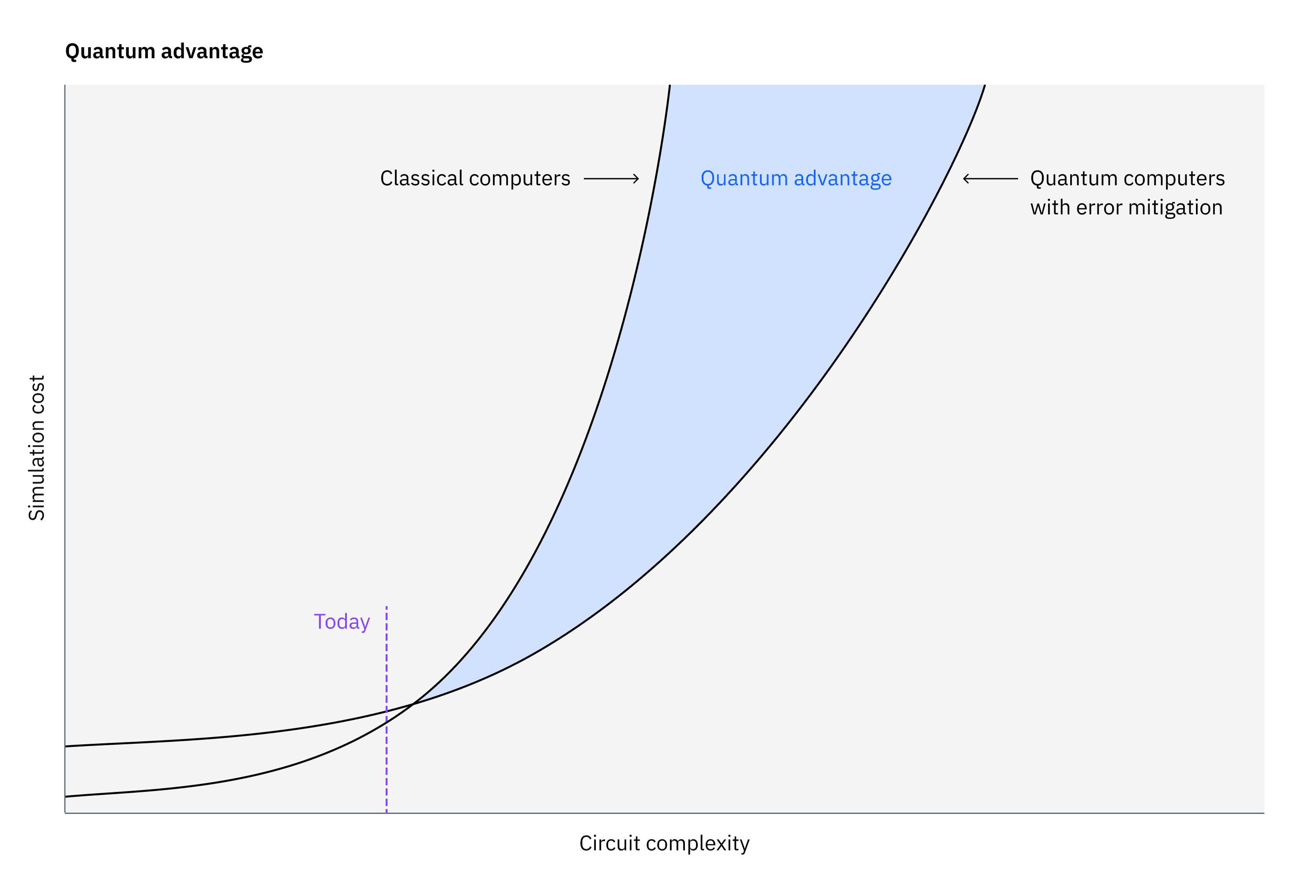

What is quantum advantage?
In our white paper, we define quantum advantage as the ability to execute a task on a quantum computer in a way that satisfies two essential criteria. First, the correctness of the quantum computer's output can be rigorously validated. Second, it is performed with a quantum separation that demonstrates superior efficiency, cost-effectiveness, or accuracy over what is attainable with classical computation alone.
This definition has several implications. The first is that we don’t expect quantum advantages to be achieved by quantum computers acting alone. Instead, they will emerge from use cases where we leverage quantum computers to augment a classical workflow. So, quantum advantage really means that “quantum plus classical” can outperform classical alone.
The ideal benchmark we strive for is an unconditional quantum separation — a clear, provable gap in algorithmic performance between quantum and classical computers. These separations are typically grounded in complexity theory-based assumptions or derived from direct comparisons with the best-known classical algorithms. In certain specific cases, researchers have already identified the potential existence of such separations. However, most existing results so far do not demonstrate the exponential performance advantage that quantum computers are poised to deliver.
Given that definition, we expect the first quantum advantage claims to arise in one of three problem areas: sampling problems, variational problems, and calculating expectation values of observables.
At the same time, it can be challenging to rigorously confirm when an advantage has occurred unless the result can be checked classically or uses the variational principle (see below), which is not always the case. Instead, we will need to rely on verifying each part of the computation on its own, which can be done using trusted methods of error detection and mitigation.
The requirement for rigorous validation implies that, in practice, research groups will hypothesize that they’ve demonstrated a quantum advantage, and then attempt to validate the result. At the same time, the community will respond with attempts to support or falsify the hypothesis. This back-and-forth will continue until we reach a consensus. We also believe that it positions variational problems and calculating expectation values as likely delivering the first proven advantages, given our ability to validate these kinds of problems.
That leads to a critical point: quantum advantage won’t be a single moment in time. Rather, we’ll see a number of hypotheses tested until eventually the community determines that quantum advantages have been realized.

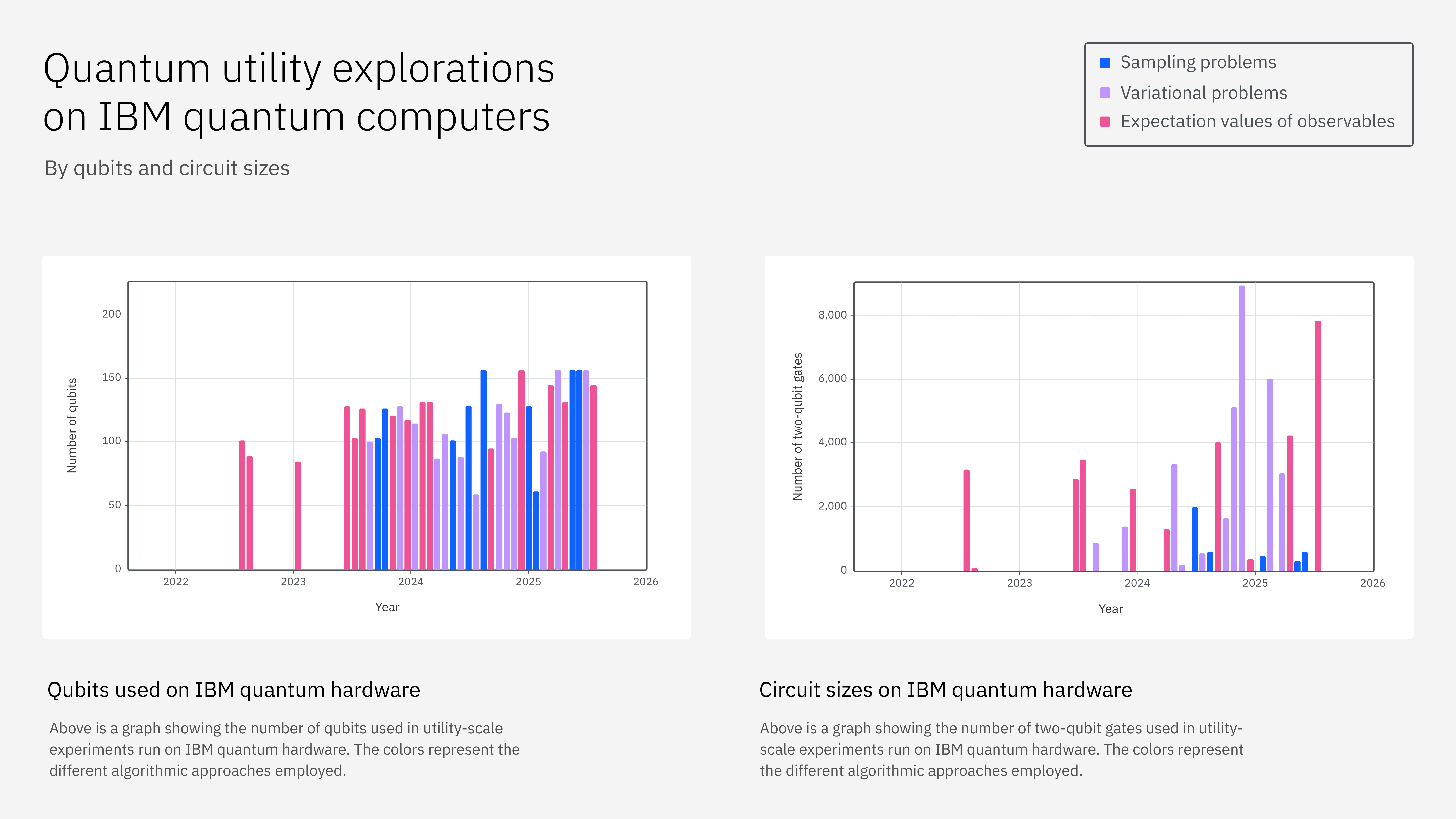

The seeds of advantage
Researchers using quantum computers are already uncovering potential paths toward achieving quantum advantage. These algorithms are using quantum as a computational tool for research investigating applications beyond what classical computing can achieve alone.
In other words, our users are sowing the seeds of quantum advantage: drafting and presenting the first hypotheses of advantage to the community.
Just recently, researchers at the startup Kipu Quantum claimed a runtime quantum advantage, where their quantum algorithm ran faster than specific-purpose classical solvers for dense, higher-order unconstrained binary (HUBO) optimization problems. They identified instances that were challenging for methods like CPLEX and simulated annealing, and found that running their BF-DCQO quantum algorithm on ever-improving quantum hardware reported faster approximate solutions. They expect their runtimes to be soon orders of magnitude faster as hardware continues to advance. In addition, the Kipu team tested BF-DCQO against Quantum Annealing and LR-QAOA. They found that BF-DCQO outperformed both alternative methods in accuracy, runtime and resources — specifically in terms of qubit overhead for Quantum Annealing and circuit depth for LR-QAOA — in the tested instances.
Startup Q-CTRL has also benchmarked IBM Quantum systems against classical, quantum annealing, and trapped-ion technologies for optimization — unlocking a more than 4x increase in solvable problem size and outperforming commonly used classical local solvers; capability that is available through their Optimization Solver application function. And in a recent collaboration with Network Rail on a scheduling solution, Q‑CTRL's Performance Management circuit function, which powers the Optimization Solver function, enabled the largest demonstration to date of constrained quantum optimization, accelerating the path to practical quantum advantage. In another demonstration, they generated a 75-qubit entangled state. This was achieved with the help of a new method for performing the entangling CNOT gate, plus a lightweight error-detection scheme. The result was an impressive feat of long-range quantum entanglement and computational gains (85%+ fidelity over 40 qubits).
Meanwhile, one family of algorithms combines quantum and classical computing resources to return solutions with comparable accuracy to the leading classical approximation methods for chemistry and materials science. These algorithms follow the variational principle, the principle that allows us to understand a system by calculating the minimum or maximum of a function.
