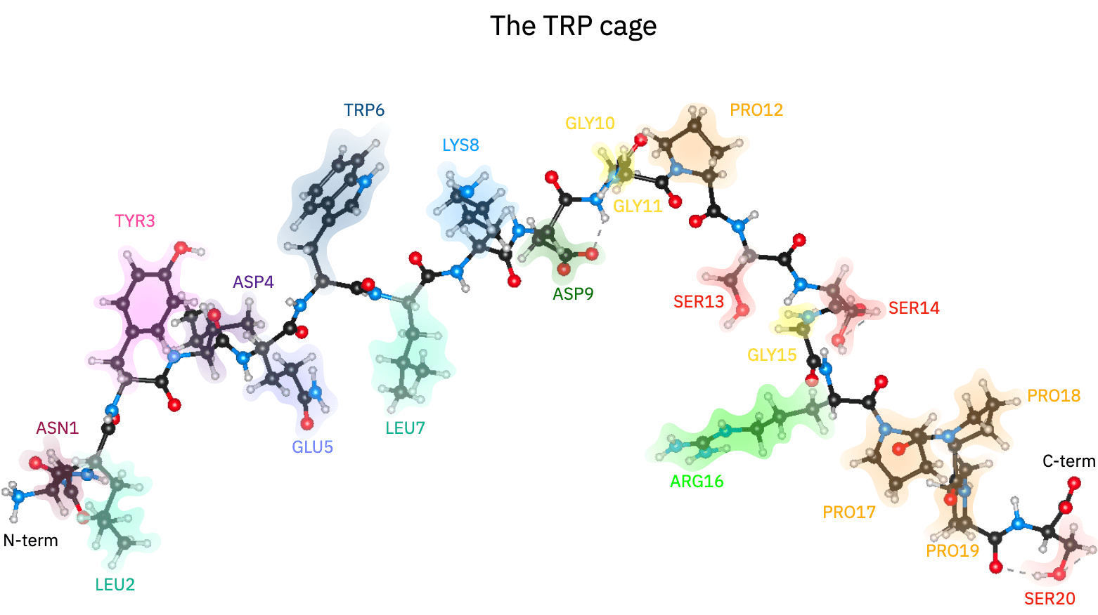

Trp-cage is useful for benchmarking computational chemistry methods. It's relatively compact for a protein, but it has features that are common to much larger molecules in biochemistry, such as a water-repelling or “hydrophobic” core and hydrogen bonding between its constituent parts, allowing it to take on more complex structures. The researchers modeled both its unfolded and folded (i.e., stretched and contracted) states.

The workflow, described in a recent preprint on arXiv, relies on a technique called wave function-based embedding (EWF) to fragment Trp-cage into computationally tractable pieces called “clusters.” In EWF, there are as many clusters as there are atoms in the molecule, but each cluster is more complex than a single atom: it encompasses a local region surrounding the atom and entangled with it.
In any given protein, some pieces or clusters are going to be much more complex than others. One atom may be all the way out on the edge of the protein, at the end of a covalent bond, and only entangled to one or two neighboring atoms. In those cases, researchers can find that cluster’s electronic structure efficiently using classical computational methods. Another might be closer to the molecular core, enmeshed in a more complex web of intermolecular interactions. These larger clusters are good problems for quantum computers to solve.
