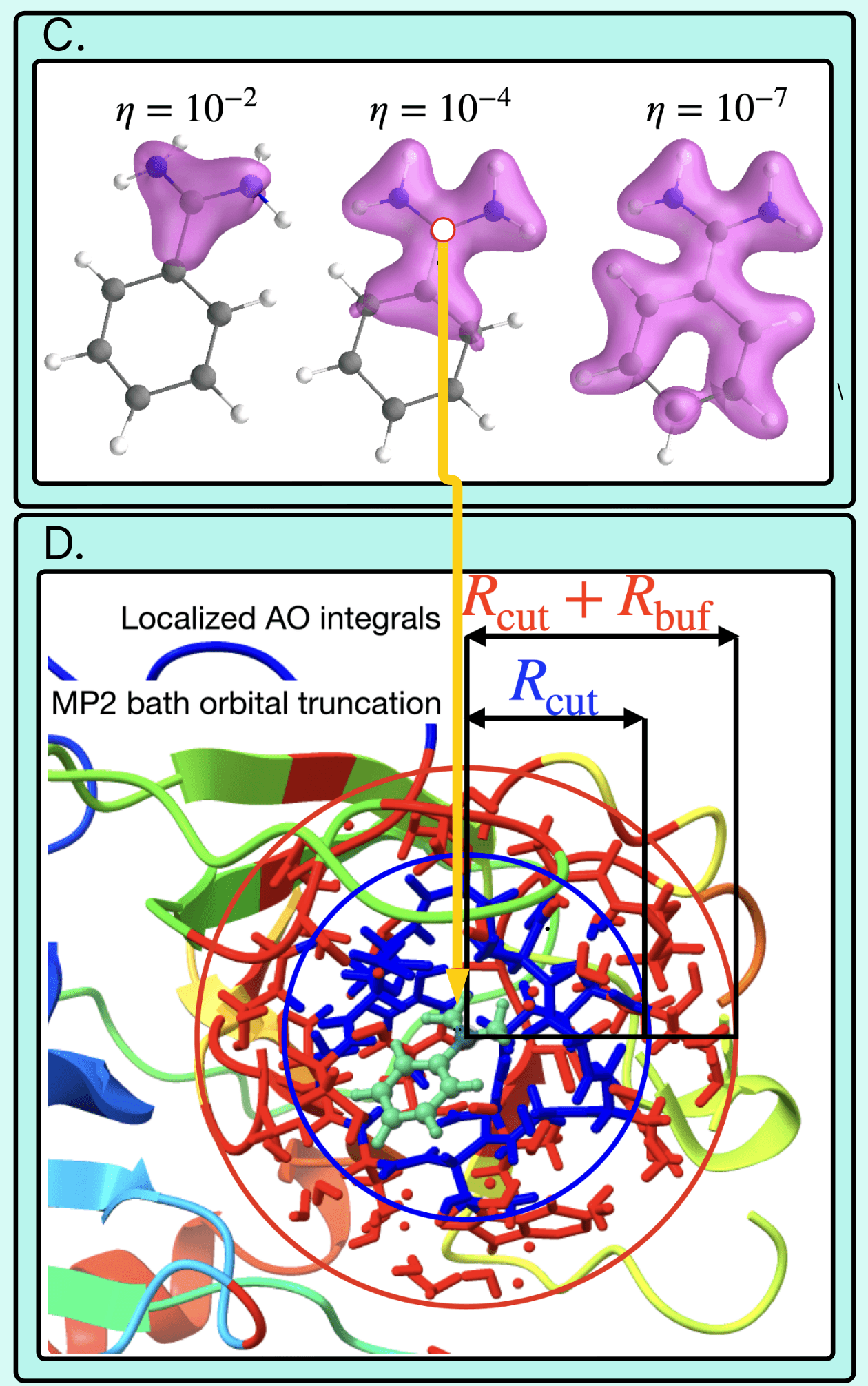

Breaking Trp-cage into workable clusters was a computationally intensive process, but achievable using limited HPC resources. At that scale, EWF relies on a partial understanding of how individual electrons interact across the molecule to find good break points.
In conventional implementations of the EWF method, creating the fragment “bath”—that is, selecting the highly entangled orbitals in the environment around individual fragments—is prohibitively expensive for molecules the size of Trypsin, said Mario Motta, IBM researcher and co-author of this work. That’s because the creation of the fragment bath is performed with Møller–Plesset second‑order perturbation theory or “MP2” calculations, which are computationally demanding.
Due to how MP2 calculations scale, if the size of the molecule doubles, the EWF method will require 25 times more classical computing resources to work. So, a 606‑atom molecule would require 32 times more computational effort to break into clusters than Trp‑cage. That’s not practical.
The good news is, any given electron in a molecule like Trypsin is “localized” to its local environs. Dr. Merz and his Cleveland Clinic colleagues figured so-called linear-scaling methods could be leveraged to simplify the calculation.
“Information that comes from more than 7-10 angstroms away doesn’t really affect the cluster at a quantum mechanical level, in this molecule. Entanglement is already dead and gone at that distance. So, one can restrict their MP2 bath expansion to a sphere centered around each atom,” Motta said.
By refining EWF to only consider those most important, local interactions, it became feasible to implement at the scale of Trypsin, Motta said.

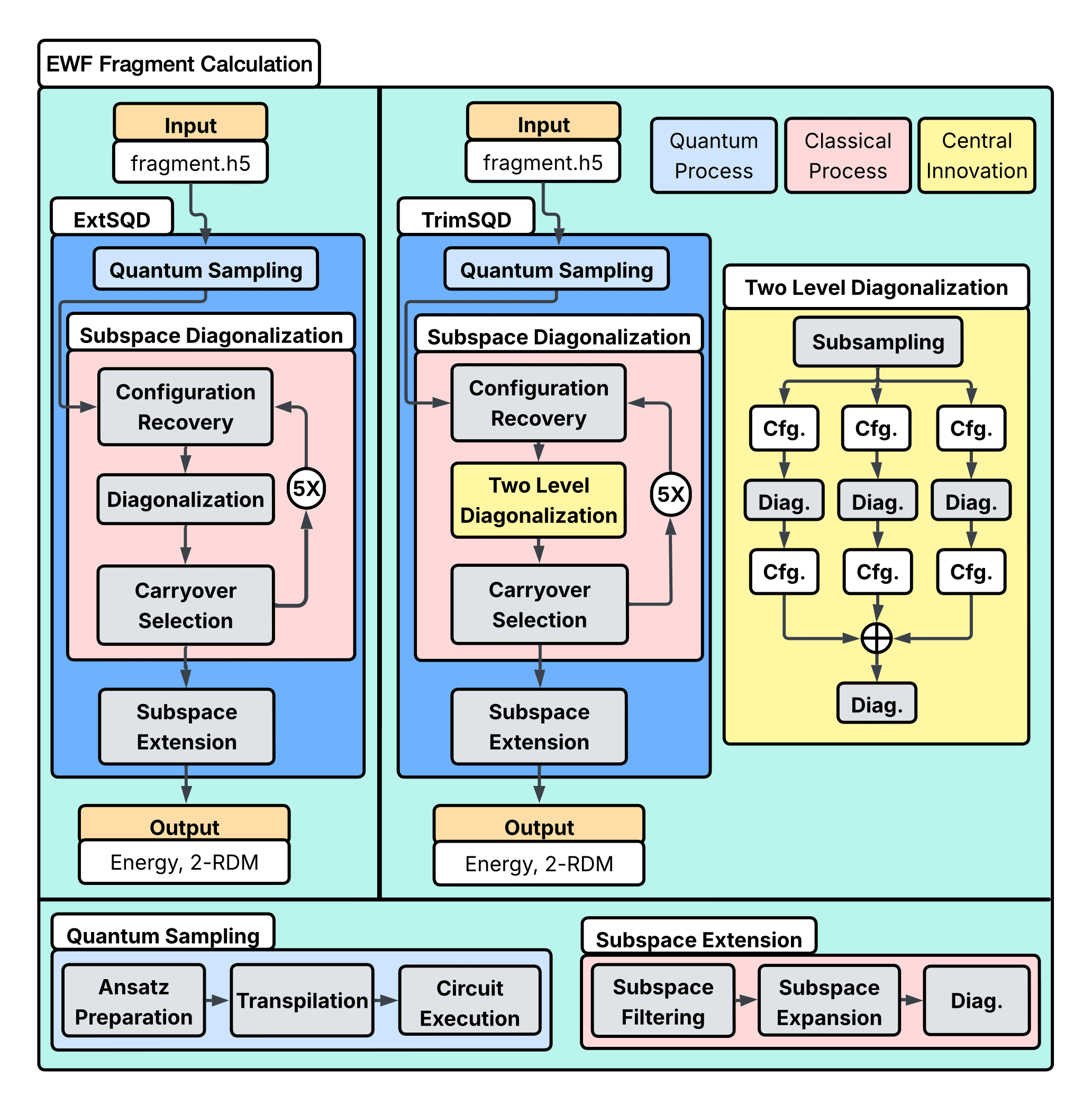

At the same time as they refined the classical methods, the team implemented a novel approach to SQD, enabling them to scale beyond what was previously possible. This novel method they called TrimSQD.
SQD addresses one of the fundamental challenges of electronic structure calculations: the number of possible configurations of a molecule’s electrons grows combinatorially with the molecule’s size. The quantum computer samples this vast space, identifying key configurations for the classical computer to focus on. The classical computer uses the resulting information to find a solution. This is the innovation that has made a number of important quantum chemistry results possible in the last 18 months, including the integration of SQD with EWF which enabled the benchmark Trp-cage calculation.
TrimSQD improves on the EWF SQD workflow to better identify the useful pieces for the quantum computer to focus on. It works by breaking the search area into subspaces that can each be searched individually.
The ground state is a superposition of a very large number—combinatorially large, in fact—of electronic configurations. Some configurations contribute significantly and some do not. Theoretical chemists like Klaus Ruedenberg call the significant configurations “livewood” and the others “deadwood.” Searching for a significant configuration is “like trying to solve a very twisted puzzle,” Motta said.
Maybe you’re trying to assemble Jacques-Louis David’s painting “The Coronation of Napoleon” out of many similar-looking pieces, Motta said, as an example of livewood. But someone has mixed in pieces from Van Gogh’s “Starry Night” and Kahlo’s “The Two Fridas”—a non-optimal quantum circuit, or noise on quantum device may have introduced configurational deadwood. SQD would dig through a large pile of puzzle pieces to find relevant pieces. TrimSQD separates the problem into multiple smaller piles where Napoleon and Josephine’s “livewood” faces stand out more clearly against the clutter.
The improved EWF workflow and TrimSQD fed into a paradigmatic example of quantum-centric supercomputing at scale. The team distributed the quantum sampling work across two Heron r2s—ibm_cleveland, located at Cleveland Clinic, and ibm_kobe at RIKEN. Then, they split the task of diagonalizing the subspaces that the quantum computers returned between the supercomputer Fugaku at RIKEN and Miyabi-G, a GPU-accelerated supercomputer operated by the University of Tokyo and the University of Tsukuba. QPUs, GPUs, and CPUs all contributed as part of a problem-solving compute architecture, offering a vision of the future of supercomputing.
