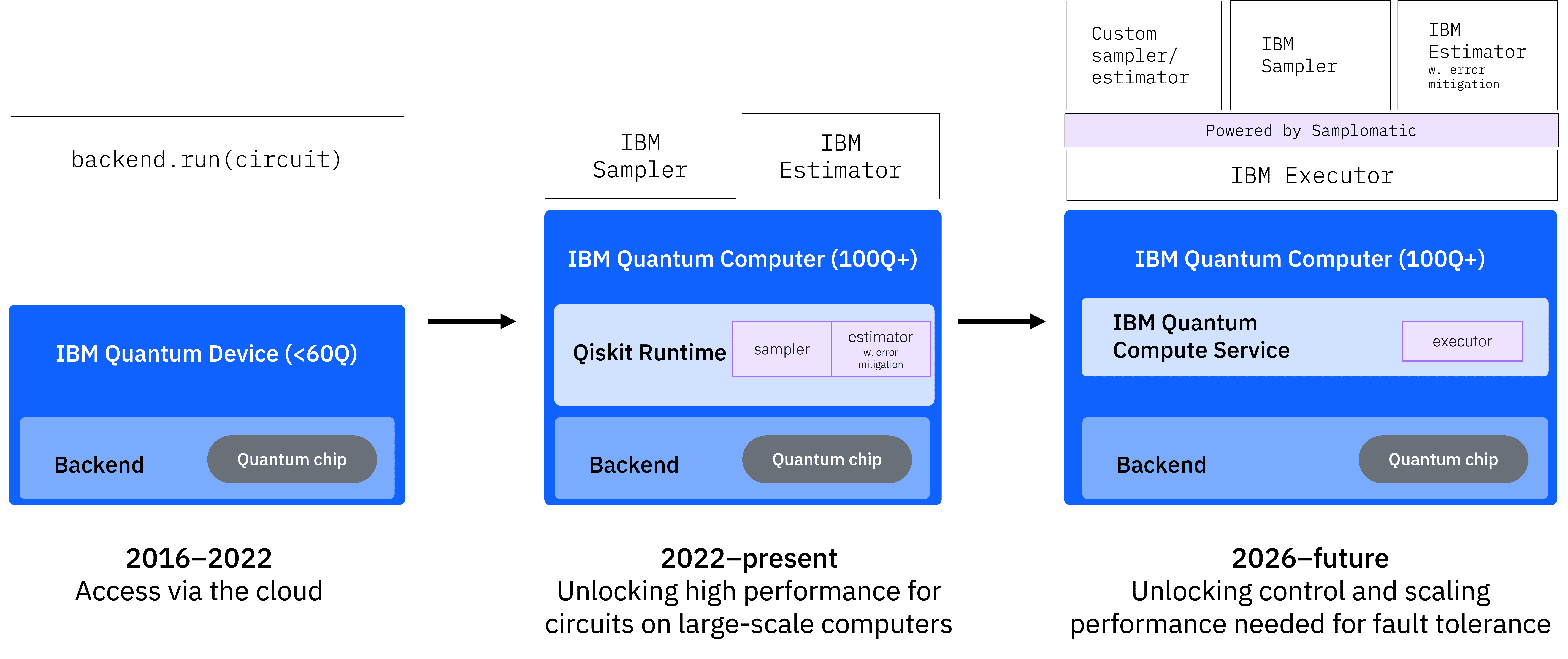

Let's take a look back at how we got here. Execution on IBM Quantum hardware started with backend.run, a direct method for running a list of circuits. This was fine when workloads were just a handful of circuits, but advanced experiments increasingly came to rely on large families of circuit variants for twirling, randomization, and noise learning, each of which had to be built on the client side and shipped over the wire. The Sampler and Estimator primitives changed that, generating variants server-side in the near-time environment then known as Qiskit Runtime, now IBM Quantum Compute Service. This boosted performance at scale, but turned execution into a black box.
Directed execution is the next step. It brings us back to a single entry point, but this isn’t simply a return to backend.run. The machinery behind it has been rebuilt to give you a level of control and performance that wasn’t possible before. You can now build algorithmic primitives like Sampler and Estimator on the client, tailored to your use case, then send them for Executor to process as directed in the near-time environment of IBM Quantum Compute Service.
Evolving the programming model, from backend.run (2016–2022) to the server-side Sampler and Estimator (2022–present) to the Executor primitive (2026 onward).

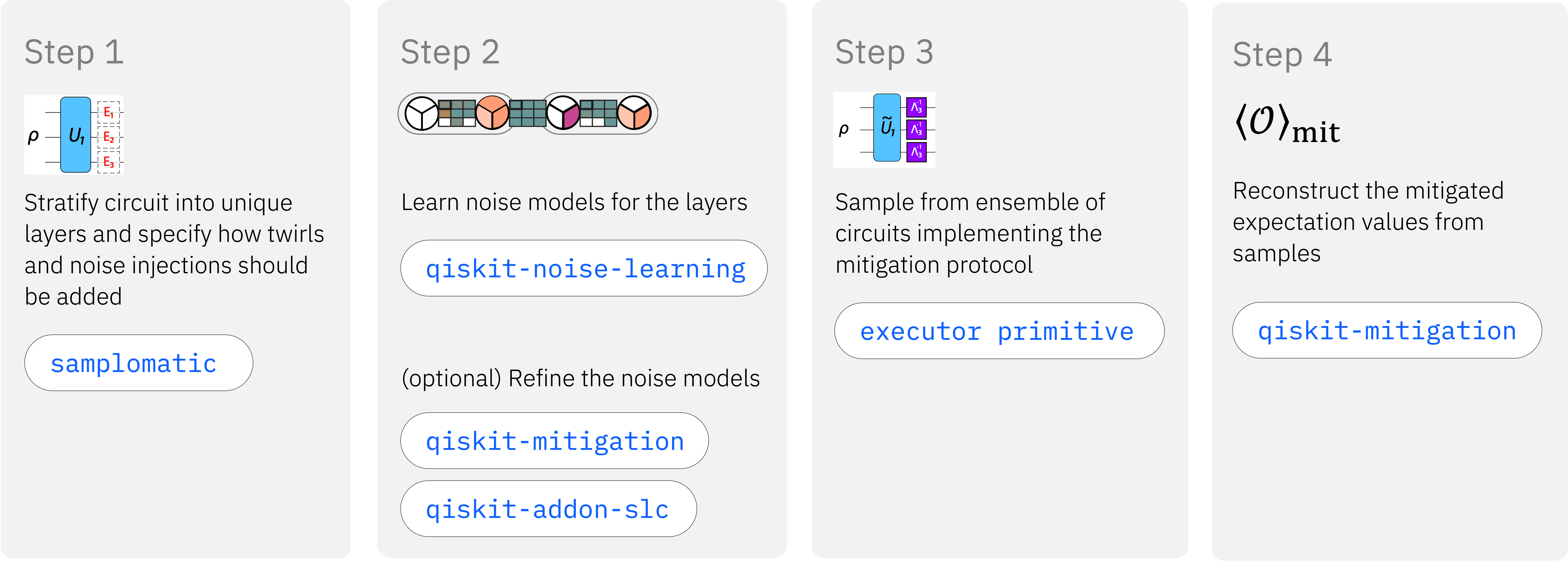

A typical error-mitigation workflow in four steps, and the directed-execution package that handles each: Samplomatic, Qiskit Noise Learning, Qiskit Mitigation, and the Executor primitive.

1. Map the problem. Define your observable and the measurement bases you'll need.
observable = SparsePauliOp.from_sparse_list(target_obs_sparse, num_qubits=num_qubits) bases_virt, reverser_virt = get_measurement_bases(observable)
2. Optimize. Transpile the circuit and group its instructions into annotated boxes with Samplomatic. Then compute the shaded-lightcone bounds that identify which errors you can safely leave unmitigated.
from samplomatic.transpiler import generate_boxing_pass_manager from qiskit_addon_slc.bounds import compute_forward_bounds, merge_bounds boxed_circuit = generate_boxing_pass_manager( twirling_strategy="active", inject_noise_strategy="individual_modification", measure_annotations="all", ).run(isa_circuit) forward_bounds = compute_forward_bounds(boxed_circuit, noise_model_paulis, isa_observable, ...) merged_bounds = merge_bounds(boxed_circuit, forward_bounds, backward_bounds, noise_model_rates)
3. Execute. Learn the noise on each unique layer, turn the bounds into per-error scales, then build the template circuit and samplex and run the whole program through Executor in a single job.
# Learn the noise on each unique layer noise_learner = NoiseLearnerV3(backend, noise_learner_options) refs_2_plm = noise_learner.run(unique_2q_instructions).result().to_dict(unique_2q_instructions) # Turn SLC bounds into per-error scales local_scales, sampling_cost, _ = compute_local_scales(boxed_circuit, merged_bounds, refs_2_plm, ...) # Build the template circuit + samplex, then execute template_circuit, samplex = samplomatic.build(boxed_circuit) program = QuantumProgram(shots=shots_per_randomization, noise_maps=refs_2_plm) program.append_samplex_item( circuit=final_template_circuit, samplex=samplex, samplex_arguments=samplex_arguments, shape=(num_randomizations,), ) results = Executor(backend).run(program).result()
4. Post-process. Apply TREX and postselection to the raw results to recover mitigated expectation values.
mask = post_selector.compute_mask(datum, strategy=post_selection_strategy) res = executor_expectation_values( meas, reverser_virt, ..., postselect_mask=mask, rescale_factors=trex_scale_factors, gamma_factor=gamma, )
