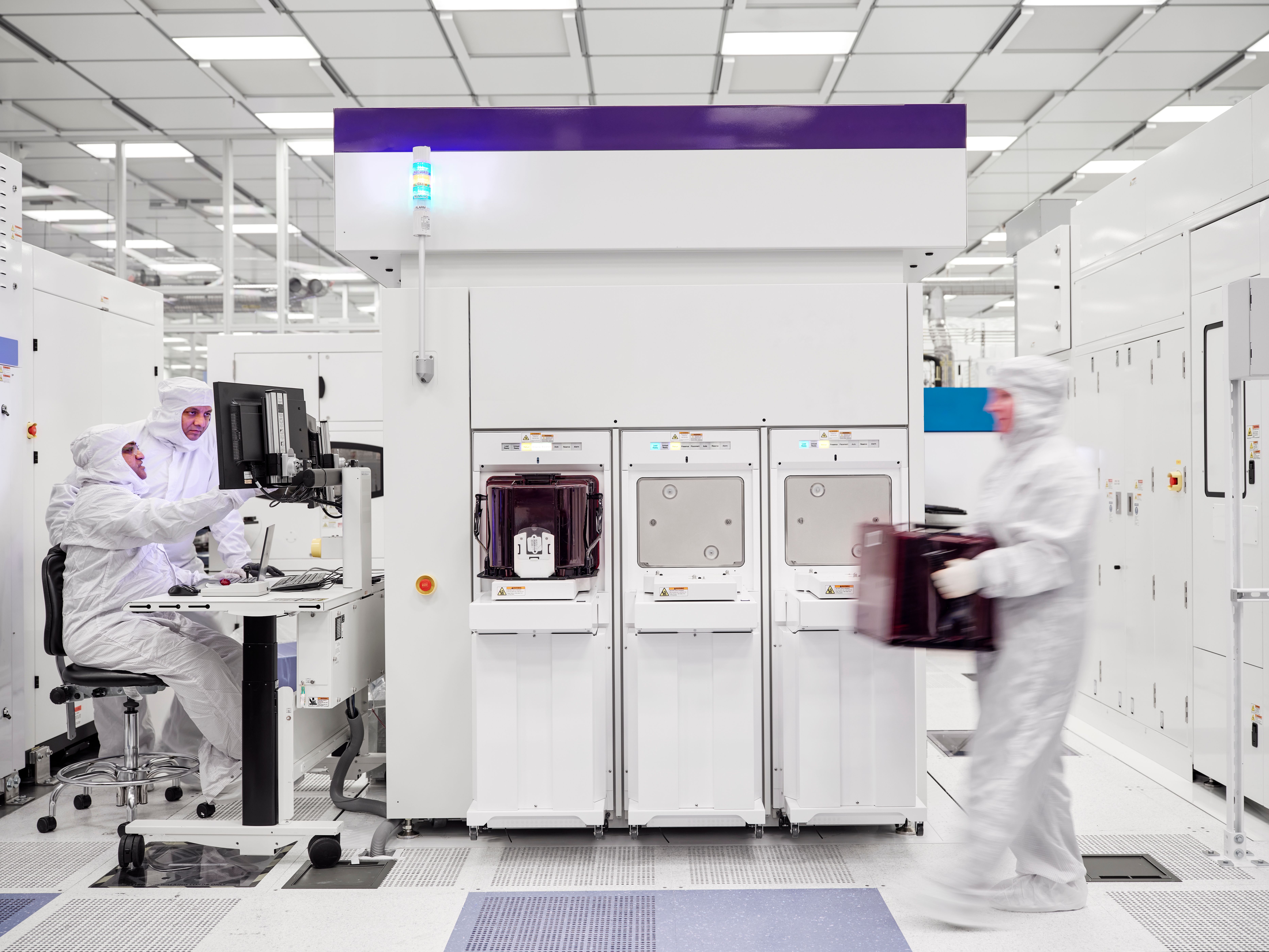

300mm cleanroom at the Albany NanoTech Complex in Albany, NY (Credit: IBM)

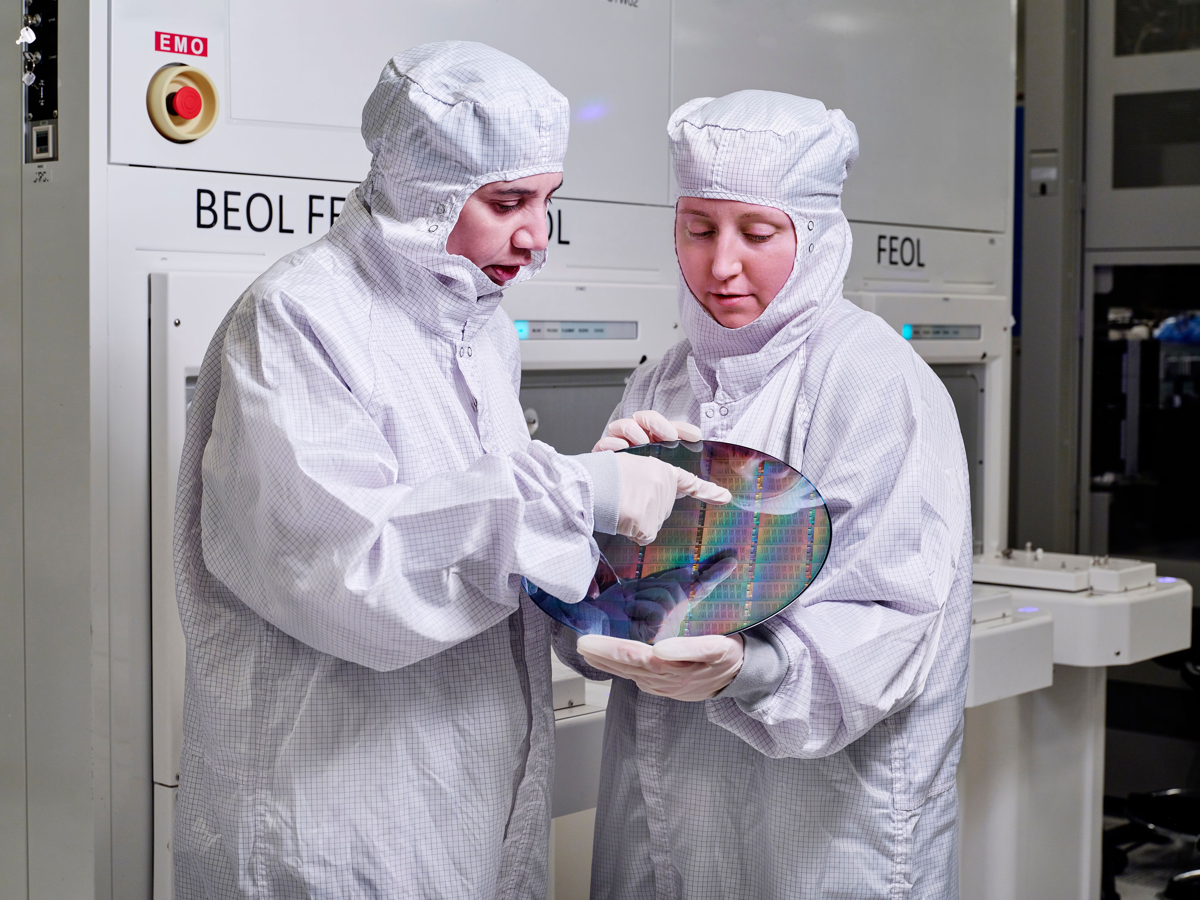

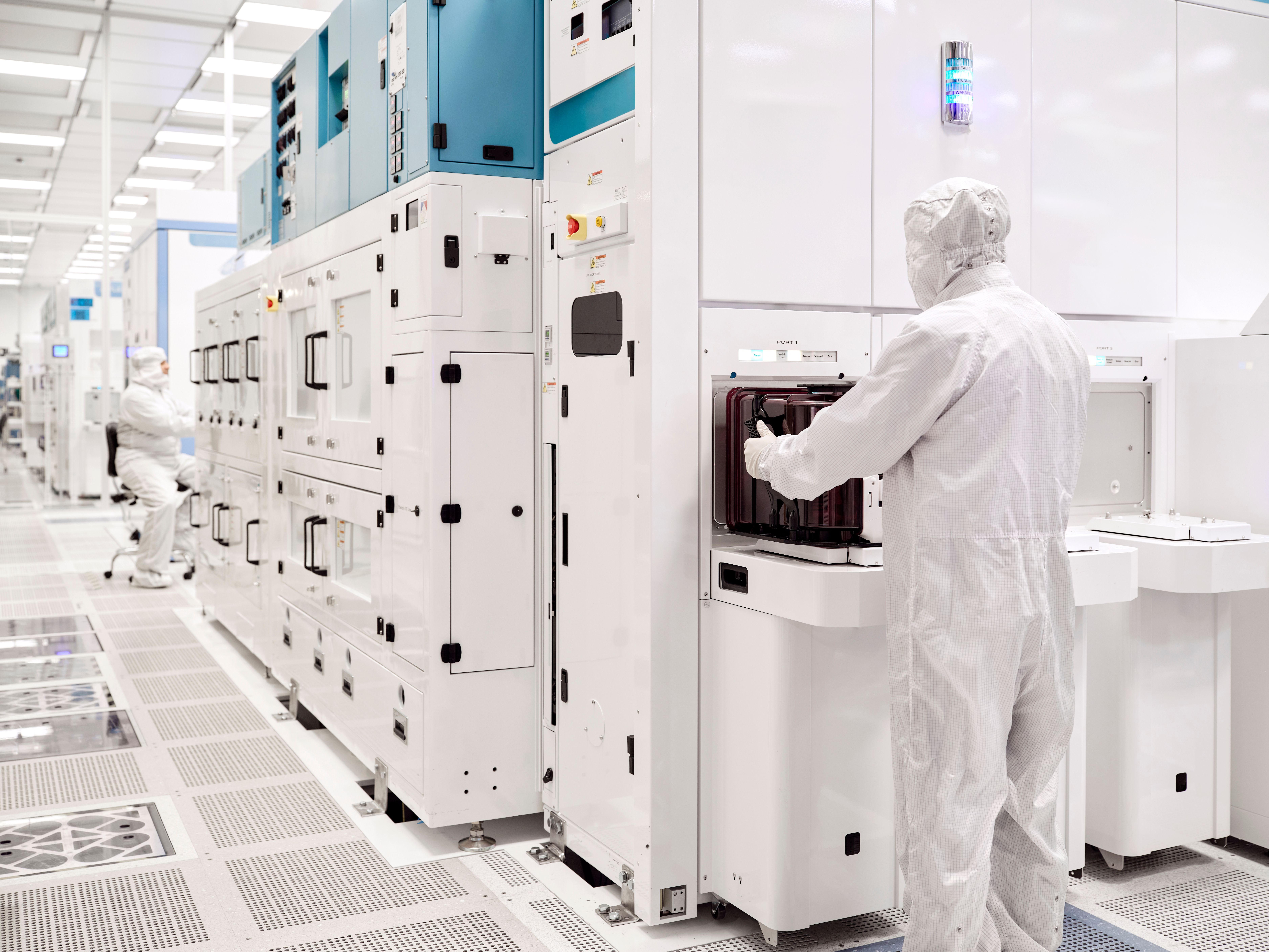

IBM researcher holding 300mm IBM Quantum Loon wafer (Credit: IBM)
