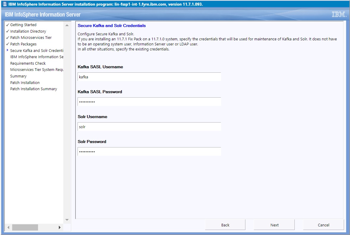

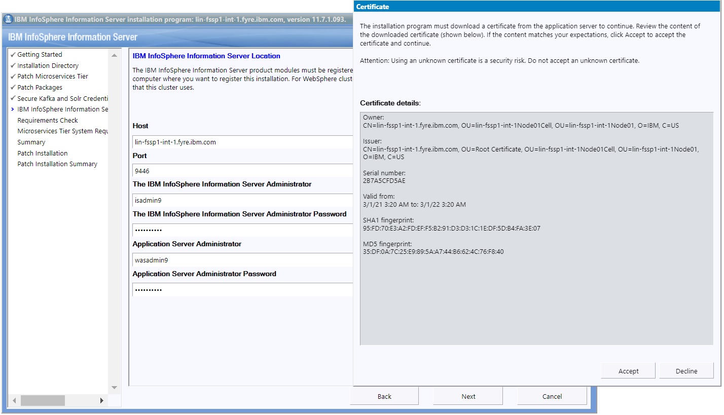

4.1.4) Provide information as required in each panel to complete the installation.
               Click Login.

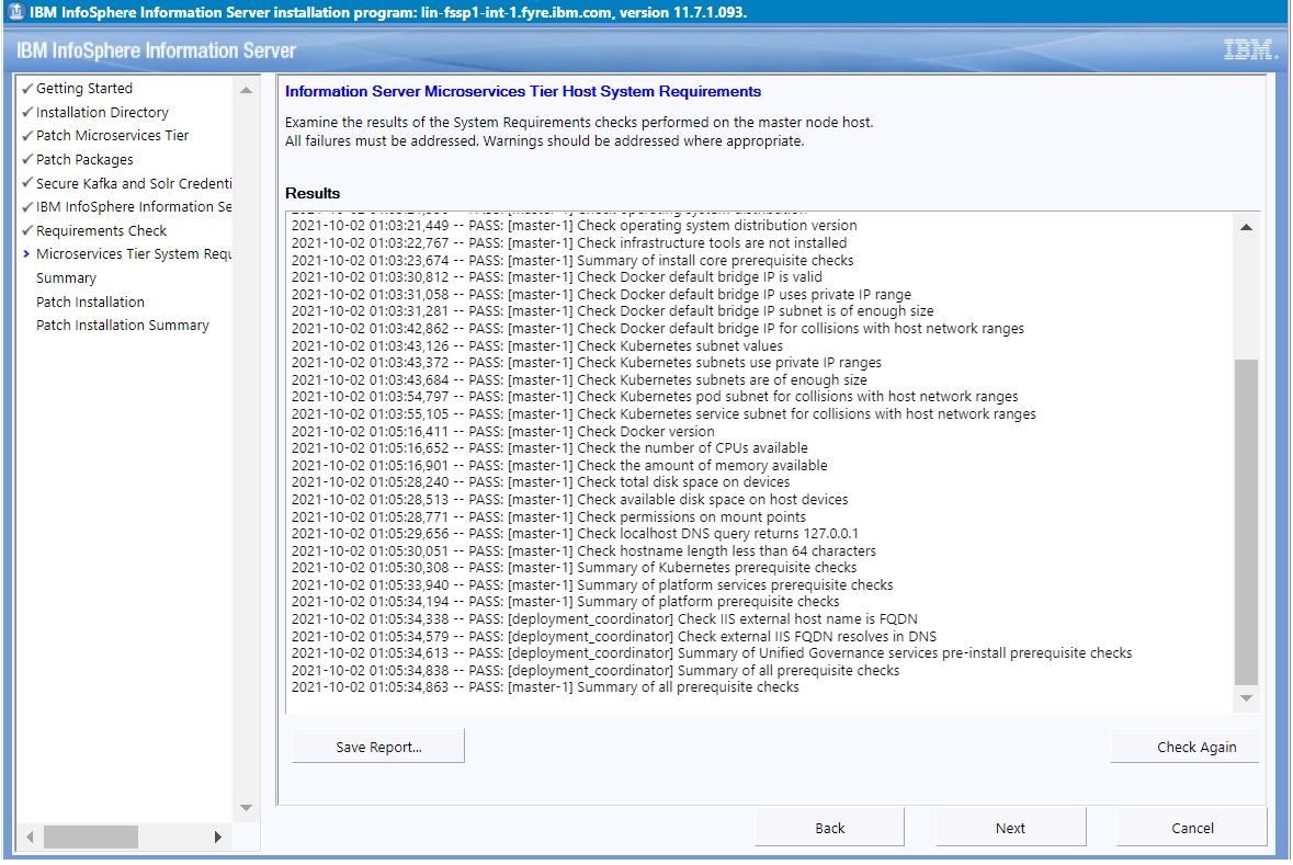

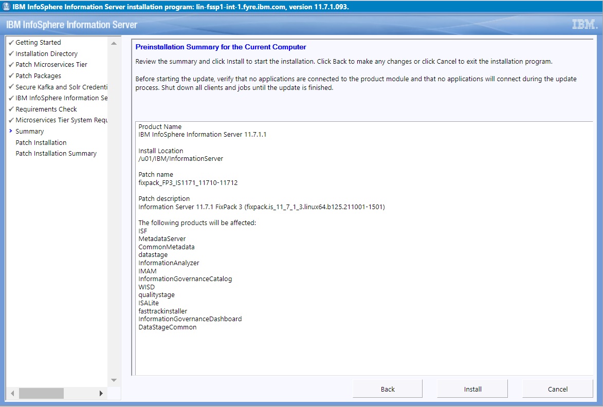

4.1.6) The Update Installer displays the Information Server installation directory. The contents of the displayed panel depends on whether Watson Knowledge Catalog is installed.
4.1.6.1) If your installation does not include Watson Knowledge Catalog, click Next.
image-20211007162216-2
4.1.6.2) If Watson Knowledge Catalog is installed, select the checkbox to indicate whether you intend to apply 11.7.1 Fix Pack 3 to your version 11.7.1.0 installation. Installations with Watson Knowledge Catalog are not permitted to install 11.7.1 Fix Pack 3 until Watson Knowledge Catalog is manually uninstalled. See technote for steps to manually uninstall Watson Knowledge Catalog.
4 1 6 2
           If you select the checkbox to apply Fix Pack 3 to your version 11.7.1.0 installation, and click Next, the following error is displayed.
4 1 6 2-2

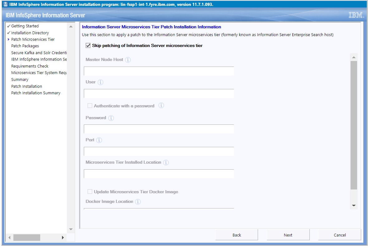

4.1.7) In this step choose whether to upgrade the Microservices tier.
4.1.7.1) If you do not have a Microservices tier select the "Skip installation of Information Server microservices tier" checkbox.
                Since addition of a Microservices tier during the Fix Pack upgrade is not supported, click Next and skip forward to step 4.1.8.
                Later, if needed you can add a Microservices tier. Refer to technote for details.
MS_SKIP_UPGRADE
4.1.7.2) If you have a Microservices tier, you might choose to skip its upgrade while your other Information Server tiers are upgraded to 11.7.1.3.

                Select the "Skip patching of Information Server microservices tier" checkbox to skip the upgrade.
                Click Next.

4.1.7.3) To upgrade the Microservices tier
                        Note:
                                 1. In case you previously installed the Microservices tier by following technote, you must skip upgrading the Microservices tier in this step and instead, follow the instructions in step 4.1.7.2.
                                 2. The Microservices tier must be at the same version as the Information Server services tier.
                                 3. All pods must be up and running.
                                       You can check the status of the pods by running the following command:
                                               kubectl get pods --all-namespaces
                                 4. Ansible version 2.9 must be installed.
                                       Information on Ansible can be found at https://docs.ansible.com/ansible/2.9/installation_guide/intro_installation.html.
                  Provide the relevant information in the panel:
                  a. Deselect the "Skip patching of Information Server microservices tier" checkbox.
                  b. Specify a fully qualified domain name for the Master Node Host.
                  c. Specify the same User as was used during the initial installation of the Microservices tier.
                  d. For more information on "Authenticate with a password", see section 2.2.
                  e. If you specify a non-root user, in /etc/security/limits.conf, the hard and soft setting of nofile and nproc for the specified user must be 10240.
                       Also, umask must be set to 022 in ~/.bashrc.

4.1.9) Provide credentials to be used for Kafka and Solr (for example, solruser, solrpwd etc). The Update Installer creates the specified users in Kafka and Solr; they do not have to be an operating system user, Information Server user, or LDAP user.
           Later, you can use the specified values for maintenance actions such as accessing the Solr web UI.
            Click Next.

4.1.10) Provide the Information Server Administrator user name and password. Accept the certificate and click Next.
               Accept the certificate. Click Next.

4.1.12) If you have a Microservices tier, examine the results from system requirement checks of the Microservices tier. If all is good, click Next.
image-20211007165500-9

4.1.13) Review the Preinstallation Summary and click the Install button to start the installation.

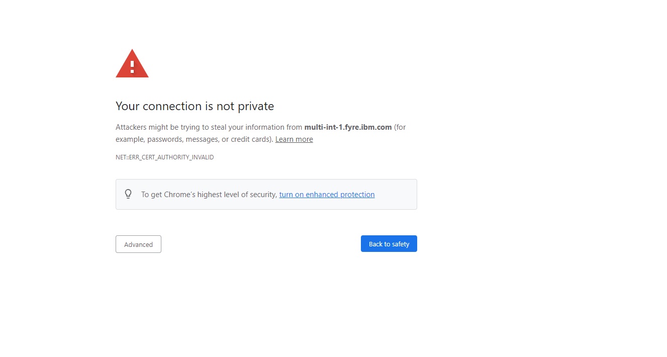

4.1.15) Click “Advanced”.
image-20211007170008-13
4.1.16) Click the link "Proceed to ..."
image-20211007170305-14

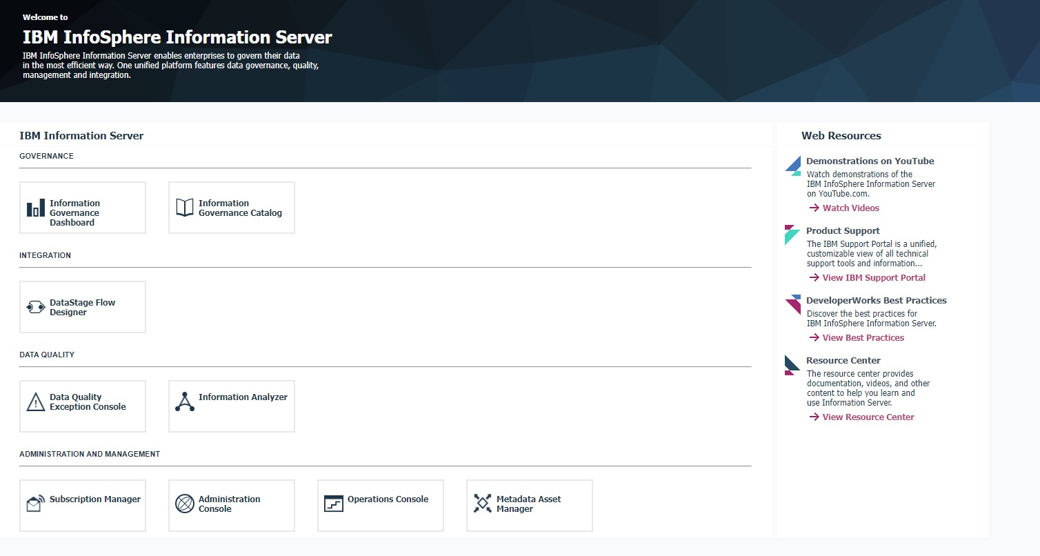

4.1.17) The Launchpad is displayed.
4.1.17.1) If you don't have a Microservices tier, the Information Server Launchpad is displayed.
image-20211007170500-16

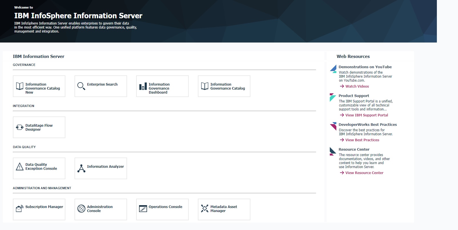

4.1.17.2) If you have a Microservices tier, the Information Server (Microservices) Launchpad is displayed.
image-20211007170400-15
