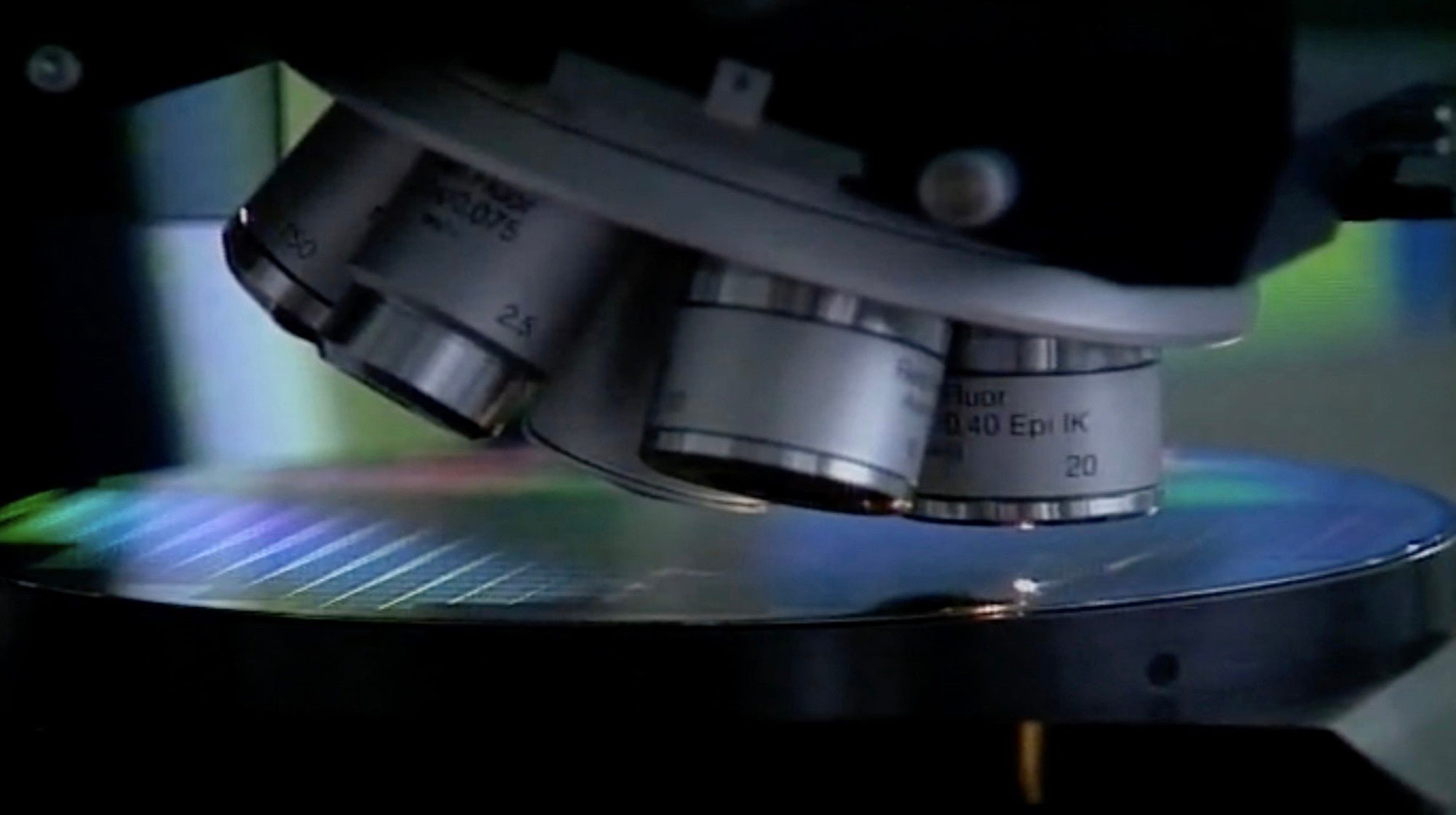

Close-up view of a microscope with several lenses focused on a silicon germanium chip A microscope with several lenses focused on a silicon germanium chip

Creating a basis for silicon and germanium layers required first removing a contaminating dioxide, which Meyerson did by baking samples to 1,000 degrees Celsius. But the SiGe alloy couldn’t stand up to the heat. Recalling the incident from three years prior, he cleansed a sample in hydrofluoric acid and watched as a protective sheath of hydrogen formed on the silicon. As it turned out, that sheath, which is what made the chip repel water, dissipated at a much lower temperature, just south of 600 degrees — creating a clean slate on which the oxide could form while the chip remained intact.
“That was the epiphany,” Meyerson later explained. “Simply growing materials below 600 degrees avoided the whole problem. It was the most bizarre finding I’ve ever had, but it also gave us a 10-year head start on the rest of the world because nobody understood the effect, so away we went.”
