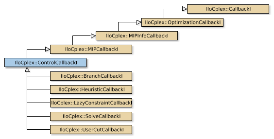

Class IloCplex::ControlCallbackI
Definition file: ilcplex/ilocplexi.h
Map of IloCplex::ControlCallbackIIloCplex::ControlCallbackIIloCplex::BranchCallbackIIloCplex::HeuristicCallbackIIloCplex::LazyConstraintCallbackIIloCplex::SolveCallbackIIloCplex::UserCutCallbackIIloCplex::ControlCallbackIIloCplex::MIPCallbackIIloCplex::MIPInfoCallbackIIloCplex::OptimizationCallbackIIloCplex::CallbackI
Note
This is an advanced class. Advanced classes typically demand a profound understanding of the algorithms used by CPLEX. Thus they incur a higher risk of incorrect behavior in your application, behavior that can be difficult to debug. Therefore, the team encourages you to consider carefully whether you can accomplish the same task by means of other classes instead.
This class defines the common application programming interface (API) for the following classes that allow you to control the MIP search:
An instance of one of these classes represents a user-written callback that intervenes in the search for a solution at a given node in an application that uses an instance of IloCplex to solve a mixed integer program (MIP). Control callbacks are tied to a node. They are called at each node during IloCplex branch-and-cut search. The user never subclasses the IloCplex::ControlCallbackI class directly; it defines only the common interface of those listed callbacks.
