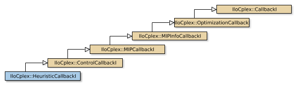

Map of IloCplex::HeuristicCallbackIIloCplex::HeuristicCallbackIIloCplex::HeuristicCallbackIIloCplex::ControlCallbackIIloCplex::MIPCallbackIIloCplex::MIPInfoCallbackIIloCplex::OptimizationCallbackIIloCplex::CallbackI
