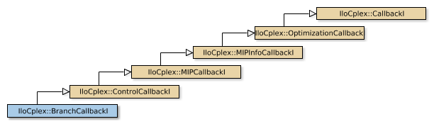

Map of IloCplex::BranchCallbackIIloCplex::BranchCallbackIIloCplex::BranchCallbackIIloCplex::ControlCallbackIIloCplex::MIPCallbackIIloCplex::MIPInfoCallbackIIloCplex::OptimizationCallbackIIloCplex::CallbackI
