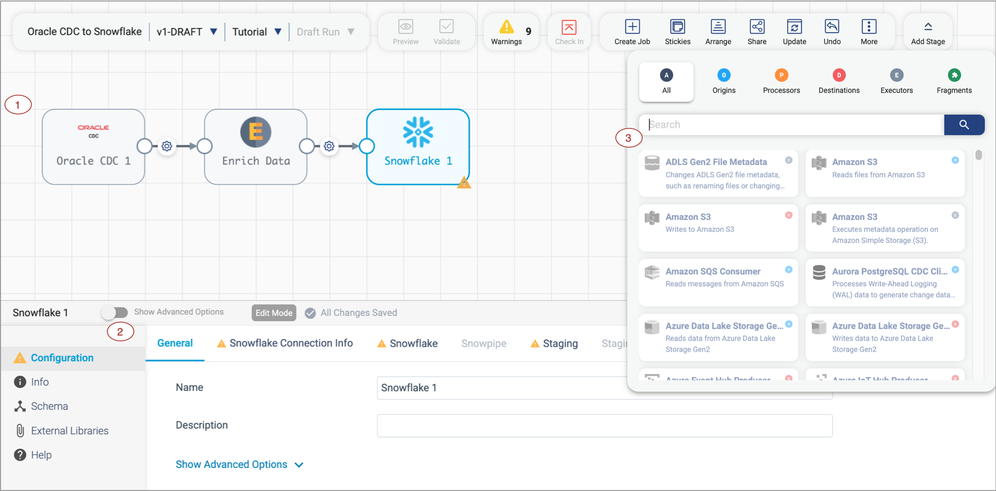

New pipeline canvas UI
The following image shows the new pipeline canvas UI when you configure a pipeline:
Area/Icon Name Description
1 Pipeline canvas Displays the pipeline. Use to configure the pipeline data flow.
2 Properties panel Displays the properties of the pipeline or selected stage when you configure a pipeline.
3 Stage selector List of available stages. Click a stage to add it to the pipeline.
You can view all stages or stages by type. You can also search for a stage by name.
Stages that are not installed appear disabled, or greyed out. Click on a disabled stage to install the stage library that includes the stage.
Pipeline name display Pipeline name display Displays the name of the pipeline in the canvas.
Pipeline version display Pipeline version display and selection Version of the pipeline in the canvas. To select a different version, click the down arrow.
Authoring engine selection Authoring engine selection Authoring engine associated with the pipeline. Displays the name of the parent deployment. To select a different authoring engine to use, click the down arrow.
Draft run selection Draft Run selection
Starts a draft run of the draft pipeline in the pipeline canvas. You can click the down arrow and then choose to start a draft run, reset the origin and then start a draft run, or specify parameter values and then start a draft run.
Preview icon Preview icon Starts data preview. Available for valid pipelines and fragments.
Validate icon Validate icon Validates the pipeline. Performs explicit validation.
Displays when the pipeline is in edit mode and passes implicit validation.
Validation Errors icon Validation Errors icon Lists the number of validation errors for implicit validation. Click to view the error messages.
Check In icon Check In icon Publishes the pipeline or fragment in the canvas.
Displays in red when the pipeline or fragment has not passed implicit validation and cannot be checked in. Displays in green when the pipeline or fragment has passed implicit validation and is ready to be checked in.
When the pipeline has already been published, the Edit icon displays in the same location.
Publish a pipeline to enable creating a job for the pipeline. Publish a fragment to enable using the fragment in a pipeline.
Edit icon Edit icon Enables editing the pipeline or fragment. Displays when the pipeline or fragment has already been published and is being viewed in read only mode.
When the pipeline or fragment is already in edit mode, the Check In icon displays in the same location.
Create Job icon Create Job icon Creates a job based on the pipeline. Creates a job for a published pipeline.
Stickies icon Stickies icon Adds a sticky note to the pipeline canvas that you can use to communicate with other users.
Arrange icon Arrange icon Automatically arranges the stages on the canvas.
Share icon Share icon Shares the pipeline or fragment with users and groups. Use to configure permissions for the pipeline or fragment.
Update icon Update icon Updates stage libraries for multiple stages in the pipeline or fragment. Use to update all necessary stage libraries at one time when you change the authoring engine for the pipeline or fragment.
Undo icon Undo icon
Reverts recent changes. On Mac, you can also use Command+Z. On Windows, you can use Ctrl+Z.
Redo icon Redo icon
Restores changes that were reverted. On Mac, you can also use Command+Shift+Z. On Windows, you can use Ctrl+Y.
History icon History icon Displays the history of the pipeline or fragment in the canvas.
Delete Draft or Delete Pipeline icon Delete Draft or Delete Pipeline icon Deletes the draft version or published version of a pipeline.
More icon More icon Provides additional pipeline actions to take.
Add Stage icon Add Stage icon Indicates that you need to add a stage to complete the pipeline.
Select the icon to open the stage selector.
Duplicate Stage icon Duplicate Stage icon Duplicates the selected stage.
Create Pipeline Fragment icon Create Pipeline Fragment icon Creates a pipeline fragment from the selected stages.
Delete icon Delete icon Deletes the selected item in the canvas.
Expand Fragments icon Expand Fragments icon Expands either all or the selected fragment stages in the pipeline, displaying all the stages in the fragments.
Collapse Fragments icon Collapse Fragments icon Collapses expanded pipeline fragments, displaying a single fragment stage for each fragment.
Stream link icon Stream link icon Indicates the flow of data through the pipeline or fragment.
Select the link to insert a stage between the connected stages or to delete the link. For Data Collector pipelines, you can also select the link to configure data rules and alerts.
Error icon Error icon Indicates that one or more required properties are not defined. Can display on a stage for stage properties or in the canvas for pipeline properties.
Related error messages display when you hover over the icon. You can also view the messages in the Validation Errors list.
The icon can also display on tabs in the properties panel to indicate the location of missing properties.
Note: Some icons and options might not display. The items that display are based on the task that you are performing and roles assigned to your user account.
For example, the Create Job icon displays only for published pipelines when you log in with the Job Operator role. Or, if you log in with only the Pipeline User role configuration-related icons are not available.

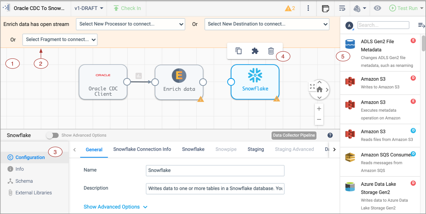

Classic pipeline canvas UI
The following image shows the classic pipeline canvas UI when you configure a pipeline:
1 Pipeline Canvas Displays the pipeline. Use to configure the pipeline data flow.
2 Pipeline Creation Help Bar Offers lists of stages to help complete the pipeline.
You can use the help bar to connect a stage to an open node. You can also add a stage between linked stages by clicking the link.
3 Properties panel Displays the properties of the pipeline or selected stage when you configure a pipeline.
4 Selected stage pop-up menu Displays the icons for commands that you can apply to the selected stages.
5 Stage library panel List of available stages. Use to add stages to the pipeline. You can drag a stage to a location on the canvas or click a stage to add it to the end of the pipeline.
You can view all stages, stages by type, or stages by library. You can also search for a stage by name.
Pipeline version display Pipeline version display and selection The version of the pipeline in the canvas. To select a different version, click the icon and select the version to view.
Check In icon Check In icon Publishes the pipeline or fragment in the canvas. Displays for pipelines only when the pipeline passes implicit validation.
Compare with Previous Version icon Compare with Previous Version icon Compares the pipeline or fragment in the canvas with a previous version.
Undo icon Undo icon
Redo icon Redo icon
Sticky Note icon Sticky Note icon Adds a sticky note to the pipeline canvas that you can use to communicate with other users.
Auto Arrange icon Auto Arrange icon Automatically arranges the stages on the canvas.
Authoring icon Authoring icon Authoring engine associated with the pipeline. You can click the icon and select a different engine to use.
Stage Library icon Stage Library icon Toggles the display of the Stage Library panel.
Stream link icon Stream link icon Indicates the flow of data through the pipeline or fragment. Select to configure data rules and alerts.
Darker icons indicate that a data rule is configured for the link.

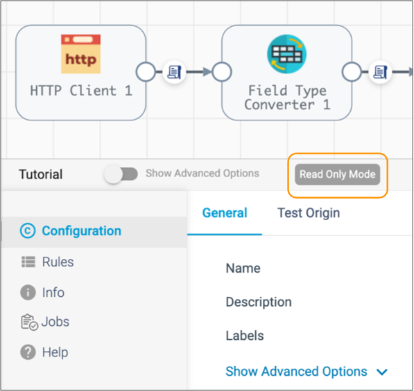

Edit a published pipeline or fragment
When viewing a published pipeline or pipeline fragment, Control Hub displays the pipeline or fragment in read-only mode.
The mode appears in the properties panel as shown:
Read-only mode displayed in properties panel
To edit a published pipeline or fragment, click the Edit icon: Edit icon. The pipeline or fragment then enters edit mode.

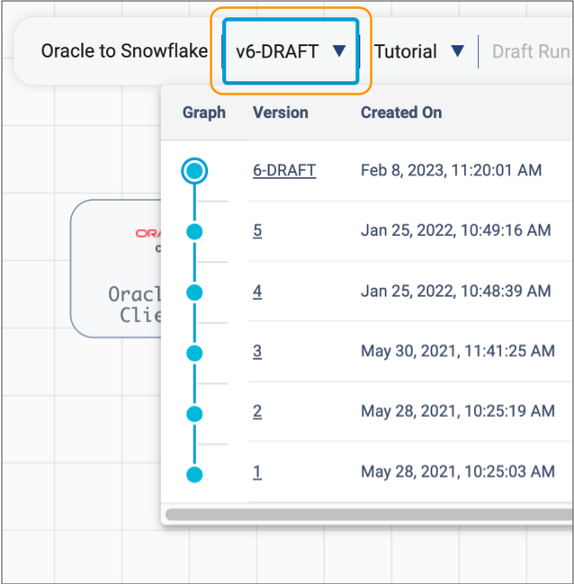

Work with versions
When you have multiple versions of a pipeline or pipeline fragment, Control Hub indicates the version of the pipeline or fragment that you are viewing. You can click the pipeline or fragment version to select a different version to view, as follows:
Pipeline or fragment version selection
For more information about working with versions, see Version history.

Use the Check In icon to publish a valid pipeline or fragment: Check In icon. Enter a commit message stating what changed in this version so that you can track the commit history of the pipeline or fragment.
After you publish a pipeline, it enters read only mode and can be used to create a job. After you publish a fragment, it enters read only mode and can be included in pipelines.
