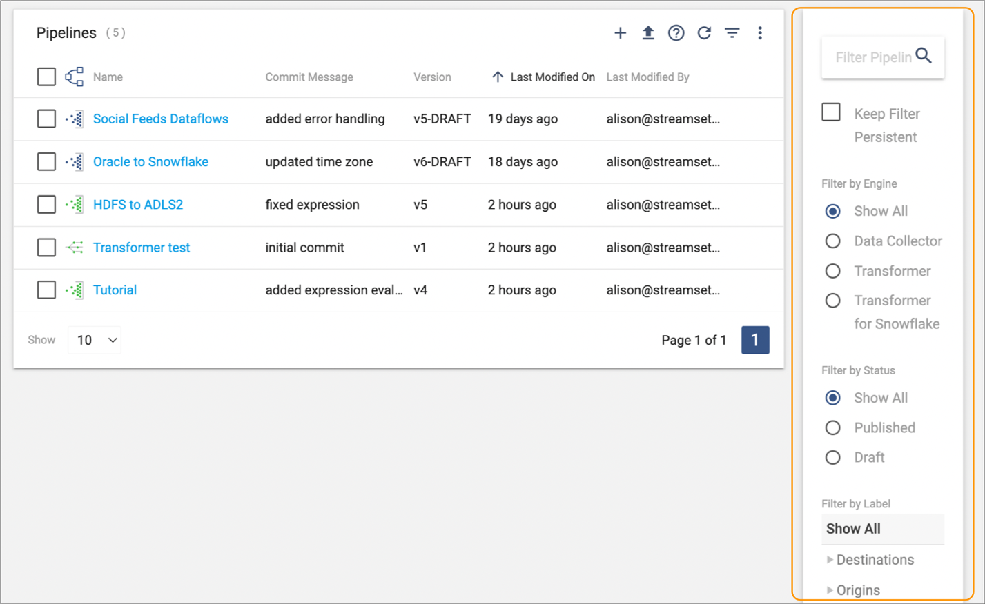

Filtering pipelines and fragments
In the Pipelines and Fragments views, you can filter the list of displayed pipelines or fragments by execution engine type, status, or label. Or you can search for pipelines or fragments by name, description, or commit message.
You can filter only published pipelines and fragments by label. You cannot filter draft pipelines and fragments by label.
Note: By default, filtering is replaced by the new search functionality. If needed, you can disable search and revert to the original filtering functionality.
  1. To filter pipelines, in the Navigation panel, click Build > Pipelines.
    To filter pipeline fragments, in the Navigation panel, click Build > Fragments.
  2. If the Filter column does not display, click the Toggle Filter Column icon: Toggle Filter Column icon.
    The following image displays the Filter column in the Pipelines view:
  3. To search for pipelines or fragments by name, description, or commit message, enter text in the search field, and then press Return.
  4. Select an execution engine type, published or draft status, or pipeline label to additionally filter the list of pipelines or fragments.
  5. Select the Keep Filter Persistent checkbox to retain the filter when you return to the view.
    Tip: To share the applied filter, copy the URL and send it to another user in your organization.

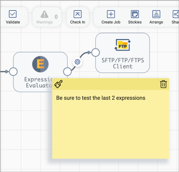

Using sticky notes
As you build a pipeline or pipeline fragment, you can add sticky notes to the pipeline canvas to include notes that might be useful to you or your team.
For example, you might add a note reminding you to test newly added expressions, as follows:
Note with a reminder to test newly added expressions
When you duplicate or export a pipeline or fragment with sticky notes, the notes are retained. However, if you add a published fragment with sticky notes to a pipeline, you cannot view the fragment notes when you expand the fragment in the pipeline. You can view fragment sticky notes only when you open the fragment in the pipeline canvas.
You can complete the following actions as you use sticky notes:
Add
To add a sticky note, select the pipeline canvas or select a stage in the canvas, and then click the Stickies icon (Stickies icon). When you add a sticky note with a stage selected, the note is added near the stage.
Click inside the note to add text to the note.
Edit
To edit the sticky note text, click inside the note and then add or remove text.
To change the sticky note color, click the Change Color icon (Change Color icon) in the note header, and then select another color.
Move
To move a sticky note, select the note header and then drag the note to another location on the canvas.
Delete
To delete a sticky note, click the Delete icon (Delete icon) in the note header.

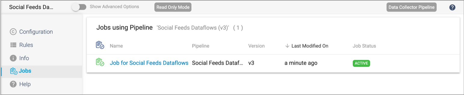

Viewing jobs that include a pipeline
When viewing a pipeline version in the pipeline canvas, you can view the complete list of job instances and job templates that include that pipeline version.
  1. In the Navigation panel, click Build > Pipelines.
  2. Click the name of a pipeline to open the pipeline in the pipeline canvas.
    By default, the latest version of the pipeline opens. To view an earlier pipeline version, click the version number next to the pipeline name in the toolbar, and then select another version, as follows:
    Viewing an earlier pipeline version
  3. In the properties panel, click the Jobs tab.
    The Jobs tab lists all job instances and job templates that include that pipeline version.
    For example, the following image shows that version 3 of the Social Feeds Dataflows pipeline is included in the job named Job for Social Feeds Dataflows:
    Version 3 of the pipeline is included in the job
