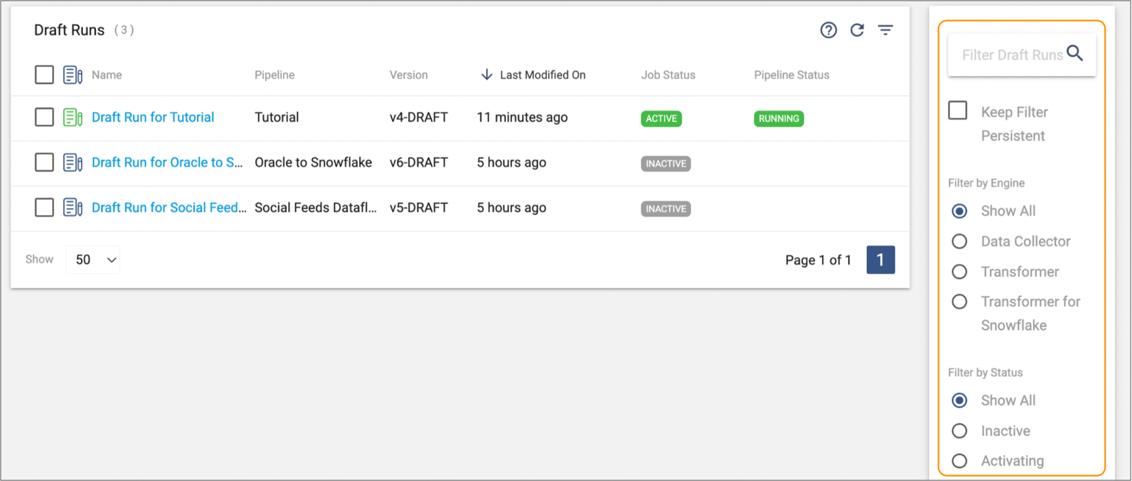

Filtering draft runs
In the Draft Runs view, you can filter the list of displayed draft runs by engine type, or by status or status color of the job automatically created for the draft run. You can also search for draft runs by name.
Note: By default, filtering is replaced by the new search functionality. If needed, you can disable search and revert to the original filtering functionality.
  1. In the Navigation panel, click Run > Draft Runs.
  2. If the Filter column does not display, click the Toggle Filter Column icon: Toggle Filter Column icon.
    The following image displays the Filter column in the Draft Runs view:
  3. To search for draft runs by name, enter text in the search field, and then press Return.
  4. Select an engine type, job status, or job status color to additionally filter the list of draft runs.
  5. Select the Keep Filter Persistent checkbox to retain the filter when you return to the view.
    Tip: To share the applied filter, copy the URL and send it to another user in your organization.
