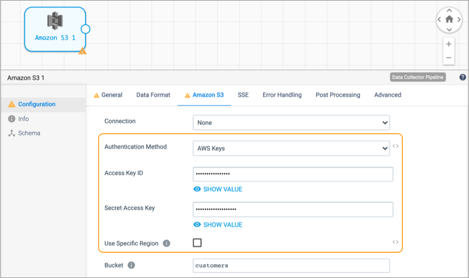

    For example, the following image displays the Amazon S3 tab for an Amazon S3 origin when no connection is selected. The tab displays the connection properties such as Authentication Method and Use Specific Region so that you can directly specify the details in the origin:

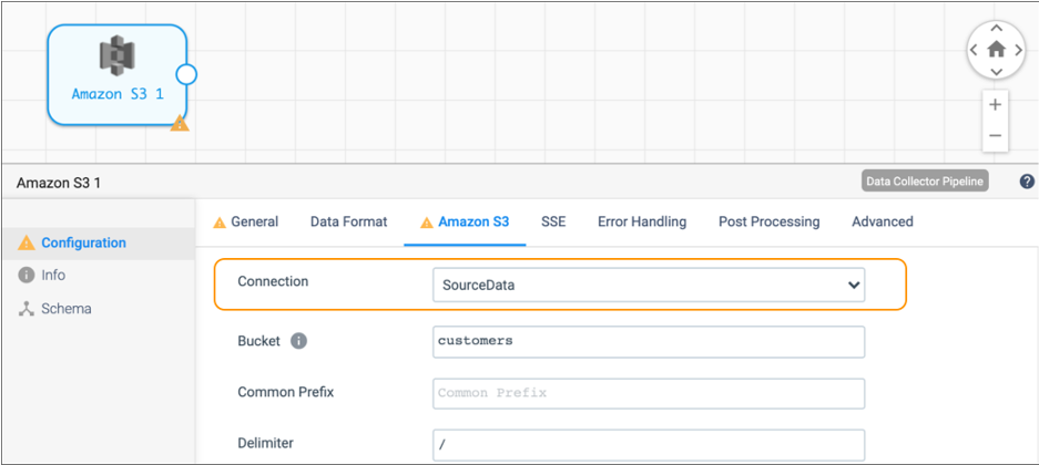

    The following image displays the same Amazon S3 tab after you select an available connection named SourceData. The tab no longer displays the connection properties. You cannot view the values of the properties defined in the SourceData connection:
    Amazon S3 tab for an Amazon S3 origin with a selected connection
