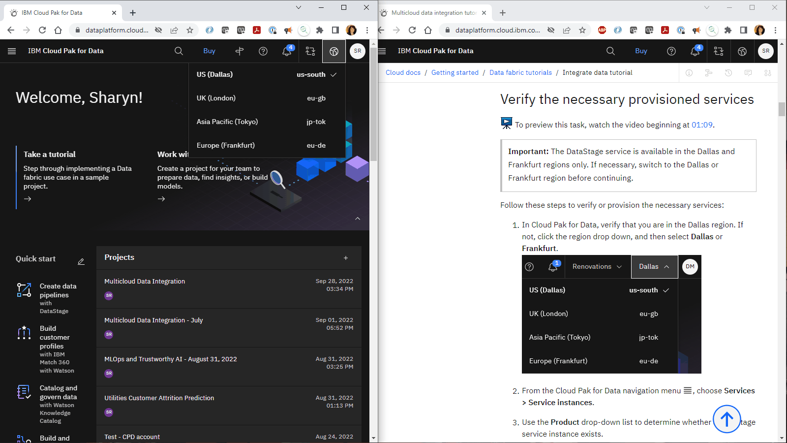

Set up your browser windows
For the optimal experience completing this tutorial, open your account in one browser window, and keep this tutorial page open in another browser window to switch easily between the two windows. Consider arranging the two browser windows side-by-side to make it easier to follow along.
Side-by-side tutorial and UI
Tip: If you encounter a guided tour while completing this tutorial in the user interface, click Maybe later.

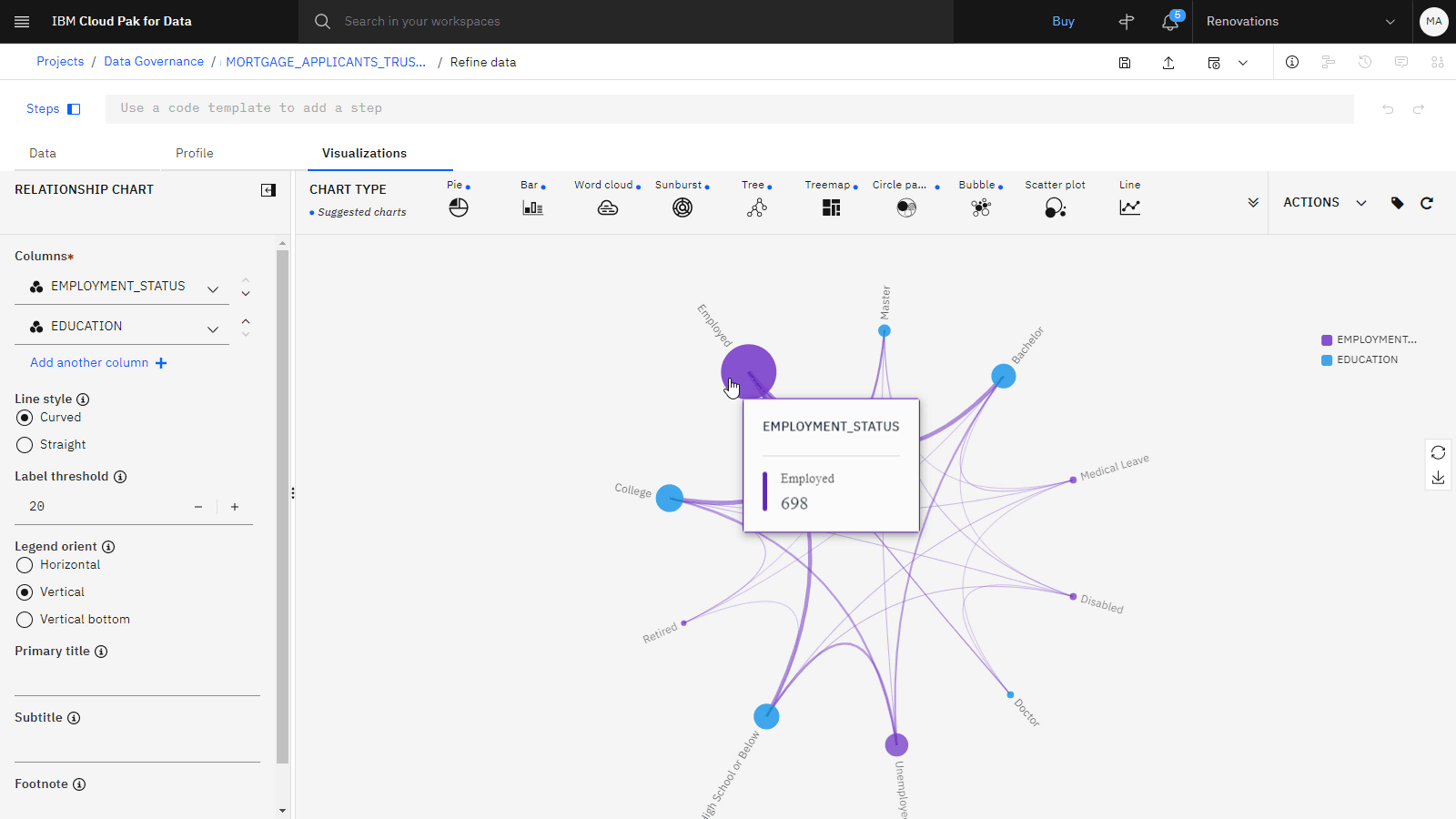

  5. Click the Visualizations tab.
  6. For the Column to visualize, select EMPLOYMENT_STATUS.
  7. Click Visualize data. The tool selects a pie chart as the best chart type for this column, which shows the distribution of applicants by employment status. Notice the suggested chart types that are indicated by a blue dot next to bar, word cloud, and sunburst.
  8. For the Chart type, select the Bubble chart type. The Bubble chart is one easy way to quickly visualize the distribution of values in a particular data set.
  9. From the Chart type drop-down, select the Relationship chart type.
  10. This chart type requires two columns. Select these columns:
    1. For the first column, select EMPLOYMENT_STATUS.
    2. Click Add another column.
    3. For the second Column, select EDUCATION.
  11. With the Relationship chart, you can select endpoints to see the relationships. For example, you can see applicants employment status by level of education.
Checkpoint icon Check your progress
The following image shows the MORTGAGE_APPLICANTS_TRUST_PROTECT asset visualized in Data Refinery. You are now ready to cleanse the data.
Relationship visualization
