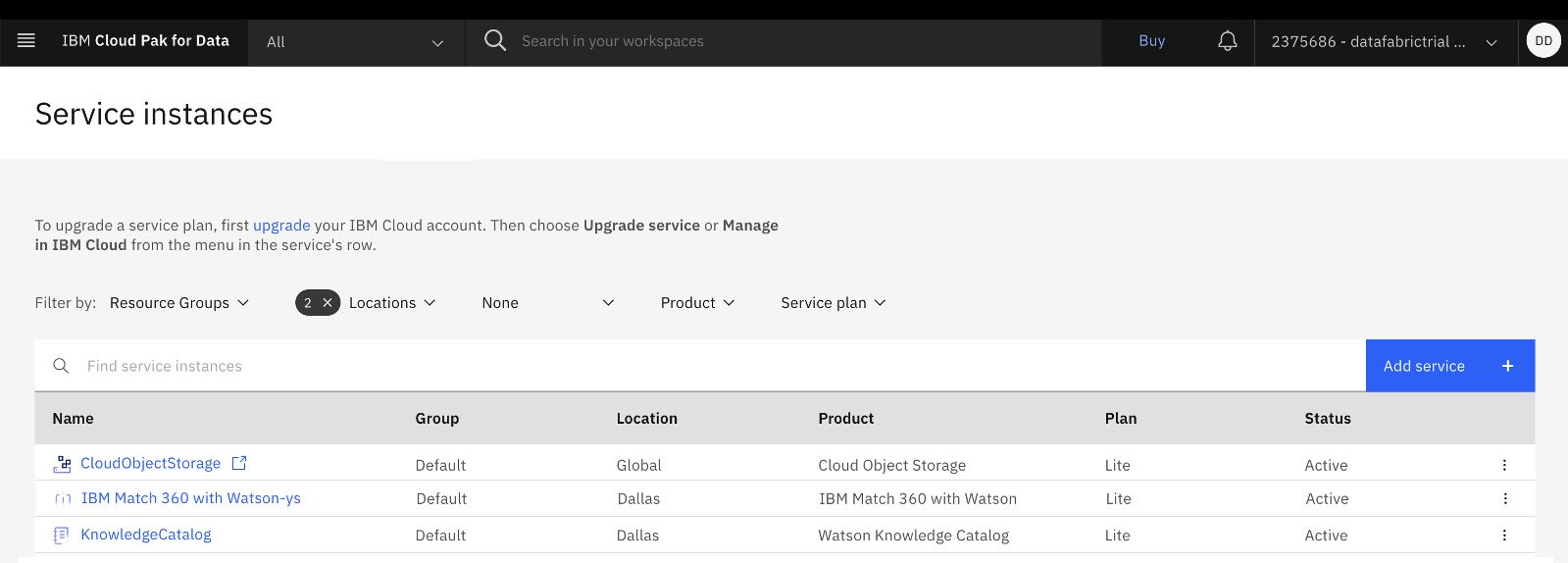

Follow these steps to verify or provision the necessary services.
  1. In Cloud Pak for Data, verify that you are in the Dallas or Toronto region. If not, click the region drop down, and then select Dallas or Toronto.
    Change region
  2. From the Navigation menu Navigation menu, choose Services > Service instances.
  3. Use the Product drop-down box to determine whether an IBM Master Data Management service instance exists.
  4. If you need to create a IBM Master Data Management service instance, click Add service.
    1. Select IBM Master Data Management.
    2. For the region, select Dallas or Toronto.
    3. Select the Lite plan.
    4. Optional: Type a name for your IBM Master Data Management service instance.
    5. Click Create.
  5. Repeat these steps to verify or provision the following services:
    • IBM watsonx.data intelligence
    • Cloud Object Storage
Checkpoint icon Check your progress
The following image shows the provisioned service instances:

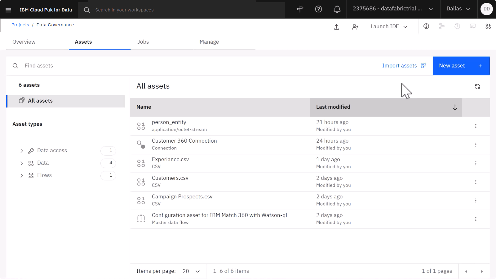

  6. Click the Assets tab to view the project's assets.
Note: You might see a guided tour showing the tutorials that are included with this use case. The links in the guided tour will open these tutorial instructions.
The following image shows the sample project. You are now ready to start the tutorial.

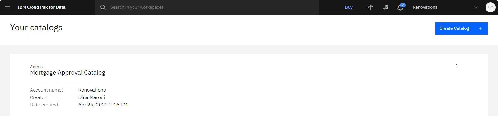

Option 2: Create a new catalog
Otherwise, follow these steps to create the catalog:
  1. On the Catalogs page, click Create Catalog.
  2. For the Name, copy and paste the catalog name exactly as shown with no leading or trailing spaces:
    Mortgage Approval Catalog
  3. Select Enforce data protection rules, confirm the selection, and accept the defaults for the other fields.
  4. Click Create to use the default settings. Your new catalog opens.

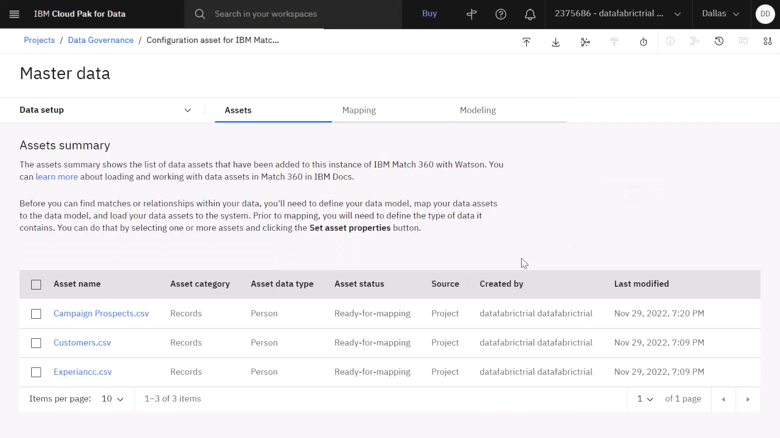

  3. Click Start with data assets.
  4. Click Add data.
  5. Insert all three of the data assets in the project:
    1. Select the Project tab.
    2. Select all three csv files, Campaign Prospects.csv, Customers.csv, and Experiancc.csv, and then click the Insert Data icon (Insert Data).
    3. Click Add data.
  6. Assign the Person record type to your data assets. Record Type provides information about the type of data that an asset contains. Each asset needs to have an assigned record type so that IBM Master Data Management can find the part of the model that best fits the data.
    1. Select the checkbox for the three assets, Campaign Prospects.csv, Customers.csv, and Experiancc.csv, and click Set asset properties.
    2. In the Select data asset type drop-down list, select the Person data asset type.
    3. Click Save.
The following image shows the assets added to master data. Now that you set up master data and added the three data assets, you are ready to begin mapping the data asset attributes.
Assets added to master data

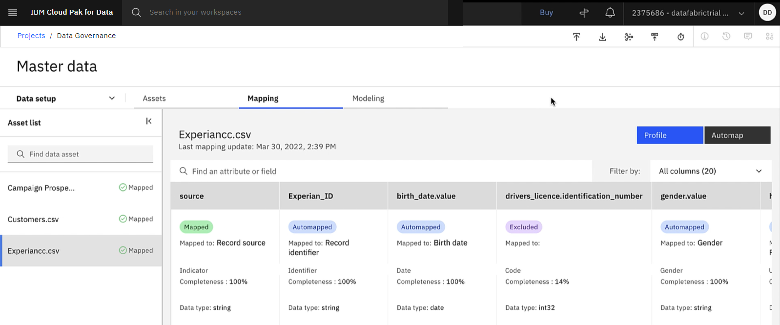

Task 3: Map the data asset attributes
preview tutorial video To preview this task, watch the video beginning at 03:22.

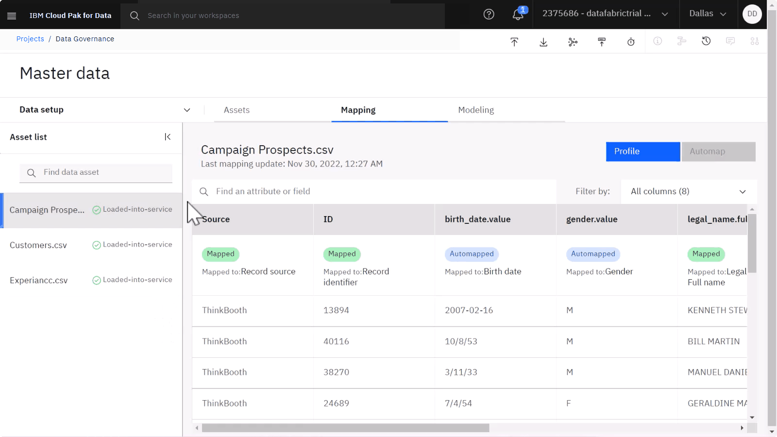

For IBM Master Data Management to match all of your data, you must specify which columns of each data set are mapped to specific attributes that are understood by IBM Master Data Management. Follow these steps to map the data asset attributes.
  1. Click the Mapping tab, and then click Got it to begin mapping the columns of your data assets to the appropriate attributes.
  2. In the Asset list panel, select Campaign Prospects.csv.
  3. In the side panel, click Profile data. Profiling your data is a prerequisite to automatically mapping columns of your data to attributes of the IBM Master Data Management data model. Profiling takes 2-5 minutes. A message displays Profiling complete when the data profiling is finished.
  4. When profiling is complete, click Automap asset to map columns of your data automatically.
  5. Refer to Table 1: Campaign Prospects.csv mapping to manually map all of the columns that have the status Not mapped or not mapped correctly according to the table. To map a column to an attribute, you can follow the example: map an existing attribute. To exclude a column, you can follow the example: exclude columns from mapping.
  6. When all of the columns in the asset have a status of either Mapped, Automapped, or Excluded, you see the option to Map next data asset.
  7. Repeat Steps 3-5 for the Customers.csv and Experiancc.csv assets. Use the respective tables to map the columns for these data assets to the IBM Master Data Management data model as suggested in Table 2: Customers.csv suggested mapping and Table 3: Experiancc.csv suggested mapping. Refer to the examples that explain how to manually map individual attributes. You can either map a column to an existing attribute or exclude columns from mapping.
Example 1: Map an existing attribute
preview tutorial video To preview this task, watch the video beginning at 04:07.
This example explains how to map the legal_name.full_name column in the Campaign Prospects.csv data asset to the existing attribute legal_name.full_name - Legal name - Full name. IBM Master Data Management provides some attributes that are commonly associated with customer records that you can choose to map the columns in your data set to.
  1. Click the column legal_name.full_name.
  2. From the Mapping targets panel, in the search field, type Legal name - Full name.
  3. Select Legal name - Full name from the list. The column displays as Mapped and Mapped to: Legal name - Full name.
You can repeat these steps to map other columns of your data assets to existing attributes that either you previously created or provided by IBM Master Data Management.
Example 2: Exclude columns from mapping
preview tutorial video To preview this task, watch the video beginning at 05:15.
This example explains how to exclude a column from the data asset mapping. You can exclude columns from the mapping if they are not useful to IBM Master Data Management during the matching process or if you do not want to include them in your matched data output.
  1. Click the column that is named Source.
  2. Toggle the checkbox Exclude column. The column displays as Excluded.
You can repeat these steps to exclude other columns of your data assets.

primary_residence.province_state Exclude this column from mapping Exclude column from mapping
primary_residence.zip_postal_code Primary residence - Postal code Map an existing attribute
Credit score Exclude this column from mapping Exclude column from mapping
CREDITCARD_NUMBER Exclude this column from mapping Exclude column from mapping
The following image shows all of the mapped data assets. Now that you mapped the attributes for all three data assets, you can publish the data model and run matching.
Master data with all assets mapped

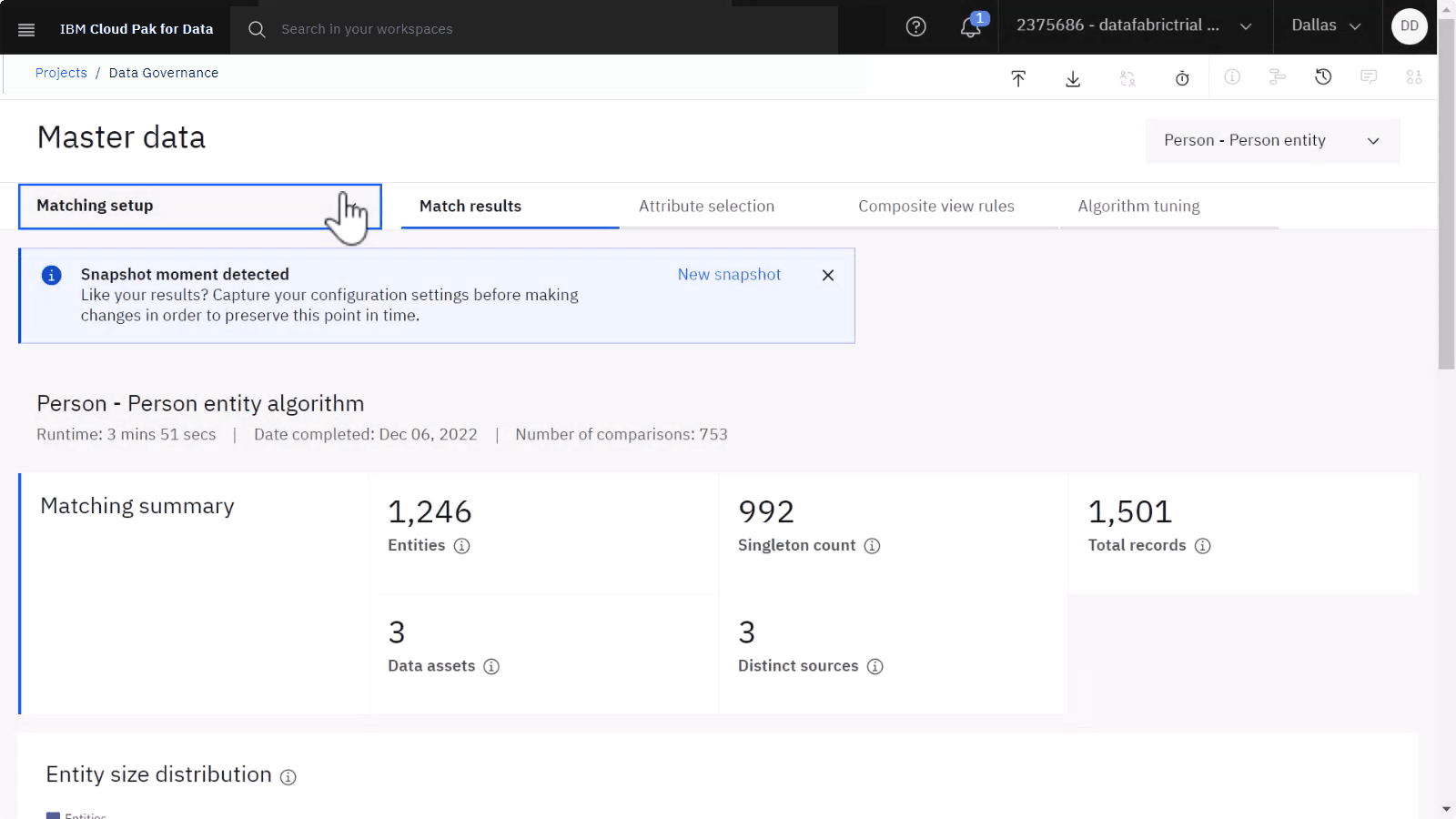

  3. Click the Matching settings tab, and then click Got it on the Attribute selection screen. Review the settings on the Attribute selection, Record selection, Algorithm tuning, and Attribute composition pages. For this tutorial, you can accept the default attributes that are already selected. Here you can choose attributes that can help distinguish records from each other like birth dates, email addresses, or phone numbers to help the matching algorithm.
  4. Click the Match results tab, and then click Run matching. You receive a notification when the matching process is complete and the matching results are displayed.
The following image shows the results after you ran matching. Now that you published the data model and ran matching, you are ready to publish the matched data to a catalog.
Match results

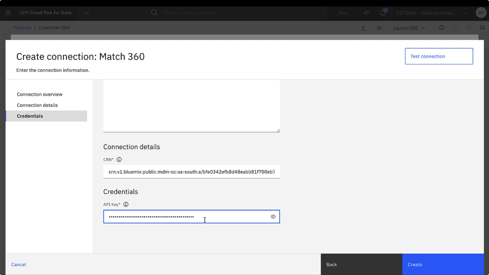

  5. Type the connection asset name, Master Data Management Connection.
  6. Retrieve the CRN of your IBM Master Data Management service instance:
    1. From the IBM Cloud console resource list page, click Analytics to expand the list of your service instances.
    2. In the Product column, click IBM Master Data Management.
    3. In the details panel that opens, click the Copy to clipboard icon for the CRN of your selected IBM Master Data Management service.
  7. In the Connection details, paste the CRN that corresponds with your IBM Master Data Management service instance.
  8. Create an IBM Master Data Management API key:
    1. From the IBM Cloud console, click Manage > Access (IAM).
    2. Click the API keys page.
    3. Click Create an IBM Cloud API key. If you have any existing API keys, the button may be labelled Create.
    4. Type a name and description.
    5. Click Create.
    6. Copy the API key.
    7. Download the API key for future use.
  9. Complete the API key field with the API key that you created.
  10. Click Create.
  11. If asked to confirm you want to create the connection without setting location and sovereignty, click Create.
The following image shows the Master Data Management connection asset. Now you can create a connected data asset from this connection.
Connection asset
Task 5b: Import connected data asset
preview tutorial video To preview this task, watch the video beginning at 8:32.
Now use the IBM Master Data Management connection to create a new connected data asset of your consolidated data from IBM Master Data Management. Follow these steps to create a connected data asset.
  1. Click Import assets.
  2. On the Import assets page, select Connected data.
  3. Select Master Data Management connection > records > person > person_entity.
  4. Click Import.
The following image shows the connected data asset. Now that you created the connected data asset for your consolidated, matched data, you can publish that asset to a catalog.
Connected data asset
Task 5c: Publish the connected data asset to your catalog
preview tutorial video To preview this task, watch the video beginning at 8:55.
Follow these steps to publish the consolidated, matched data to that catalog.
  1. In your Master Data Management project, verify that you are on the Assets tab.
  2. Click the Overflow menu Open and close list of options for your connected data asset person_entity, and choose Publish to catalog.
    1. Select the Mortgage Approval Catalog (or your catalog name) from the list, and click Next.
    2. Optionally, select the option to Go to the catalog after publishing it, and click Next.
    3. Review the assets, and click Publish.

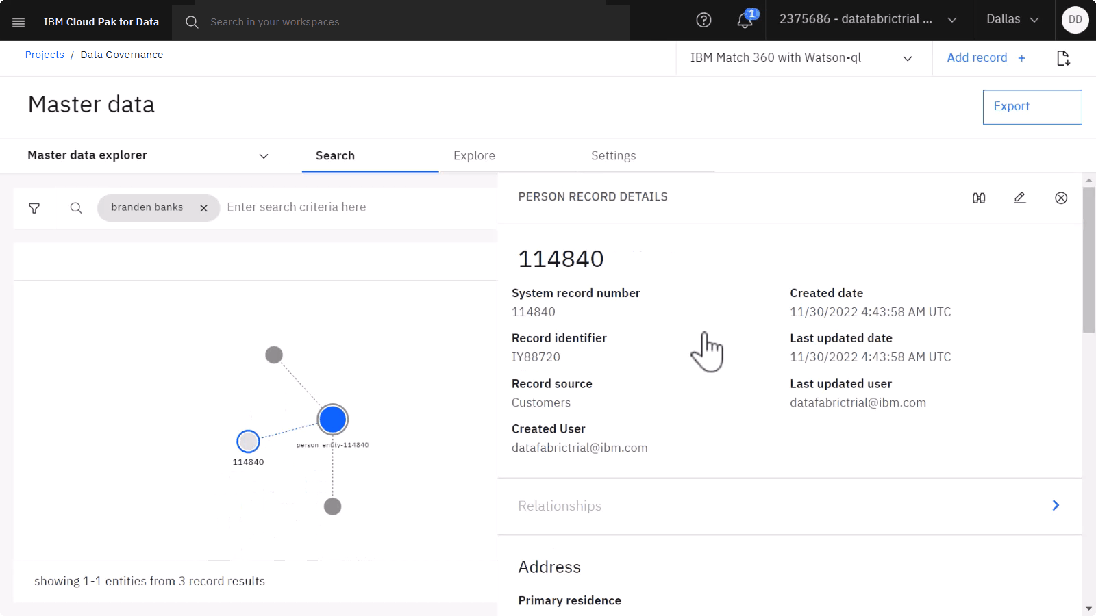

Task 6: Preview your matched data
preview tutorial video To preview this task, watch the video beginning at 09:28.
Now that you published your model or data changes to IBM Master Data Management, set your matching parameters, and run matching, you can use master data explorer to query your matched data. The master data explorer empowers you to find, view, compare, and edit matching results. Now, as a data analyst for Golden Bank, you must analyze, explore, and validate IBM Master Data Management results to identify and select the best qualifying customers to target formarketing campaign offers. Follow these steps to explore and tune your matched data.

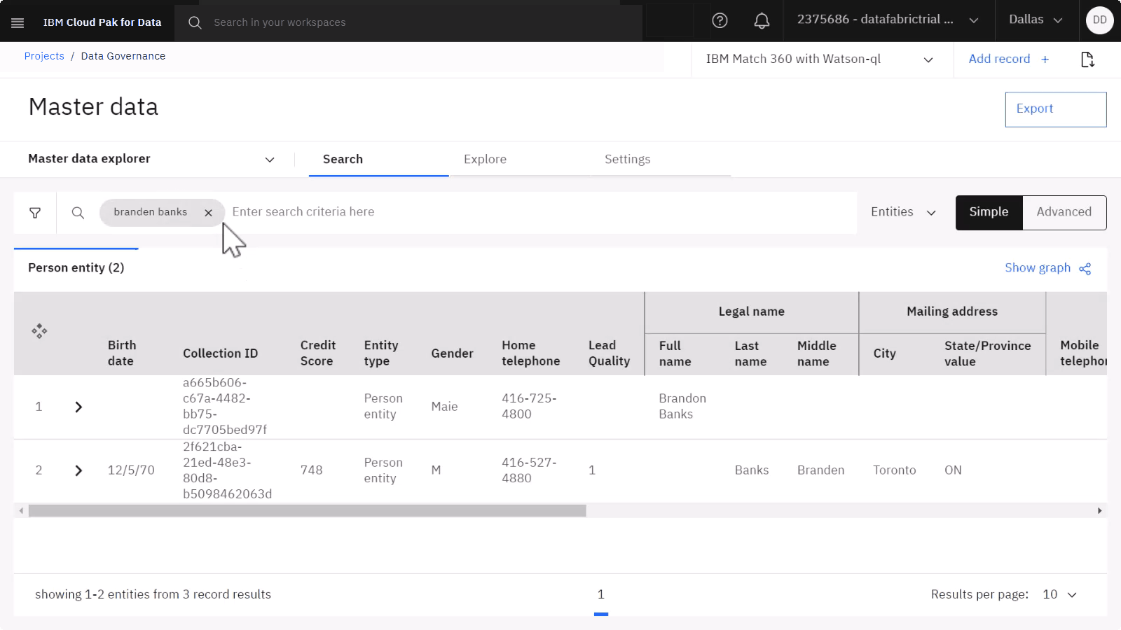

  1. From the Navigation menu Navigation menu, choose Data > Master data.
  2. From the Master Data menu Match setup, select Search Search.
  3. In the search bar, type Branden Banks, and press Enter to add Branden Banks as a search criteria. For this search query, 2 entities appear for Branden Banks. The number 2 in the first column indicates that two source records that make up this entity and the number 1 in the first column means that one source record makes up the other entity.
  4. Expand both of the entities. You can see that these separate entities for Branden Banks is likely just one person. To join these entities into a single entity, you can tune the matching algorithm.
The following image shows the search results in Master data explorer. Next, you can tune the matching algorithm and run matching again.
Explore master data

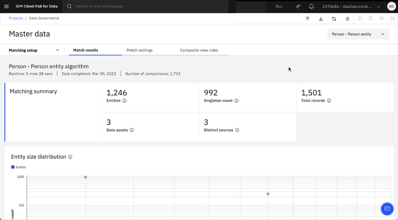

  1. From the Master Data menu Match setup, select Data types data types icon, then click Entity types.
  2. Select the Person entity type, then click the Edit icon edit icon to customize how records get matched.
  4. Click the Algorithm tuning page.
  5. Click the Match results tab, and then click Run matching. You receive a notification when the matching process is complete and the matching results are displayed.
  6. Click the Master data explorer drop-down, and select Matching setup from the menu.
  7. Click the Matching Settings tab, and then select the Algorithm tuning page.
  8. Toggle the Clerical range is enabled field.
  9. In the Clerical review threshold field, type 10. Scores below this threshold do not results in a match.
  10. In the Autolink threshold field, type 20. Reducing the threshold to 20 results in more overall matches between records across your sources. Scores between the clerical and autolink threshold generate a clerical review task.
  11. Click Apply threshold > Next > Run matching to run matching with your tuned algorithm.
  12. Click the Match results tab. The results are displayed when matching is finished.
The following image shows the results of matching setup. Next, you can view the matched data again to see how the fine tuning changed the results.
Matching setup tab

You can return to the master data explorer to see how algorithm tuning changed your match results.
  1. From the Master Data menu Match setup, select Search Search.
  2. In the search bar, type Branden Banks, and press Enter to add Branden Banks as a search criteria. The number 3 associated with the entity that is displayed means that three records make up the entity Branden Banks wheras before it was split up across separate entities.
  3. Expand the row in the first column of the entity to view the records. You can see the three records that were matched to this entity.
The following image shows the search results in Master data explorer. Next, you can gain insight by visualizing the matching results.
Explore master data
Task 9: Visualize records of entities
preview tutorial video To preview this task, watch the video beginning at 11:11.
You can also visualize your tuned matching results as nodes to gain insights.
  1. Click Show graph to see which records are contributing to queried entities.
  2. Click any of the nodes that are connected to the person entity to view the details associated with it. From here, you can visualize and manually modify which records are associated which each entity from your query to make corrections as needed.
The following image shows the search results as a graph.
Explore graph
