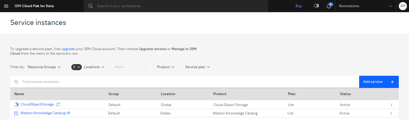

Verify the necessary provisioned services
preview tutorial video To preview this task, watch the video beginning at 01:05.
Follow these steps to verify or provision the necessary services:
  1. From the Navigation Menu Navigation menu, choose Services > Service instances.
  2. Use the Product drop-down list to determine whether a IBM watsonx.data intelligence service instance exists.
  3. If you need to create a IBM watsonx.data intelligence service instance, click Add service.
    1. Select IBM watsonx.data intelligence.
    2. Select the Lite plan.
    3. Click Create.
  4. Repeat these steps to verify or provision the Cloud Object Storage service.
Checkpoint icon Check your progress
The following image shows the provisioned service instances:
Provisioned services

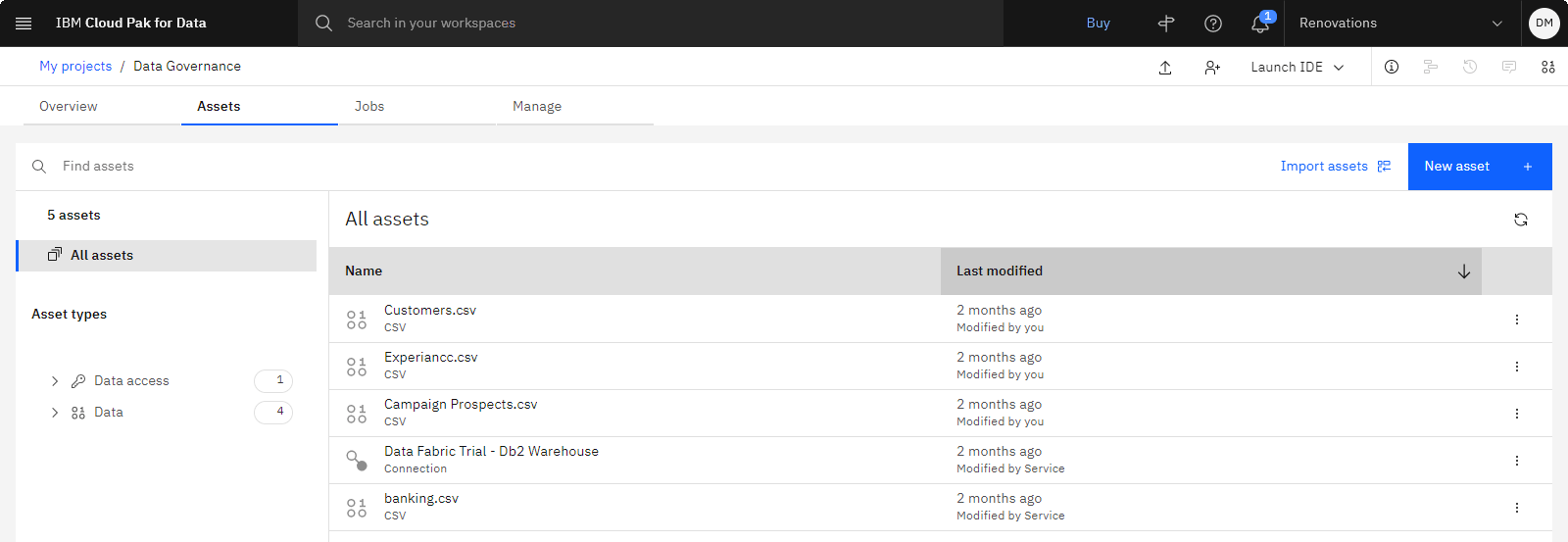

Create the sample project
preview tutorial video To preview this task, watch the video beginning at 01:38.
If you did not already create the sample project for this tutorial, follow these steps:
  1. Access the Data governance sample project in the Resource hub.
  2. Click Create project.
  3. If prompted to associate the project to a Cloud Object Storage instance, select a Cloud Object Storage instance from the list.
  4. Click Create.
  5. Wait for the project import to complete, and then click View new project to verify that the project and assets were created successfully.
  6. Click the Assets tab to view the project's assets.
  7. From the Overflow menu Overflow menu at the end of the Banking.csv data asset row, choose Download, and save it to your computer. You'll use that file in a later step.
Note: You might see a guided tour showing the tutorials that are included with this use case. The links in the guided tour will open these tutorial instructions.
The following image shows the Assets tab in the sample project. You are now ready to start the tutorial.
Sample project

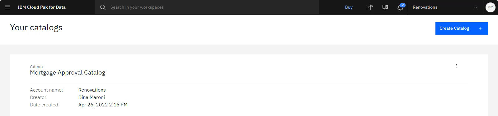

Task 1: Create a catalog
preview tutorial video To preview this task, watch the video beginning at 02:49.
Before you start working with data, create a catalog where you will publish data to share it with your organization. With the IBM watsonx.data intelligence Lite plan, you can create only two catalogs. If you already have a catalog, you can skip this step. Otherwise, follow these steps to create a catalog:
Tip: If this occasion is your first time accessing a catalog, you see a guided tour asking if you want to tour of catalogs. For now, click Maybe later.
  1. From the Navigation Menu Navigation menu, choose Catalogs > View all catalogs.
  2. If you see a catalog on the Catalogs page, then skip to Task 2: Create a category. Otherwise, follow these steps to create a new catalog:
  3. Click Create Catalog.
  4. For the Name, copy and paste the catalog name exactly as shown with no leading or trailing spaces:
    Mortgage Approval Catalog
  5. Select Enforce data protection rules, confirm the selection, and accept the defaults for the other fields.
  6. Click Create.
The following image shows your catalog. You are now ready to share assets with your organization.

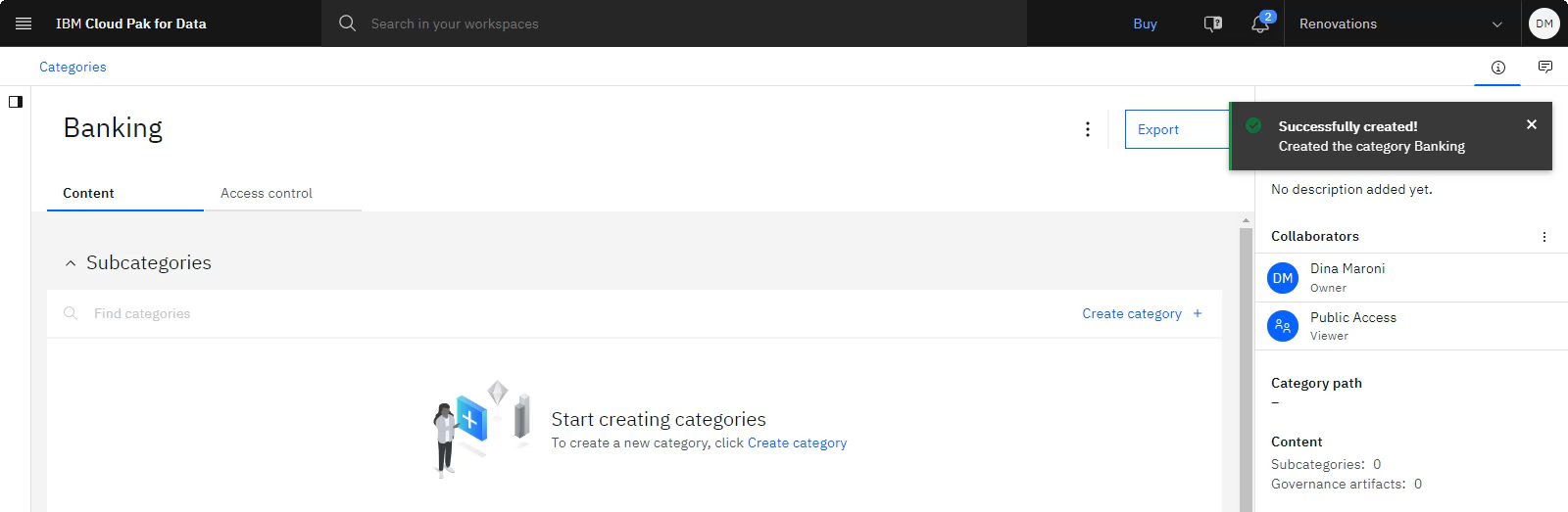

preview tutorial video To preview this task, watch the video beginning at 03:13.
You need a category to contain the business terms that you’ll import in the next Task. Categories act like folders to organize your governance artifacts and the people who can author and manage those artifacts. Follow these steps to create a category:
  1. From the Cloud Pak for Data navigation menu Navigation menu, choose Governance > Categories.
  2. Click Add category > New category.
  3. For the name, type Banking.
  4. Click Create.
The following image shows the Banking category. You are now ready to import business terms.
Banking category

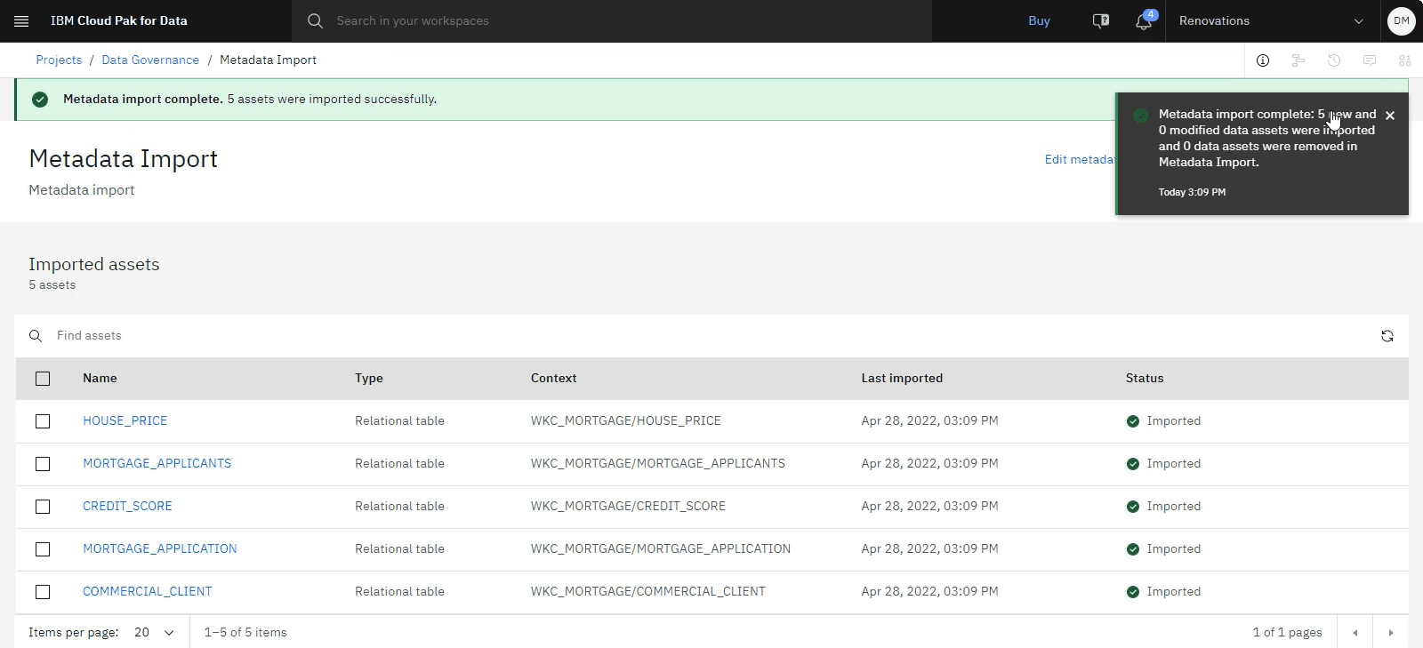

Task 4: Import data to a project
preview tutorial video To preview this task, watch the video beginning at 04:47.
The sample project includes a connection to a Db2 Warehouse instance, which contains the mortgage assets. You can import technical metadata that is associated with the data assets into a project or a catalog to inventory, evaluate, and catalog these assets. Technical metadata describes the structure of data objects.
Follow these steps to import the data assets:
  1. From the Navigation Menu Navigation menu, choose Projects > View all projects.
  2. Click the Data governance project.
  3. Click the Assets tab.
  4. Click New asset > Import metadata for data assets.
  5. For the name, copy and paste the following text:
    Mortgage data - metadata import
  6. Click Next to continue.
  7. On the Define goals page, follow these steps:
    1. Select Import asset metadata to import and view assets of various types in a project or catalog.
    2. For the Target, select Add to this project.
    3. Click Next to continue.
  8. On the Select source and scope page, follow these steps:
    1. Next to Connection, click Select.
    2. Select the Data Fabric Trial - Db2 Warehouse connection, and click Select.
    3. Next to Scope, click Select > Select assets.
    4. Select the WKC_MORTGAGE schema.
    5. Select the following tables:
      • COMMERCIAL_CLIENT
      • CREDIT_SCORE
      • HOUSE_PRICE
      • MORTGAGE_APPLICANTS
      • MORTGAGE_APPLICATION
    6. Review the list of assets in the side panel, and then click Select.
  9. Click Next to continue to the Define job details page. You can manually run the metadata import, so keep the scheduled turned off.
  10. Click Next to continue to the Set advanced Options page.
  11. Accept the default values for on the Advanced options page, and click Next to continue to the review.
  12. Review the summary of the import, and click Create. The metadata import job starts.
  13. Click the Refresh icon Refresh to watch the status change from Queued to In progress to Imported. When the job run is complete, you see the five assets listed.
The following image shows the completed metadata import. Your next task is to enrich the imported data assets with the imported business terms.
Metadata import asset

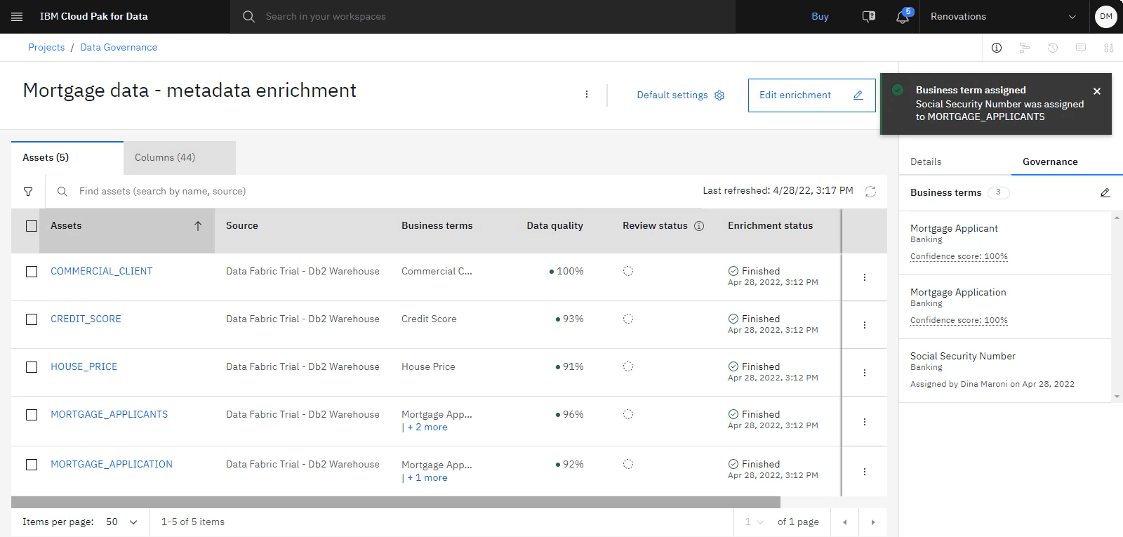

After Metadata enrichment run is completed, follow these steps to view the enriched data:
  1. From the Mortgage data - metadata enrichment screen, click the Columns tab.
  2. In the list of Columns, locate the EMAIL_ADDRESS column for the MORTGAGE_APPLICANTS asset.
    1. At the end of the EMAIL_ADDRESS for MORTGAGE_APPLICANTS row, click the Overflow menu Overflow menu, and choose View column details.
    2. In the side panel on the Details tab, you see profiling information such as: Format, Frequency distribution, Statistics.
    3. In the side panel, click the Governance tab. This tab includes the data classes and business terms that were auto-assigned during the metadata enrichment. You might also see suggested business terms and data classes, and manually assign them.
    4. Review any suggested business terms or data classes and manually assign them. For example, you may see Address as a suggested business term.
      1. Click Suggested business terms.
      2. For Address, click Assign.
  3. At the end of the EMAIL_ADDRESS column for the MORTGAGE_APPLICANTS asset row, click the Overflow menu Overflow menu, and choose View data quality details.
    1. View the data quality information. IBM watsonx.data intelligence automatically generates a data quality score for each column and data asset by analyzing every value in every record according to pre-built dimensions.
    2. Click the X to close the Data quality window.
  4. For the CITY column for the CREDIT_SCORE asset, click the Overflow menu Overflow menu, and choose Mark as reviewed.
  5. Click the Assets tab.
  6. In the list of Assets, for the MORTGAGE_APPLICANTS asset, click the Overflow menu Overflow menu, and choose View asset details.
    1. In the side panel, click the Governance tab to see business term auto assignment.
    2. Click the Edit icon Edit to manually assign business terms.
    3. Search for social. If you don't see any results, then make sure that the drop-down list is set to All terms instead of Suggested terms.
    4. Select Social Security Number.
    5. Click Assign.
The following image shows the reviewed and enriched data assets. The next step is to publish the enriched data to a catalog to share with your organization.
Reviewed enriched data assets

  1. Click the Data governance project name in the navigation trail.
  2. Click the Assets tab.
  3. Select Data > Data assets.
  4. Select the COMMERCIAL_CLIENT, HOUSE_PRICE, MORTGAGE_APPLICANTS, and MORTGAGE_APPLICATION data assets from the list, and click Publish to catalog.
    1. For the Target catalog, select Mortgage Approval Catalog, and click Next.
    2. For the Tags, type the tag, trusted, and click + (plus sign), and then click Next.
    3. Review the assets, and click Publish.

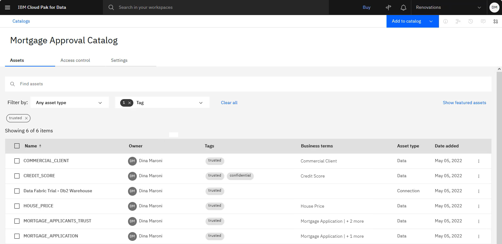

  5. Clear all checked assets, then select the checkbox next to the CREDIT_SCORE asset from the list, and click Publish to catalog.
    2. For the Tags, type the tag confidential, and click + (plus sign).
    3. Type the tag trusted, and click + (plus sign) to a second tag.
    4. Select the option to Go to the catalog after publishing it, and click Next.
    5. Review the assets, and click Publish.
  6. Filter the assets In the Mortgage Approval Catalog.
    1. Click the Filter icon Filter.
    2. Expand the Tag section.
    3. Select trusted, and click Apply.
    4. Verify that the five data assets were added to the catalog.
  7. Change the name for the MORTGAGE_APPLICANTS data asset.
    1. Open the MORTGAGE_APPLICANTS asset.
    2. Click the Edit name icon Edit name.
    3. Change the name to:
      MORTGAGE_APPLICANTS_TRUST
    4. Click Apply.
The following image shows the enriched data assets published to a catalog. Now you have trusted data available through your company's catalog.
Published assets to the catalog
