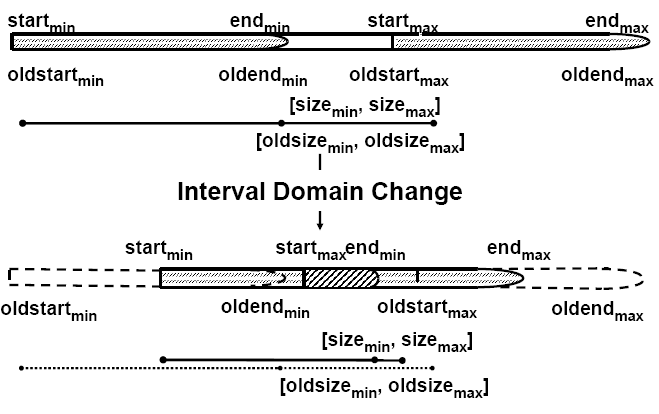

Figure 1 shows the domain-deltas for the change in the interval integer ranges start, end, length, and size from the last processing of the variable; for example the old domain is [oldstart_{min}, oldstart_{max}]) and the current domain is [start_{min}, start_{max}] which is included in the unchanged range [oldstart_{min}, oldstart_{max}]).
Figure 1: Interval Variables Anytime Delta Domain Interval Domain Change Event

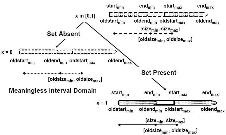

processed by the optimizer engine. Figure 2 shows the domain-delta of a change in the presence of an interval variable. Note that if the presence
status is set to absent, the domain range of start, end, length and size are no longer displayed.
Figure 2: Interval Variables, Anytime Delta Domain Presence Fixing Event

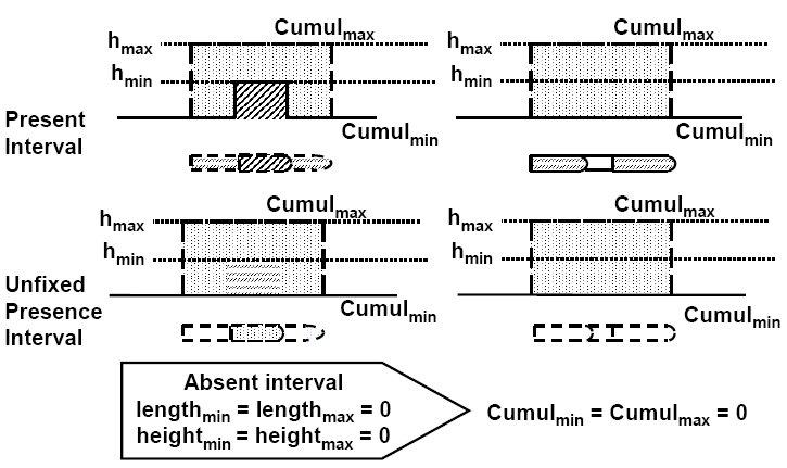

Figure 3 shows the domain of the cumul function for a pulse shaped element with present and non-absent intervals. Two cases appear, if the maximum start point of the interval is strictly less than the minimum end point of the interval (left side of the figure), the minimum cumul function is at least the minimum of the height if the interval is present. Otherwise, there is no abscissa point where the function is surely not null at this point.
Figure 3: Pulse Cumul Element Domain

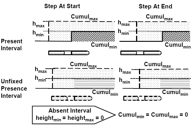

Figure 4 shows the domain of the cumul function for step at start and step at end shaped elements with present and non-absent intervals. For a present interval and a nonzero minimum height, the function is nonzero everywhere after its starting point.
Figure 4: Step Cumul Element Domain

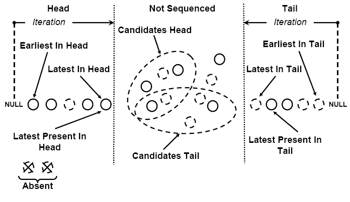

Figure 5: Interval Sequence Variable Head-Tail Graph Domain
The sequence is sequenced when any non-absent interval is in the tail or in the head. The sequence is fixed when it is sequenced and
any interval in the tail or in the head is present in the sequence. Note that if the Head-Tail Graph is not sequenced, there
is at least one candidate head interval and one candidate tail interval. The sequence solution is given by joining the

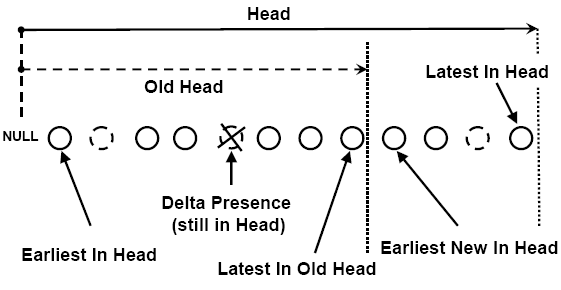

Figure 6 shows the changes that can affect the head subsequence of the Head-Tail graph. Tail subsequence changes are similar.
Figure 6: Interval Sequence Variable Head-Tail Graph Head Changes
