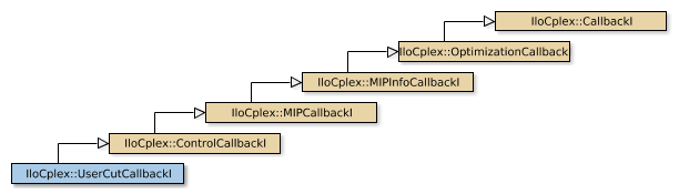

Class IloCplex::UserCutCallbackI
Definition file: ilcplex/ilocplexi.h
Map of IloCplex::UserCutCallbackIIloCplex::UserCutCallbackIIloCplex::UserCutCallbackIIloCplex::ControlCallbackIIloCplex::MIPCallbackIIloCplex::MIPInfoCallbackIIloCplex::OptimizationCallbackIIloCplex::CallbackI
