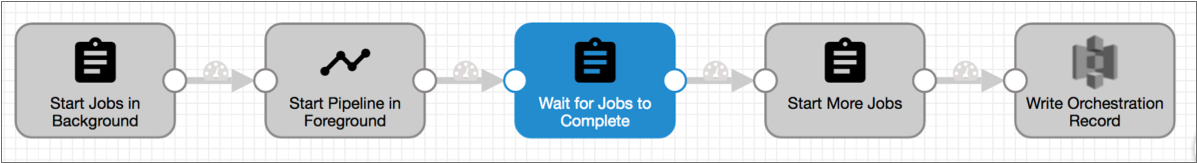

In contrast, say you want three jobs and a pipeline to start when you start your orchestration pipeline. You also want them all to complete before starting an additional set of jobs. To do this, you create the following pipeline:
Sample pipeline that starts jobs, waits for those jobs to complete, then starts more jobs
You configure a Start Jobs origin to start the three jobs in the background, which passes an orchestration record to a Start Pipelines processor as soon as the jobs start. This enables the jobs and the pipeline to run concurrently.
You configure the Start Pipelines processor to run its pipeline in the foreground, so the processor passes the updated orchestration record downstream only after the pipeline completes. That takes care of the pipeline, but the jobs may still be running. To ensure that the jobs complete before starting the next set of jobs, you add the Wait for Jobs processor.
When the processor receives the orchestration record from the Start Pipelines processor, it notes the IDs of the jobs that were started by the Start Jobs origin, and waits for them to complete. After all of the jobs complete, the Wait for Jobs processor updates job status information in the orchestration record and passes the record to the Start Jobs processor, which starts the additional set of jobs.

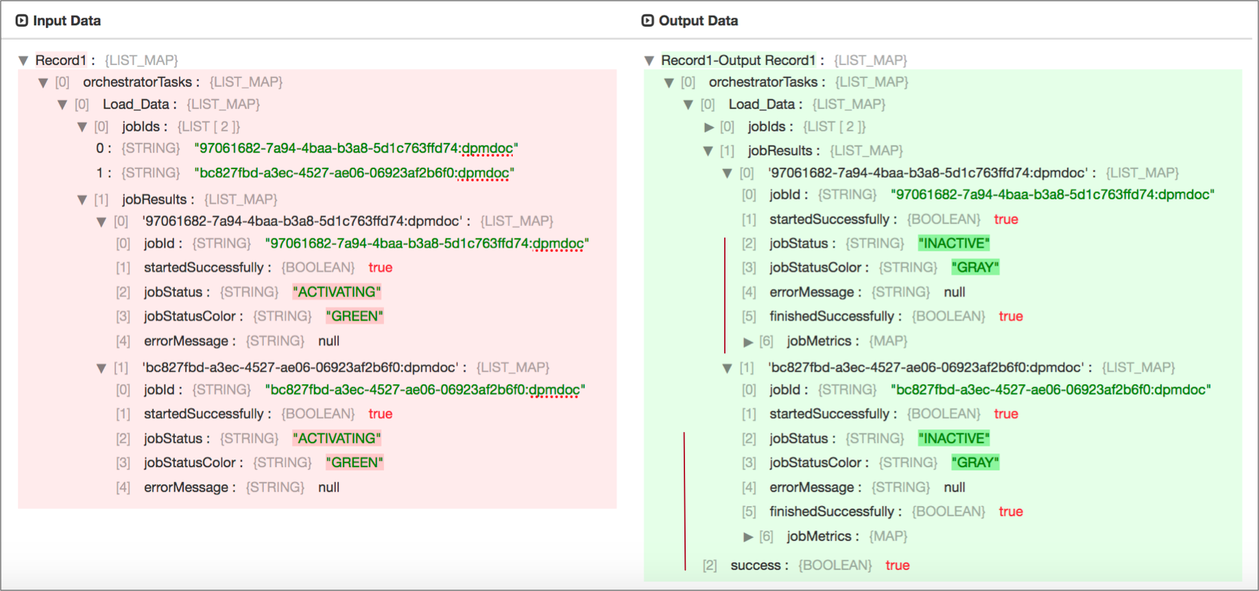

For example, the following preview shows the fields that a Wait for Jobs processor adds and updates in comparison to the incoming record:
Preview showing the fields that a Wait for Jobs processor adds and updates
Notice how the processor updated the jobStatus and jobStatusColor fields, and added the finishedSuccessfully, jobMetrics, and success fields. All of the changes indicate that the job completed successfully.
