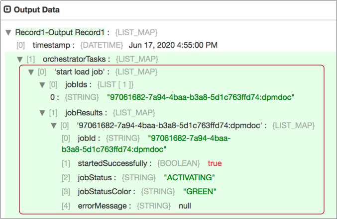

For example, the following preview shows information provided by a Start Jobs processor with the start load job task name:
Information provided by a Start Jobs processor
Note that the job status and colors indicate that the jobs are running at the time that the processor creates the record. There is no finishedSuccessfully field because the jobs have not yet completed.
