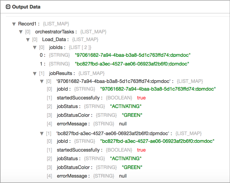

For example, the following preview shows information provided by a Start Jobs origin with the Load_Data task name. The origin runs two jobs in the background:
Preview showing information provided by a Start Jobs origin
Note that the job status and colors indicate that the jobs are running at the time that the origin creates the record. There is no success field because the jobs have not yet completed.
