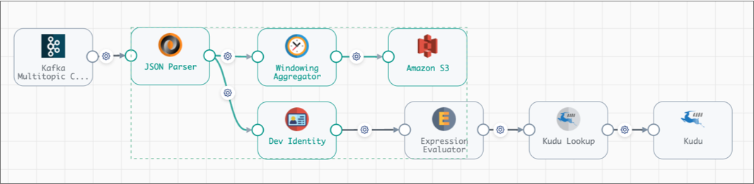

Create a pipeline fragment from one or more pipeline stages when you want to reuse a portion of the logic from an existing pipeline.
To create a fragment from pipeline stages, select one or more stages in the pipeline canvas. In the details pane, click Create Pipeline Fragment, or in the pop-up menu, click the Create Pipeline Fragment icon: Create Pipeline Fragment icon.
Tip: To select multiple stages in the canvas, press the Shift key and then click each stage. You can select connected or unconnected stages.

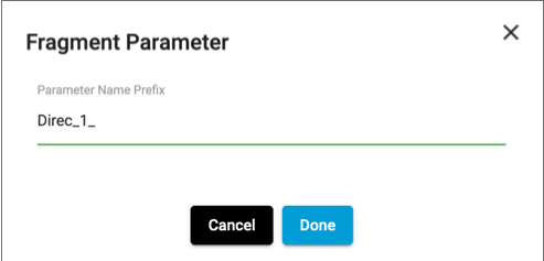

  3. Specify a prefix for the names of runtime parameters in the fragment as needed, and then click Done.
    For more information, see Prefix for runtime parameters.

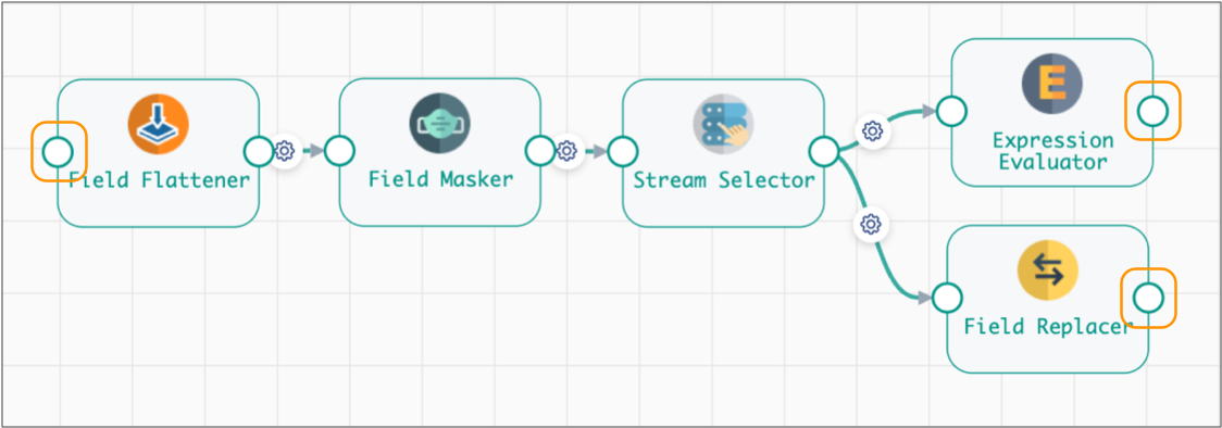

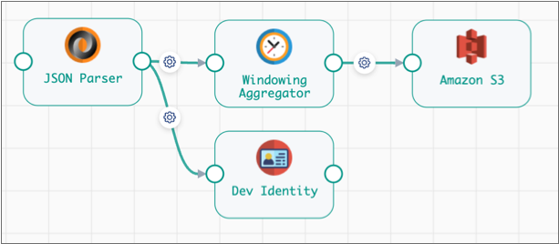

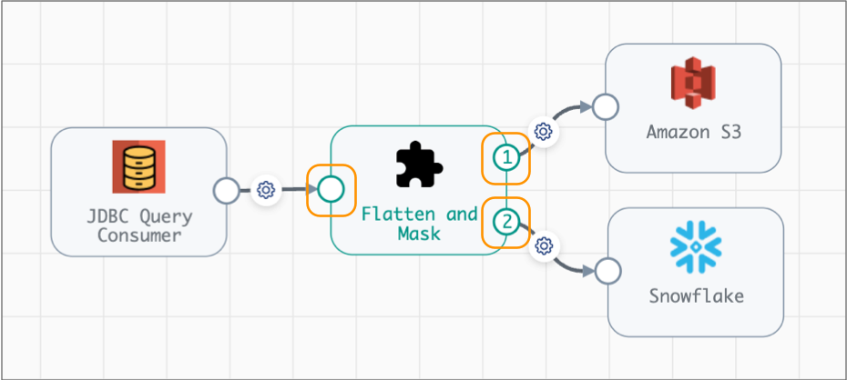

Fragment input and output
A published pipeline fragment displays in a pipeline as a fragment stage, with the input and output streams of the fragment stage representing the input and output streams of the fragment logic.
A fragment must include at least one open input or output stream. You cannot use a complete pipeline as a fragment.
When designing a pipeline fragment, consider carefully the number of input and output streams that you want to use. After you publish a fragment, you cannot change the number of input or output streams. This helps ensure that pipelines that use the fragment are not invalidated when you update the fragment.
You can, however, change what the input and output streams represent. For example, the following Flatten and Mask fragment begins with one processor and ends with two processors. The input and output streams are highlighted in the following image:

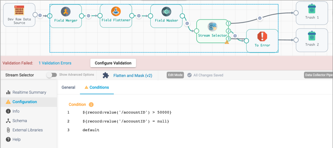

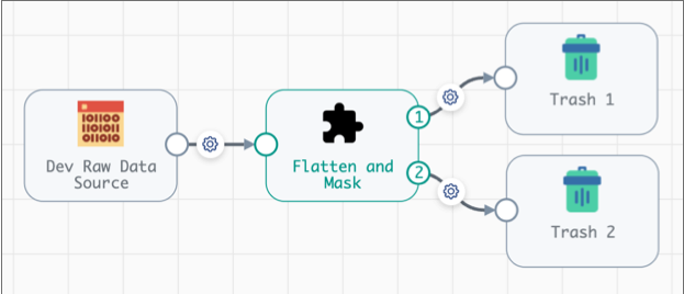

Sample fragment that begins with one processor and ends with two processors
When you configure a pipeline, the Flatten and Mask fragment displays as a single fragment stage by default. The highlighted input and output streams of the Flatten and Mask fragment stage, represent the input and output streams of the fragment logic:
Fragment displayed as a single fragment stage within a pipeline

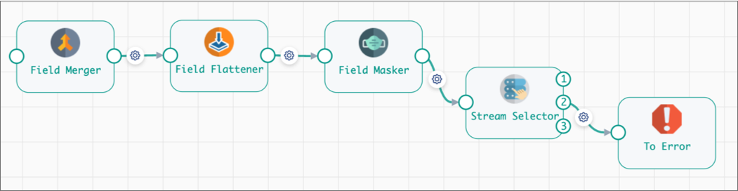

Subsequent versions of the Flatten and Mask fragment can change dramatically if needed, but must still include one input stream and two output streams.

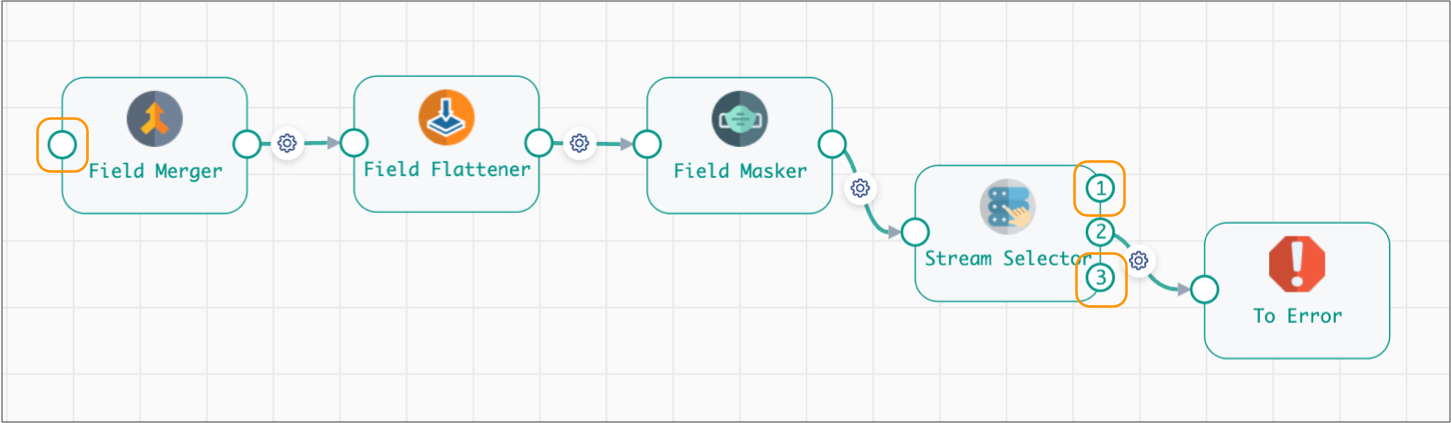

For example, the following Flatten and Mask version begins with a new Field Merger processor, and the processors after the Stream Selector have been removed. The Stream Selector also has an additional output stream that sends qualifying records to the pipeline for error handling. But despite these changes, the number of input and output streams remains the same, so these changes are valid:
Edited fragment that begins with one processor and ends with two processors

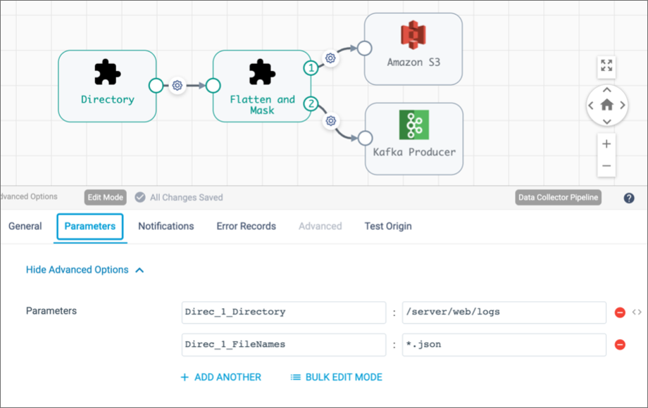

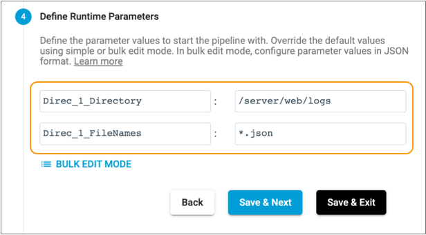

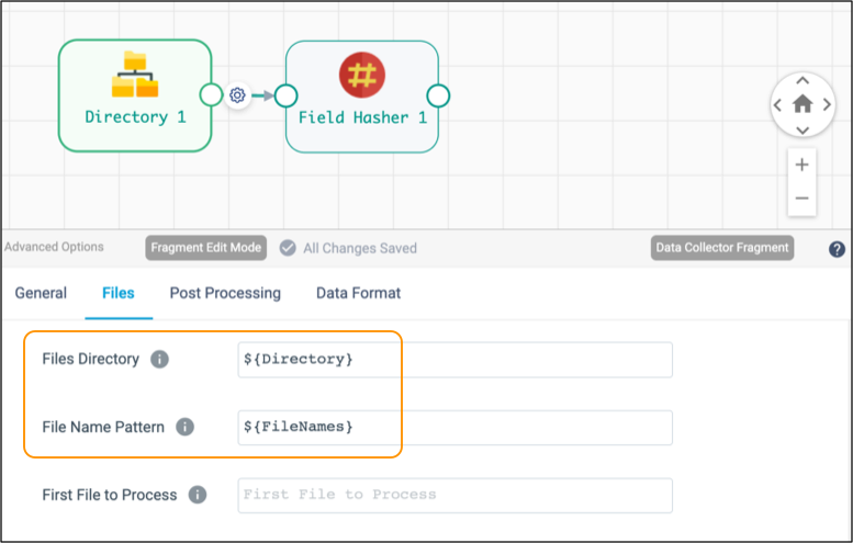

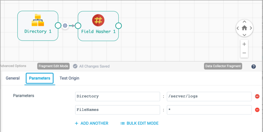

Runtime parameters
You can configure runtime parameters in pipeline fragments to enable more flexible use of the fragment.
Runtime parameters store values for configuration properties. After configuring a property to use a runtime parameter, you can change the configuration by changing the value of the runtime parameter. By using runtime parameters in pipeline fragments, you can reuse the fragment with different configurations. In fragments, you can define runtime parameters and values as follows:
  • In a fragment - You define and call runtime parameters and set their default values.
  • In a pipeline - You can override the default values for any runtime parameters defined in an included fragment.
  • In a job - You can override the values for any runtime parameter defined in the pipeline.
For example, you might create a fragment with a Directory origin that calls the runtime parameter FilePath to retrieve the directory to read. In the fragment, you set a default value for the FilePath parameter. In the pipeline, you can set a different value for the directory, such as one directory for a development pipeline and a different directory for a production pipeline. In jobs that include the pipeline, you can set yet another value for the directory, such as one directory for the European file server and a different directory for the Asian file server.
When adding a fragment to a pipeline, you can specify a prefix for the names of runtime parameters in the fragment. The prefix applies to any runtime parameters in the fragment, including those added later during a fragment update.
Parameter name prefixes are important when you reuse the same fragment in a pipeline. The prefix determines whether the values of runtime parameters are the same or different in each fragment instance:
  • Same values for runtime parameters - To use the same values for the runtime parameters in each fragment instance, enter the same prefix or remove the prefix for those fragment instances.
  • Different values for runtime parameters - To use different values for the runtime parameters in each fragment instance, enter a unique prefix for those fragment instances.
For example, let's say that you create a fragment with a Local FS destination that calls the runtime parameter DirTemplate to define the directory to write to. You add two instances of the fragment to the same pipeline, defining a unique parameter name prefix so that the first fragment instance names the parameter Local_01_DirTemplate and the second names the parameter Local_02_DirTemplate. You can then define a different parameter value for each fragment instance so that each instance writes to a different directory. Otherwise, if you remove the prefix for each fragment instance, then both instances use a parameter named DirTemplate with the same value.
When adding a fragment, the pipeline inherits all the runtime parameters in the fragment with their default values and adds the prefix to the names of the runtime parameters. You can override the default value for a runtime parameter in the pipeline properties. You can also use the runtime parameter with the prefix elsewhere in the pipeline. From the pipeline, you cannot change how the fragment calls the runtime parameter, as you cannot edit the fragment from within the pipeline.
If you publish changes to fragments, you can update any pipelines that use that fragment to use the new version of the fragment. The update adds any new runtime parameters to the pipeline with the prefix specified for the pipeline, but the update does not change the default values for any existing runtime parameters in the pipeline.

  1. Define the runtime parameter in the fragment properties.
    You specify the runtime parameter and default value on the Parameters tab of the pipeline fragment properties.
    For example, the following image shows the Parameters tab of a fragment with two runtime parameters defined:

    The following example uses runtime parameters to define the Files Directory and File Name Pattern properties in the Directory origin:
    Runtime parameters define the Files Directory and File Name Pattern properties in the Directory origin

  4. Add the fragment to a pipeline, specifying a prefix for the runtime parameters in the fragment, as needed.
    Specify a prefix based on how you want to handle runtime parameters when you reuse the same fragment in a pipeline:
    Prefix specified for the runtime parameters in the fragment
    The pipeline inherits the runtime parameters with the default values defined in the fragment and adds the prefix to the names of the runtime parameters.
  5. In the pipeline, override the runtime parameter values as needed.
    You can configure the values for runtime parameters on the Parameters tab of the pipeline properties. For example, if you add a fragment and specify Direc_1_ as the prefix, you might override the runtime parameters, as follows:
    Runtime parameters overridden in the pipeline
  6. In any job created for the pipeline, review and override the runtime parameter values as needed.
    In the Create Job or Edit Job wizard, click Next until you reach the Define Runtime Parameters step, and then override the values as needed, as follows:
    Runtime parameters overridden in the job

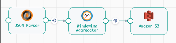

For example, let's say you have several connected processors in a fragment that ends with a destination stage, resulting in a single input stream and no output streams, as follows:
Fragment with several connected processors and a destination stage
But in addition to writing the data to the Amazon S3 destination in the fragment, you want to pass the data processed by the JSON Parser to the pipeline for additional processing.
To create an output stream for the fragment, connect the JSON Parser processor to a Dev Identity processor, and leave the Dev Identity processor unconnected, as follows:
Output stream created with an unconnected Dev Identity processor

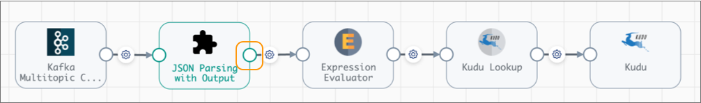

The resulting fragment stage includes an output stream that passes records processed by the JSON Parser to the pipeline:
Fragment stage including an output stream that passes records processed to the pipeline
With the fragment expanded, you can see how the Dev Identity processor passes data from the JSON Parser in the fragment to the additional branch defined in pipeline:
Expanded fragment in the pipeline

For example, say you want to validate the processing logic of the following Flatten and Mask fragment:
Sample Flatten and Mask fragment
To test fragment processing, publish the fragment and add it to a pipeline.

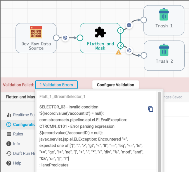

To create a pipeline that passes implicit validation, you connect a Dev Raw Data Source - or any development origin - to the fragment input stream, then connect the fragment output streams to Trash destinations as follows:
Flatten and Mask fragment added to pipeline and connected to development origin and destinations
When you validate the pipeline, validation error messages display and are highlighted in the associated stage, as with any pipeline:
Validation error messages displayed for the pipeline
To view the stage with the problem, expand the fragment and review the stage properties:
Expanded Flatten and Mask fragment
In this case, the Stream Selector conditions are invalid, so you can edit the fragment to update the expressions in the processor, then republish the fragment, update the pipeline to use the latest fragment version, and then validate the pipeline again.
Fragment publishing requirements
A fragment must meet several validation requirements to be published.
When any of the following requirements are not met, Control Hub does not allow publishing the fragment:
  1. At least one input or output stream must remain unconnected.
    You cannot use a complete pipeline as a pipeline fragment.
  2. All stages in the fragment must be connected.
    The pipeline canvas cannot include any unconnected stages when you publish the fragment.
  3. The number of input and output streams cannot change between fragment versions.
    When first published, the number of input and output streams in a fragment is defined. All subsequent versions must maintain the same number of input and output streams. This helps prevent invalidating pipelines that use the fragment.
