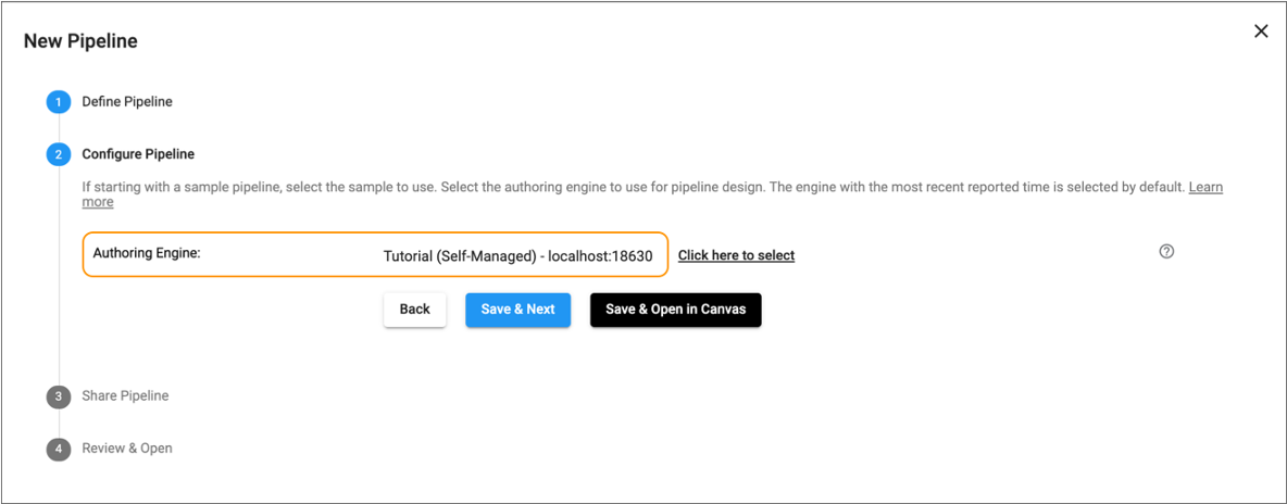

For example, the following image displays the New Pipeline wizard where Control Hub has selected a self-managed authoring engine belonging to the Tutorial deployment:
Selected authoring engine in the New Pipeline wizard

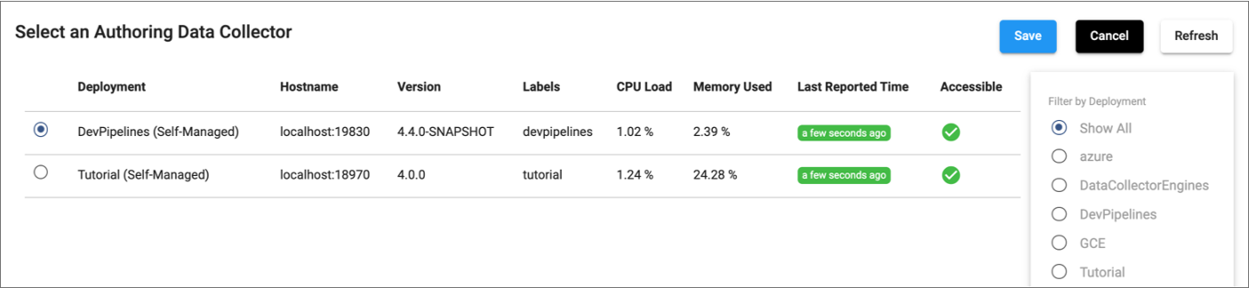

When you click the link next to the selected engine, Control Hub displays the following authoring engine selection window:
Authoring engine selection window displaying two accessible engines
The window displays all engines that you have read permission on. You can filter the list of engines by deployment, version, or label. When a deployment manages multiple engine instances, use the hostname to select a specific engine instance as the authoring engine.
