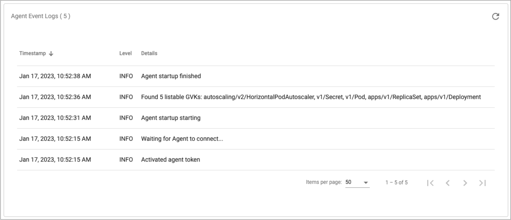

When you activate a Kubernetes environment, Control Hub generates a Kubernetes agent installation script and YAML file. You can use the script or the YAML file to launch the agent in the namespace.

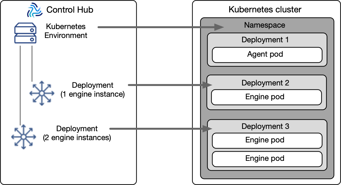

The following diagram illustrates how Control Hub objects correspond to resources in your Kubernetes cluster. In this example, Control Hub includes a single Kubernetes environment and two deployments that belong to that environment. One deployment is configured for one engine instance, and the other is configured for two engine instances.
In the Kubernetes cluster, the Kubernetes namespace specified in the Control Hub environment includes three Kubernetes deployments:
  • Deployment 1 corresponds to the Control Hub Kubernetes environment and includes a single pod that runs the IBM StreamSets Kubernetes agent.
  • Deployment 2 corresponds to one child Control Hub deployment and includes a single pod that runs one engine instance.
  • Deployment 3 corresponds to the other child Control Hub deployment and includes two replicated pods, each of which runs an identical engine instance.
Control Hub environments and deployments correspond to resources in the Kubernetes cluster

Event logs
When you view the details of a Kubernetes environment, you can view event logs for the IBM StreamSets Kubernetes agent. The event logs list all events related to the agent launched for the environment, including errors that might occur when launching the agent.
Event logs display messages only about the current activation of the environment. Each time you deactivate and then activate the environment, the previous event logs are removed.
To view agent event logs, click a Kubernetes environment name in the Environments view and then locate the Agent Event Logs section in the environment details.
The following image shows sample event logs for a Kubernetes agent:
Sample event logs displayed for a Kubernetes agent
