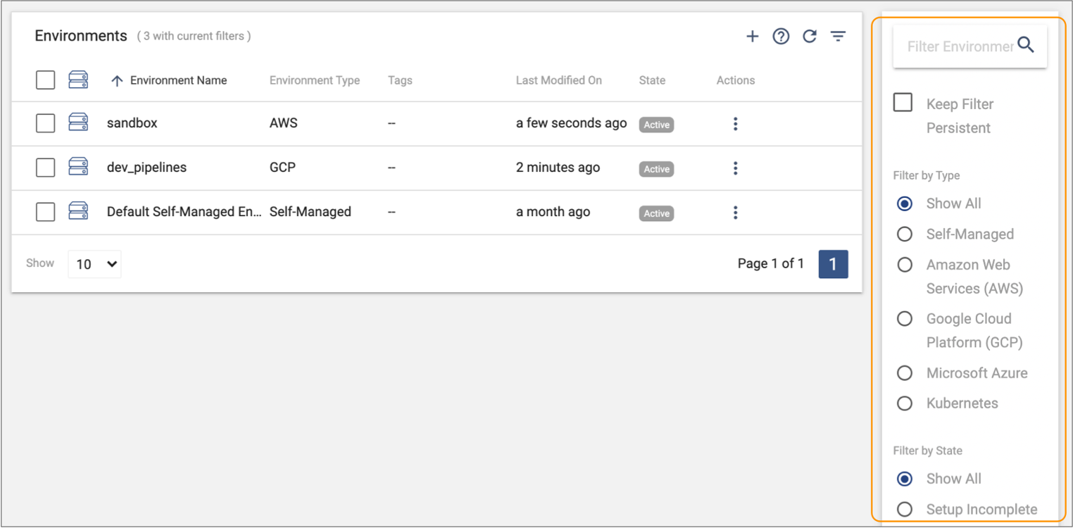

Filtering environments
In the Environments view, you can filter the list of displayed environments by environment type, state, or tag. Or you can search for environments by name.
  1. In the Control Hub Navigation panel, click Set Up > Environments.
  2. If the Filter column does not display, click the Toggle Filter Column icon: Toggle Filter Column icon.
    The following image displays the Filter column in the Environments view:
    Filter column displayed in the Environments view
  3. To search for environments by name, enter text in the search field, and then press Return.
  4. Select an environment type, state, or tag to additionally filter the list of environments.
  5. Select the Keep Filter Persistent checkbox to retain the filter when you return to the view.
    Tip: To share the applied filter, copy the URL and send it to another user in your organization.

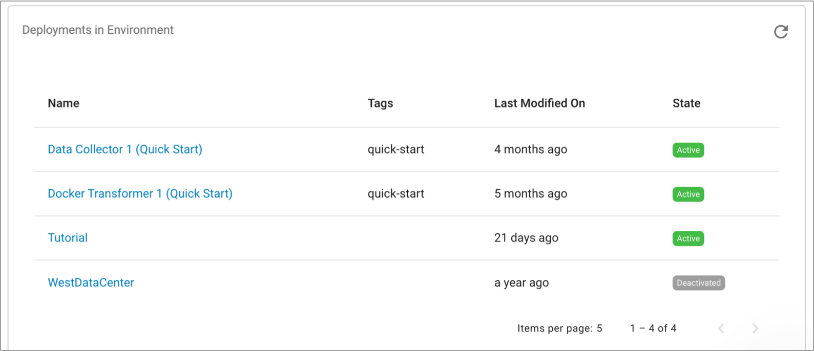

Viewing deployments in an environment
When you view the details of an environment, you can view the list of deployments that belong to the environment.
To view the list of deployments, click an environment name in the Environments view and then locate the Deployments in Environment section in the environment details.
To view details about a specific deployment, click the deployment name. When you view deployment details, you can access deployment event logs and view the list of engine instances belonging to the deployment.
The following image shows four deployments that belong to the default self-managed environment:
Four deployments belonging to the default self-managed environment
