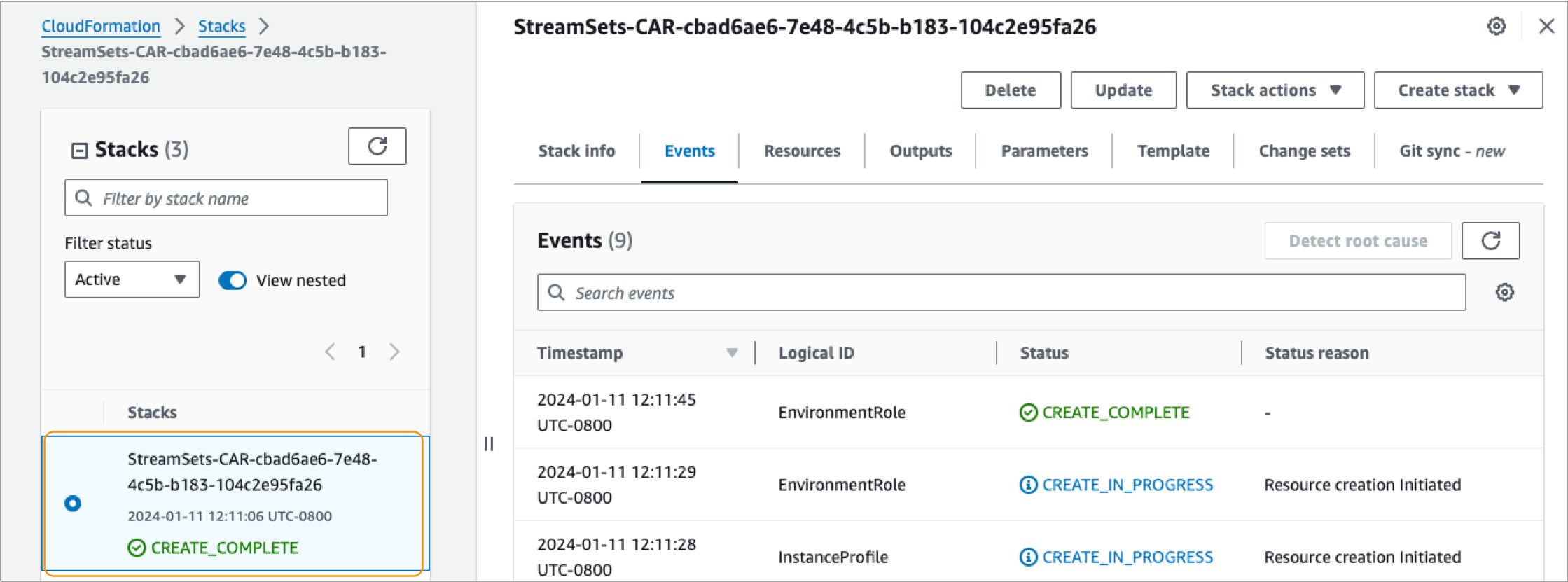

  4. Select the AWS CloudFormation acknowledgement, and then click Create stack.
    A CloudFormation stack is created with a name StreamSets-CAR-<Control Hub environment ID>.
    It can take a few minutes for the CloudFormation stack to generate the required resources. When finished, the stack displays a Create Complete status as follows:
    CloudFormation stack with a Create Complete status

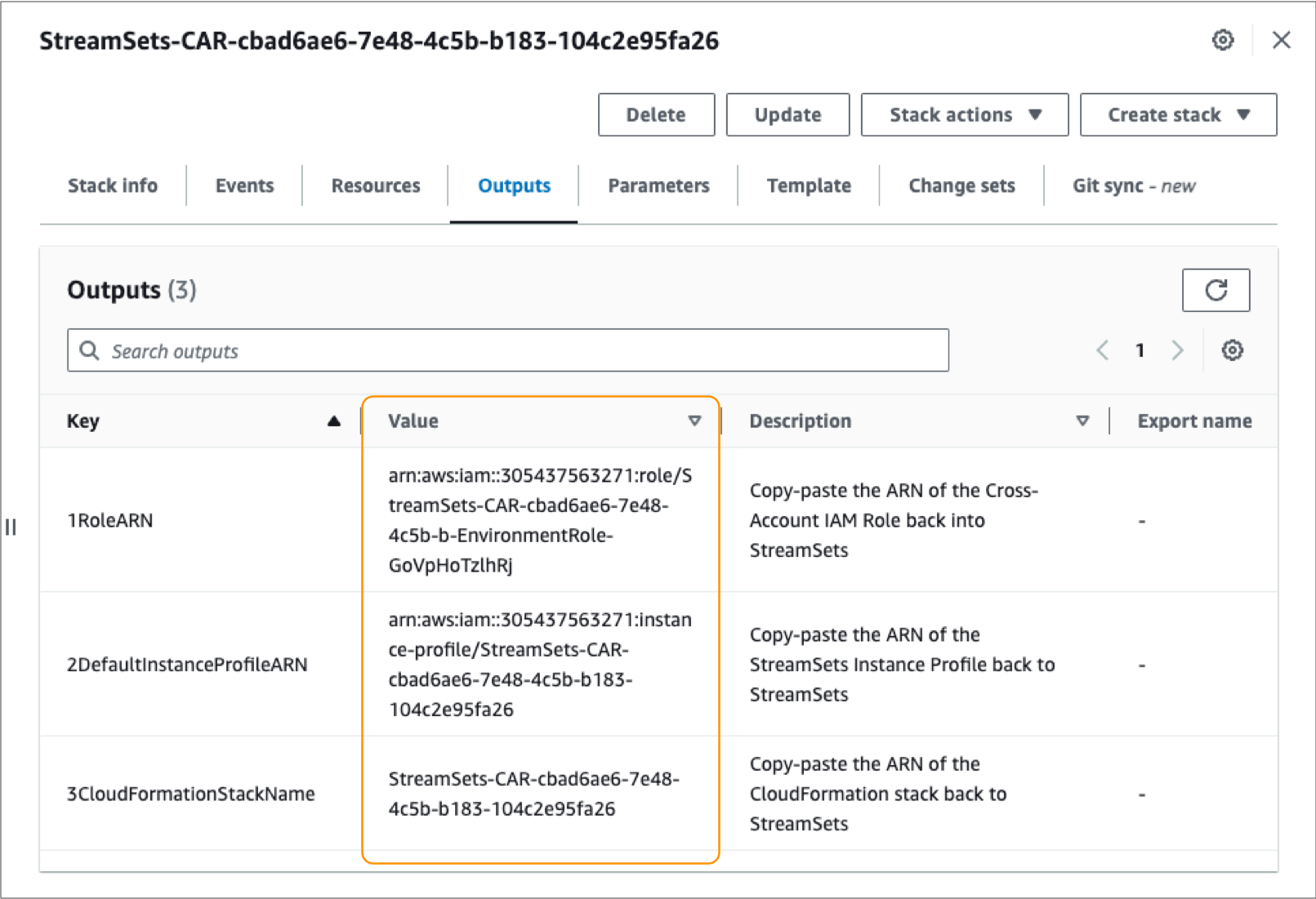

  5. Optionally, make compatible changes to the generated IAM policy attached to the default instance profile.
    1. Click the Resources tab.
    2. Click the physical ID of the instance profile role.
    3. Click the policy name to open the policy editor.

    7. Return to the CloudFormation stack details.
  6. Click the Outputs tab.
  7. Copy the following values:
    • Role ARN
    • Default Instance Profile ARN
    • CloudFormation Stack Name
    Values to copy from the CloudFormation stack Outputs tab
  8. In the StreamSets Control Hub New Environment wizard, paste the values into the following properties:
