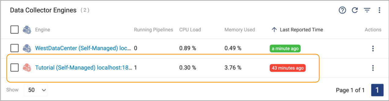

Unresponsive Engines
When you view the details of an engine in the Engines view, you can monitor the last time that the engine reported a heartbeat to Control Hub.
Engines communicate with Control Hub at regular one minute intervals to report a heartbeat and the status of running pipelines. If an engine fails to communicate with Control Hub before the maximum engine heartbeat interval expires, then Control Hub considers the engine unresponsive.
The Engines view displays a red Last Reported Time value for unresponsive engines. For example, in the following image, the Tutorial engine is unresponsive:
For more information about unresponsive engines including how Control Hub handles currently active jobs on unresponsive engines, see Jobs and Unresponsive Engines.
