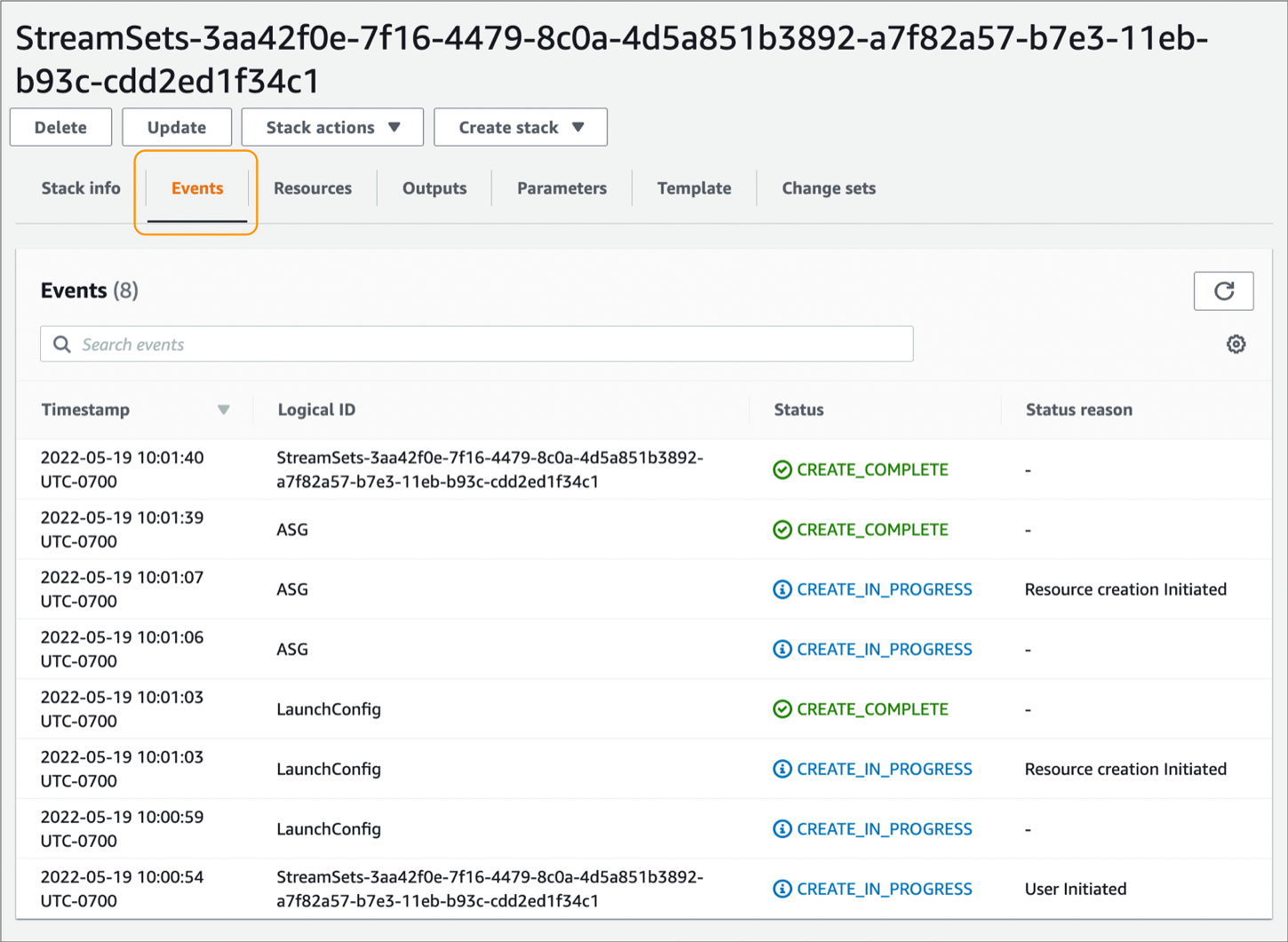

Tracking URL
When you view the details of an active Amazon EC2 deployment, you can access a tracking URL to the AWS Management Console. Use the URL to view additional information about the AWS resources automatically provisioned for the IBM StreamSets deployment.
To access the tracking URL, click an Amazon EC2 deployment name in the Deployments view and then locate the Tracking URL property in the deployment details.
- Events - Displays status and error messages that help with troubleshooting.
- Resources - Displays the resources created for the deployment, including the EC2 template and the auto scaling group.
- Parameters - Displays some of the values entered in the Control Hub UI. Use to verify that the IBM StreamSets parent environment and deployment are configured with the correct values, such as the security group, subnet, and IAM instance profile.
For example, the following image displays the Events tab for a sample CloudFormation stack:

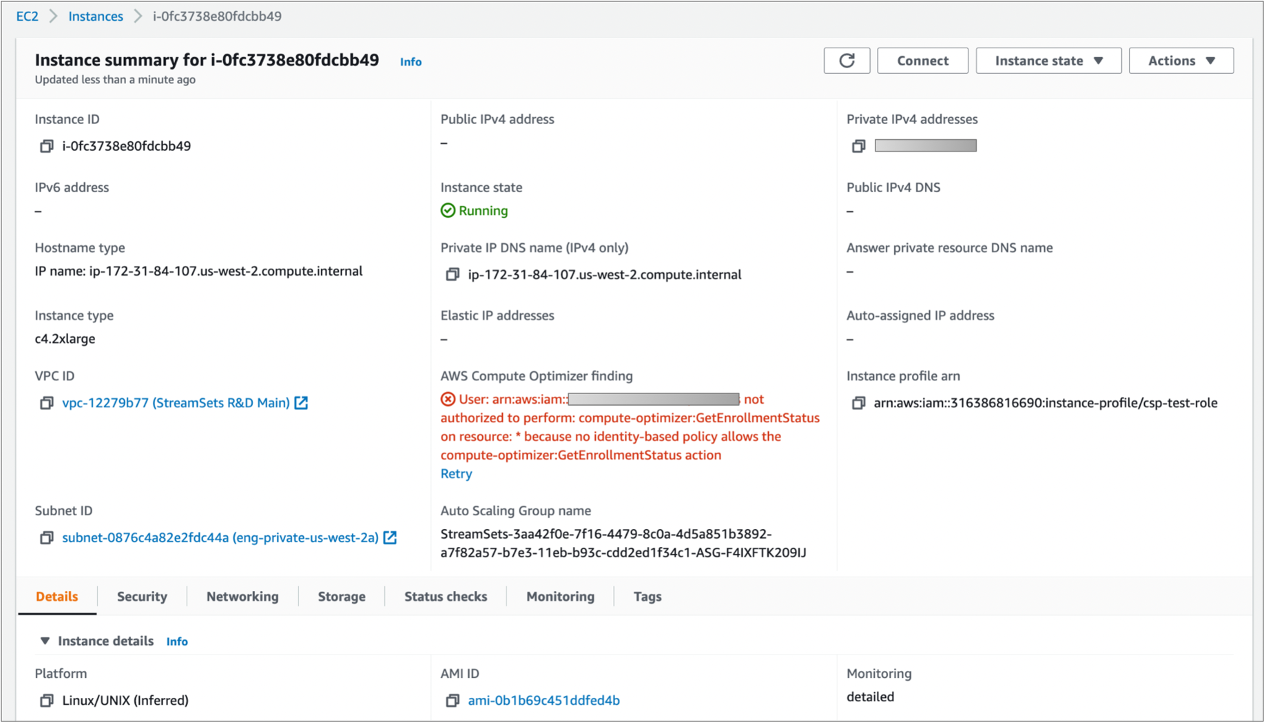

Auto Scaling Group
In the AWS CloudFormation stack details page, click the Resources tab and then click the ASG link.
- Activity - Displays status messages.
- Instance management - Includes a link to each provisioned EC2 instance.
For example, the following image displays the Instance management tab that includes one EC2 instance with a Healthy status:
In the Instances section, click an instance ID to view specific details about the EC2 instance, such as the private IP address. For example, the following image displays a sample EC2 instance summary page:
