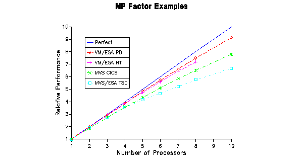

  • Not a perfect world so an N-way does not provide N times the capacity.
Speaker Notes
If we built operating systems perfectly, an N-way would provide the capacity of single processor times N (or more). Unfortunately, we are not perfect. There is some overhead involved in managing the multiple processors. One consideration of running on N-ways is the MP factor, which is a measure of how much potential capacity is lost when we add processors. For example, assume a workload run on a 1-way can support 100 transactions per second, but when run on a 2-way supports 180 transactions per second. The MP factor is 180/(2*100) or 0.90. You can look at this as a 2-way provides 90% of the throughput of 2 one ways. The MP factor often depends on the workload and on N. For some systems, their design may lend themselves to running well on smaller N, but then suffer large system effects as N increases. Some systems may be designed such that the step from 1 to 2-way is significant but that N > 2 does not have much of an impact.
The graph above shows some examples of the MP effect for two workloads for both VM/ESA and MVS/ESA. It is interesting to note that even on the same operating system the MP factor differs depending on the workload. The workloads shown here are just examples with throughput normalized to 1 for a 1-way on all workloads. While I am biased towards VM/ESA and was selective about which workloads to plot, VM/ESA does tend to have a better MP factor than MVS. The data shown is taken from LSPR measurements. There was one MVS workload that did better than the 2 VM workloads; that was the floating point calculation workload which is really a different kind of beast.
You might be wondering why the VM/ESA HT workload stops at the 8-way. This is because at this point, the HT workload becomes constrained by the master processor limitation and not the general MP factor. We will address the master processor later.
