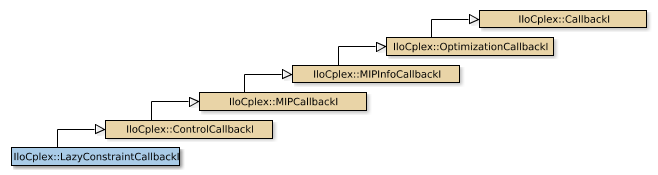

Map of IloCplex::LazyConstraintCallbackIIloCplex::LazyConstraintCallbackIIloCplex::LazyConstraintCallbackIIloCplex::ControlCallbackIIloCplex::MIPCallbackIIloCplex::MIPInfoCallbackIIloCplex::OptimizationCallbackIIloCplex::CallbackI
