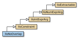

Class IloNoOverlap
Definition file: ilconcert/ilosmodel.h
Map of IloNoOverlapIloNoOverlapIloNoOverlapIloConstraintIloIntExprArgIloNumExprArgIloExtractable
An instance of this class represents a no-overlap constraint.

Inherited Methods from IloConstraint
getImpl, IloConstraint, IloConstraint
Inherited Methods from IloIntExprArg
getImpl, IloIntExprArg, IloIntExprArg
Inherited Methods from IloNumExprArg
getImpl, IloNumExprArg, IloNumExprArg
Inherited Methods from IloExtractable
asConstraint, asIntExpr, asModel, asNumExpr, asObjective, asVariable, end, getEnv, getId, getImpl, getName, getObject, IloExtractable, isConstraint, isIntExpr, isModel, isNumExpr, isObjective, isVariable, removeFromAll, setLocation, setName, setObject
