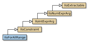

Map of IloForAllRangeIloForAllRangeIloForAllRangeIloConstraintIloIntExprArgIloNumExprArgIloExtractable
