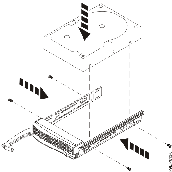

    • A 3.5-inch drive fills the tray, as shown in Figure 2. Fasten the drive to the sides of the tray with the screws (two or three screws on each side), depending on the number of threaded holes present on the drive. If the number of threaded holes is greater than the number of screws that are available, use the threaded holes that are closest to each end of the drive.
      Figure 2. Mounting the 3.5-inch drive in the tray

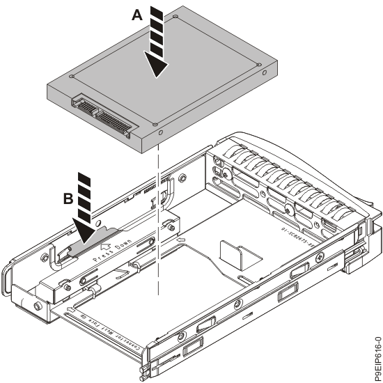

    • A 2.5-inch drive slides into the rear of the tool-less drive carrier.
      1. Turn the tray upside down as shown in Figure 3.
      2. Open the retention spring (B) as shown in Figure 4.
      3. Place the 2.5-inch drive (A) into the tray, aligning the pins with the screw holes in the drive.
      4. When the pins are aligned, close the retention spring, allowing the pins to secure the drive in the tray.
      5. Turn the tray right side up.
      Figure 3. Turning the 2.5-inch tray upside-down
      Figure 4. Mounting the 2.5-inch drive in the tray
