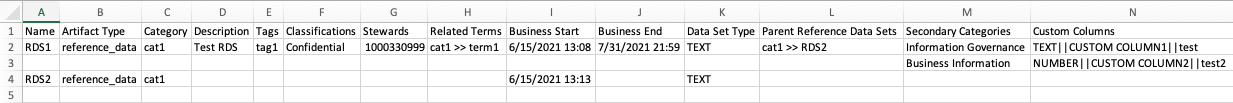

Name,Artifact Type,Category,Tags,Related Terms
businessterm1,glossary_term,myCategory1,tag1,myCategory1 >> rel_term1
,,,tag2,myCategory1 >> rel-term2
businessterm2,glossary_term,myCategory1,tag3,myCategory2 >> rel-term3
,,,tag4,myCategory2 >> rel-term4
Esse arquivo resulta em dois termos de negócios, sendo que cada um tem duas tags e dois termos relacionados, que incluem seus caminhos de categoria integrais.

Name,Artifact Type,Category,Classifications
Account,glossary_term,Insurance >> Business Area >> All Accounts,Insurance >> concept

Exemplo :
Name,Artifact Type,Category,Description,Tags,Classifications,Stewards,Related Terms,Business Start,Business End,Data Set Type,Parent Reference Data Sets,Secondary Categories,Custom Columns
RDS1,reference_data,cat1,Test RDS,tag1,Confidential,1000330999,cat1 >> term1,6/15/2021 13:08,7/31/2021 21:59,TEXT,cat1 >> RDS2,Information Governance,TEXT||CUSTOM COLUMN1||test
,,,,,,,,,,,,Business Information,NUMBER||CUSTOM COLUMN2||test2
RDS2,reference_data,cat1,,,,,,6/15/2021 13:13,,TEXT,,,
Em um programa de planilha, a definição seria semelhante a esta:
