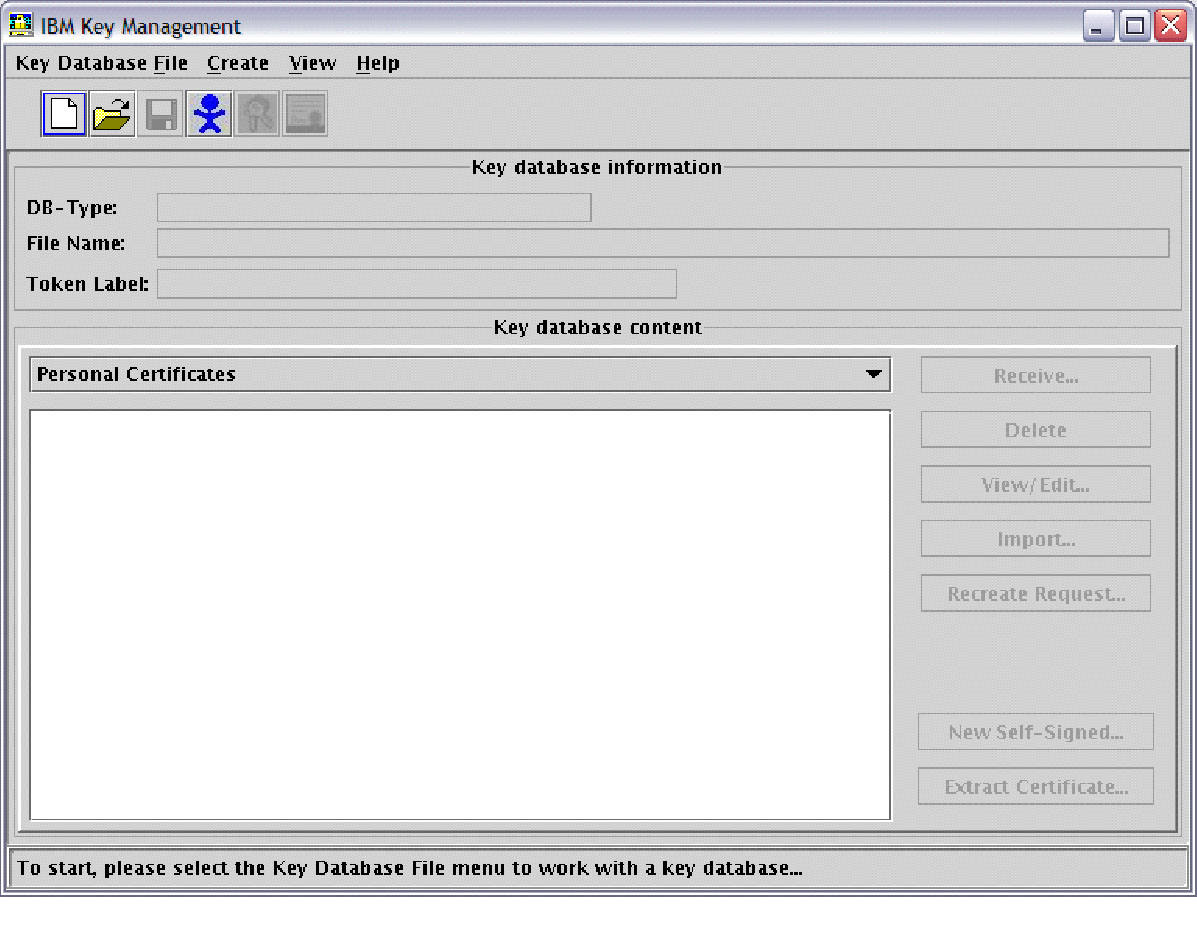

    gsk7ikm
    1. Run gsk7ikm.
      The following screen appears.
      Figure 1. IBM® key management screen
      seal18
      1. From Figure 1, select Key Database File –> Open.

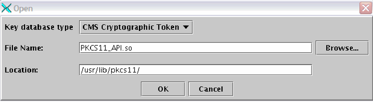

      2. The following box opens.
      Figure 2. Key database file entry box
      seal19
      1. Select the Key Database Type of CMS Cryptographic Token.
      2. Enter PKCS11_API.so for the file name.
      3. Enter "/usr/lib/pkcs11" for the location.

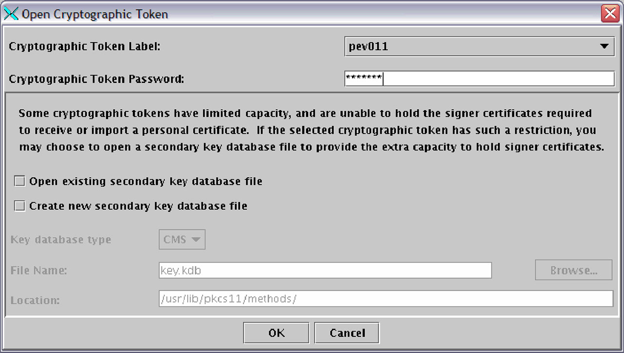

      Figure 3. Open cryptographic token screen
      seal20
      1. Enter the cryptographic token password that you set before (01234567).
      2. Deselect the Open existing secondary key database file box.
      3. Click OK.

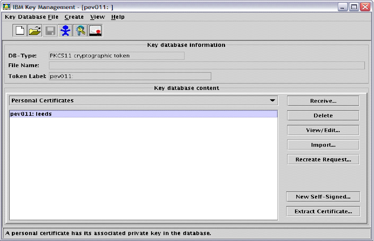

      4. On the IBM key management screen (see Figure 1), click on New Self-Signed...
      The following screen is displayed:
      Figure 4. Create new self-signed certificate screen
      seal21
      1. Enter the appropriate information to create the certificate.
      2. Click OK.
      The self-signed certificate you just created will now be visible on the IBM Key Management screen as show below.
    Figure 5. IBM Key Management screen showing self-signed certificate
    seal22
    Exit the gsk7ikm application.
