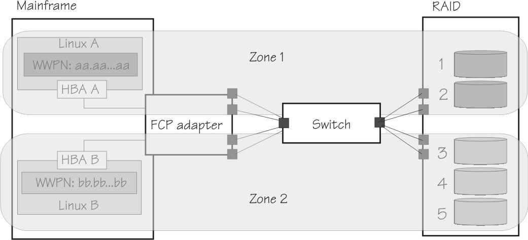

In WWN zoning a zone is a set of Fibre Channel ports where each Fibre Channel port is specified by its worldwide name (WWN). WWN zoning allows a device to communicate only with other devices whose WWNs are included in the same zone, see Figure 1.
In both cases you need to ensure that the FCP channel and the target port you want to access are members of the same zone. Otherwise it is impossible to gain access to the target port.
Figure 1. Zoning partitions storage resources.
This graphic is described in the text preceding it.
