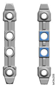

    1. Locate the four universal rack connectors, four Philips screws, and two rackmount rails (LH and RH).
      Note: The universal rack connectors have two sides, for round hole and square hole racks. The square-hole side might be painted.
      Figure 1. Universal rack connector

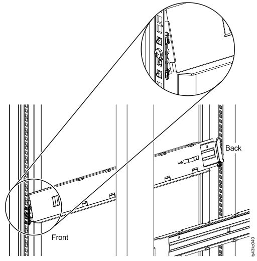

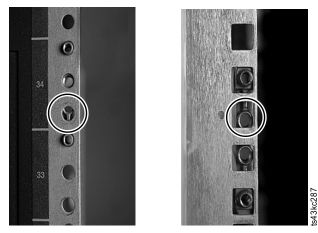

    2. On the inside of the racks, facing out, mount the connectors at the appropriate height to the right and left rack posts. Mount them in the middle hole of the height unit (the middle of a height unit is the hole between two wide and neighboring division bars) in both front and back. The four screw holes must align with the holes on your rack. If they do not, the blocks are not in the correct location. See Figure 2 and Figure 3.
      Note: If the connectors are installed incorrectly, the screws on the connectors do not match the holes on the frames. The circles in the graphics highlight the mismatch.

    4. Mount the LH Rackmount rail to the connectors. See Figure 4.
    5. Repeat step d with the RH Rackmount Rail.
      Figure 4. Mounting the rails to the connectors
      Mounting the rail to the connectors

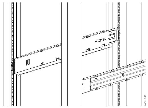

      Figure 5. Side rails installed

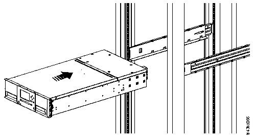

  3. Place the library at the front of the rack on the support angles of the rails and push it into the rack to the back stop.
    Figure 6. Sliding the library into the rack

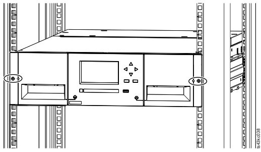

  4. If you are installing multiple modules, verify that this module is installed directly above or below its adjacent module and is contained within the correct 3U volume. Remove the tape that is covering the alignment pin lock/unlock lever on the rear of each module. The gap between modules must be less than 4 mm.
    Figure 7. Library in the rack
    Library in the rack
    Important: Each module must be on its own rails.
  5. With a Phillips screwdriver, loosely screw the module to the front of the rack, one screw on each side. See the circled areas in Figure 7.
  6. Align the module as needed. Then, tighten the screws on each side of the module. See Aligning and connecting modules.
