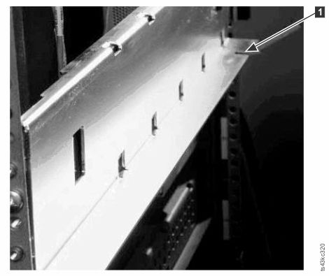

If you encounter resistance, adjust the position of the upper module so the pin in the alignment
mechanism moves into the mating hole in the lower module. If you still encounter
resistance, check to see if the rack rails are installed correctly. Check that the hole for the
alignment pin is on the left rail (looking from the front) toward the back of the rack. See
1 in Figure 1.
Figure 1. Hole for alignment pin

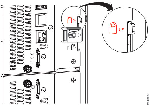

Note: If a blue alignment lever lock is attached to the rear of the module, slide it to the left, then move the alignment lever. The lever lock has an internal spring, so hold it while the alignment lever is moved, and it automatically springs back into place after the lever is moved. See Figure 2.Figure 2. Alignment lever lock
Figure 3. Alignment lever locked or engaged to lower module
Figure 4. Alignment lever unlocked or disengaged

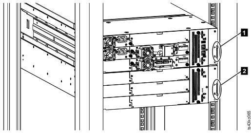

Figure 5. Two modules in rack, seen from the rear
1 Locked 2 Unlocked - From the front of the library, tighten the Philips screws on each of the modules to secure the modules to the rack.
