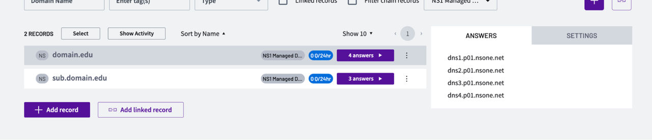

  1. Create the parent zone. This must be a primary (or non-secondary) zone. Refer to Creating a primary zone for instructions.

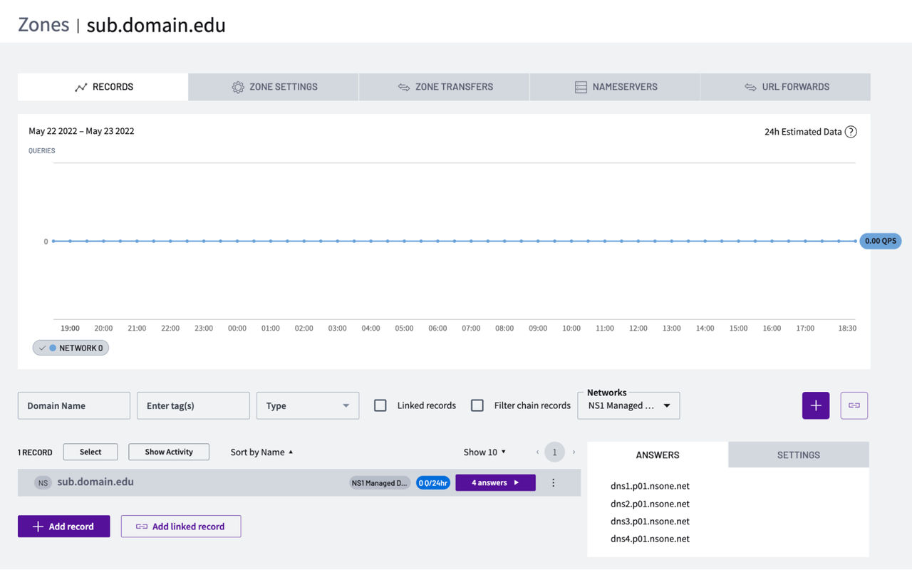

  2. Create the subdelegation or child zone. Refer to Subdelegations and child zones for details.
  3. If you haven't already, add a new NS record to the parent zone matching the NS record found in the subdelegated/child zone.

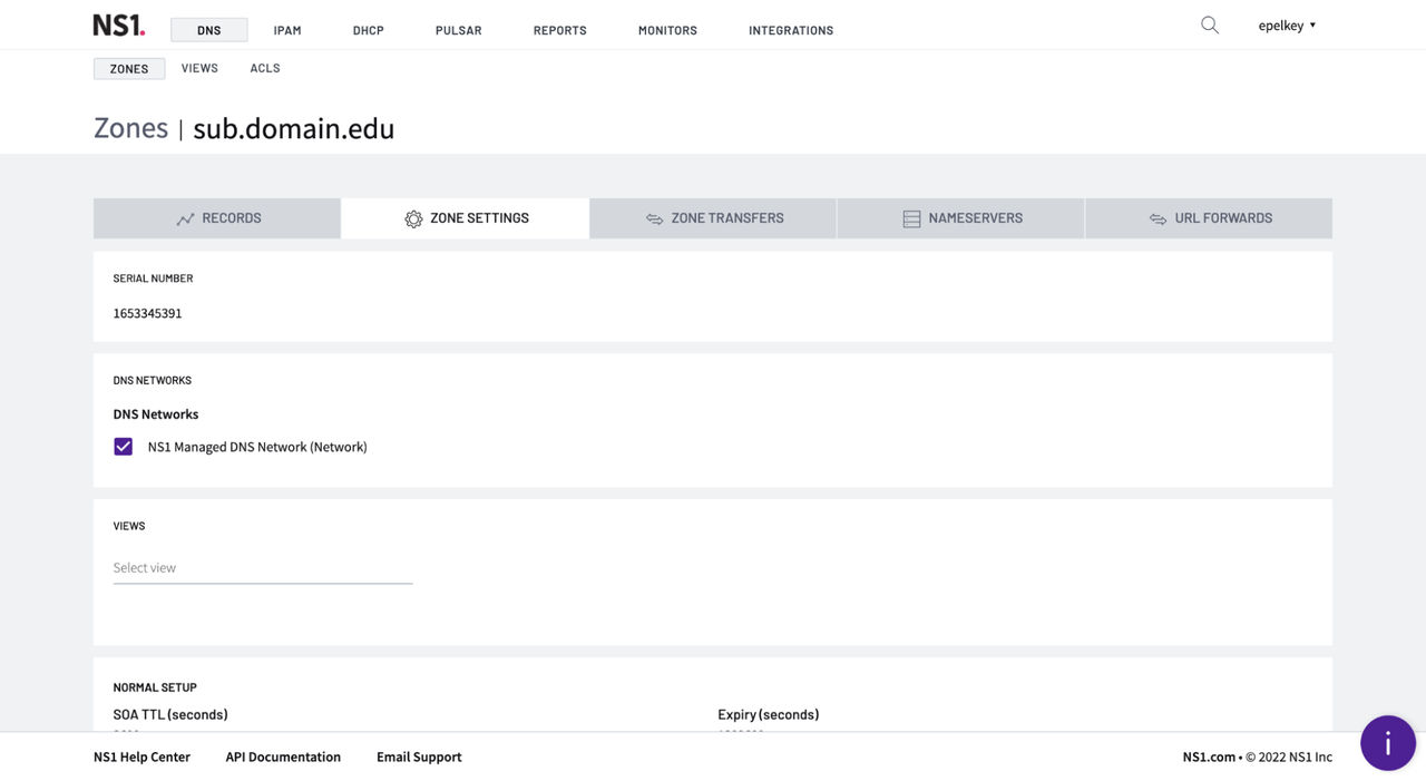

  1. Click DNS > Zones.
  2. Click the name of the child zone to drill down into zone details.
  3. Click the Zone settings tab.

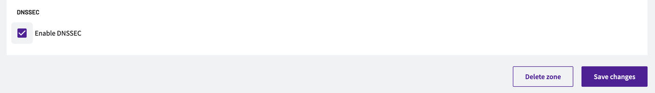

  4. Scroll to the bottom of the page to the DNSSEC section, and then select the Enable DNSSEC checkbox.
  5. Click Save changes.

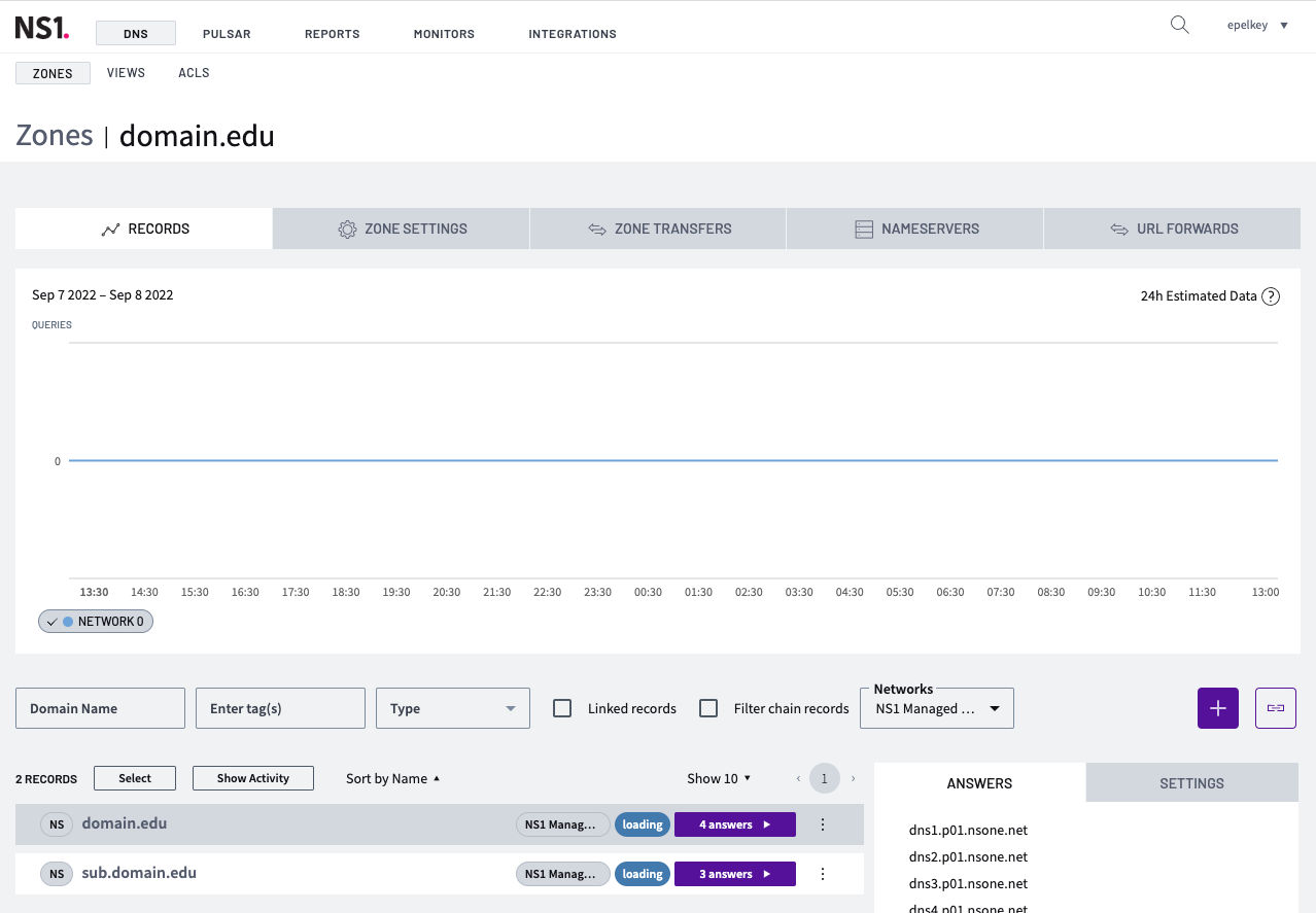

  2. Click the name of the parent zone (for example, domain.edu) to drill down into zone details.

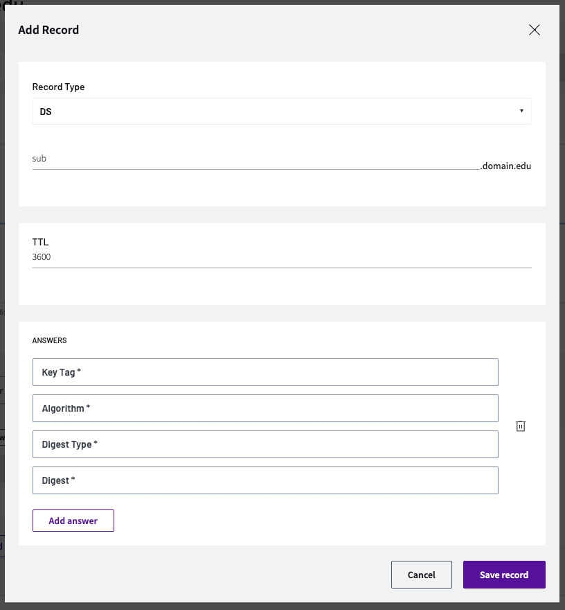

  3. Click the + (add) button to create a new record. The Add Record window opens.
  4. Under Record type, select DS from the list.
  5. In the name field, enter the subdomain prefix corresponding to the subdelegated/child zone (for example, sub.domain.edu).
  6. Under Answers, complete each form field with the subdelegated/child zone's DNSSEC configuration details (recorded in Step 3), including the key tag, algorithm, digest type, and digest data.
  7. Click Save record.
