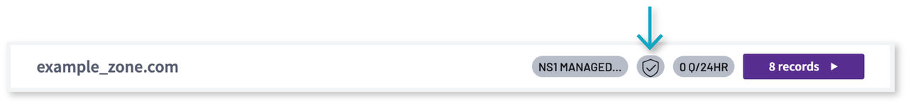

Enabling DNSSEC for a primary zone is a two-step process. First, you must enable DNSSEC by selecting the check box in the zone settings, and then clicking View detailed instructions to display the information you need to apply at the domain registrar. DNSSEC-enabled zones appear in the zone list with a shield icon.

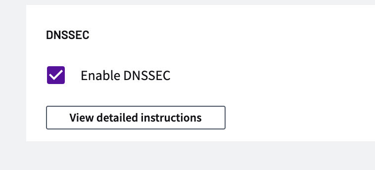

  4. At the bottom of the page, select the Enable DNSSEC checkbox.
  5. Click Save changes. A new button appears beneath the DNSSEC option.

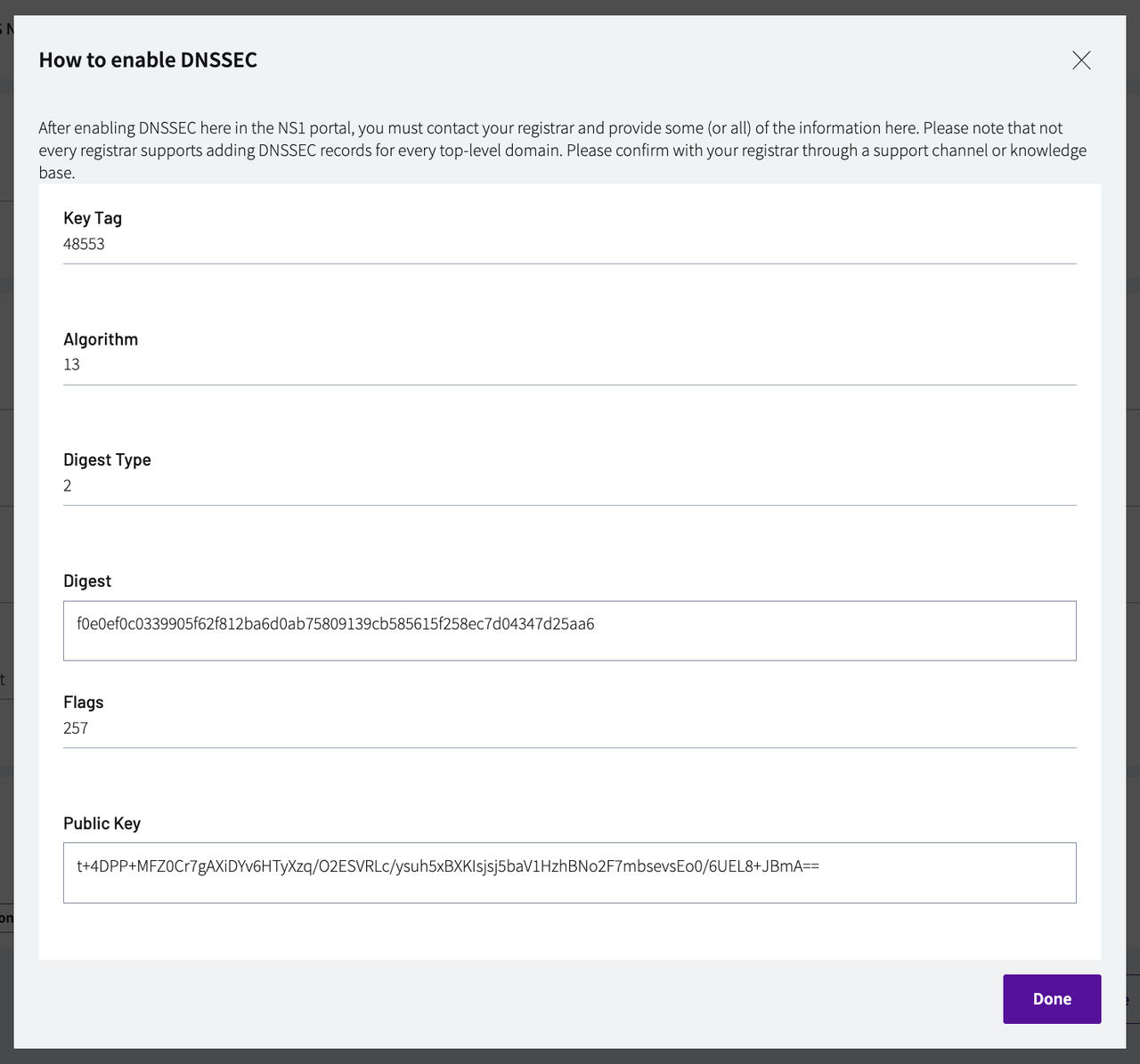

  6. Click View detailed instructions to view the DNSSEC key tag, algorithm, digest type, digest, flags, and a public key associated with this zone.
    Record the DNSSEC details as you will need them to update the registrar in the next step. Note that you can hover over each option and click to copy the data to your clipboard.

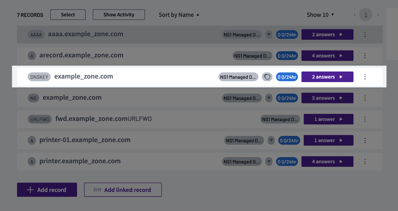

Enabling DNSSEC automatically creates a DNSKEY record within the zone.
Also, a shield icon appears next to the zone on the Zones tab, indicating DNSSEC is enabled.

To complete the DNSSEC configuration, you provide your registrar with the DNSSEC information required for them to create a DS record within the TLD’s zones. Refer to the instructions provided by your domain registrar to apply the DNSSEC configuration details shown in the View detailed instructions dialog box in the previous step — including the key tag, algorithm, flags, digest, digest type, and public key.
