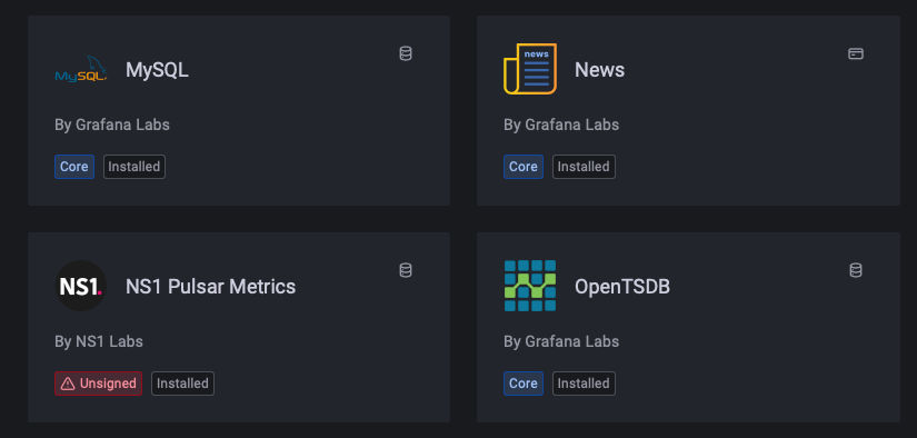

  1. In Grafana, navigate to the Configuration page from the sidebar menu, and then select Plugins to view a list of available plugins.
  2. Verify that the NS1 Pulsar Metrics is included in your list of installed plugins. If you do not see it, refer to your Grafana logs and search for any relevant error message.
    Note: You may see a temporary unsigned warning while the plugin is in the review queue of Grafana Labs.

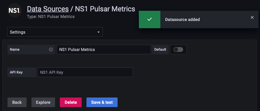

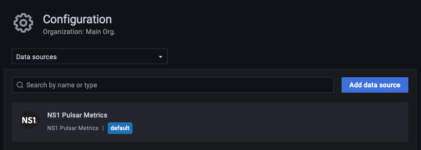

  3. Navigate to the Data sources tab (Configuration > Data Sources) and click Add data source.
  4. Search and select the NS1 Pulsar Metrics data source (listed under Others).
    A confirmation message indicates the data source was added successfully, and then you are redirected to the plugin configuration page.

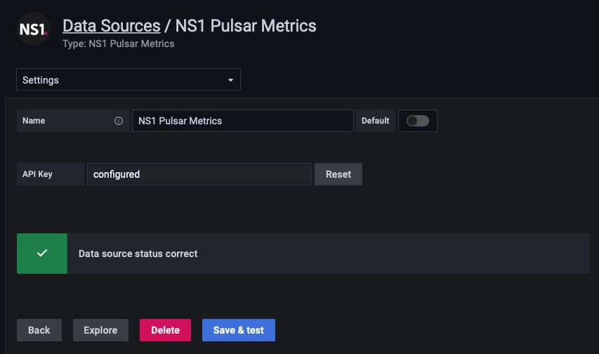

  5. Next to API Key, enter the NS1 Connect API key you created earlier. The API key is stored securely in the Grafana database. When complete, click Save & test. Grafana validates that the API key can be used to pull data from NS1 Connect. If successful, a confirmation message appears.
    Note: If Grafana returns an error message, check the NS1 Connect API key secret or verify the API key permissions to ensure they are correct.
    Click Back to return to the configured data sources. The NS1 Connect Pulsar data source appears in the list.
    If this is the only data source you have installed, it is labeled as default. As you configure additional plugins, you can specify one to be the default.

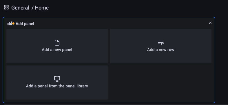

  1. Create a new Grafana dashboard or navigate to an existing one.
  2. Click the Add panel icon in the upper-right corner.
    The new options appear above the dashboard.

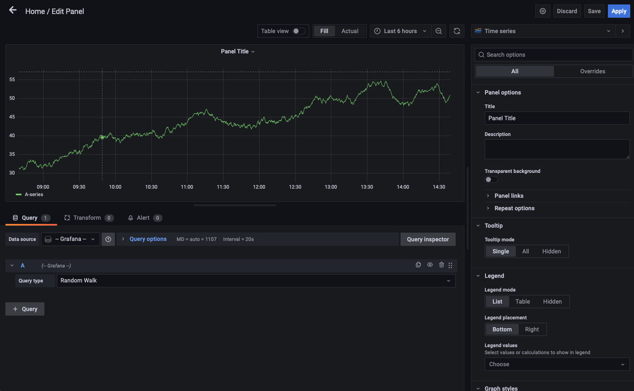

  3. Click Add a new panel.
    The screenshot above shows a sample query with data from Grafana's default data source. Your view might look different depending on your configuration.
    Click the Data source drop-down menu (on the lower left, under the Query tab) and select NS1 Pulsar Metrics. Now, all the available Pulsar applications and jobs are available for selection. Note that you can only view the applications and jobs accessible to the NS1 Connect API key you entered when configuring the data source.

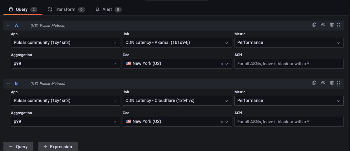

  4. Under App, select a Pulsar application. A Pulsar application is a collection of Pulsar resources.
  5. Under Job, select a Pulsar job. A job corresponds to a single Pulsar resource (for example, CDN, data center, cloud, and so on) being measured. The resource hosts an asset (such as a single-pixel image) to measure availability and latency when the JavaScript tag is executed upon page load.
  6. Under Metric, select a metric type (that is, performance or availability) from the list.

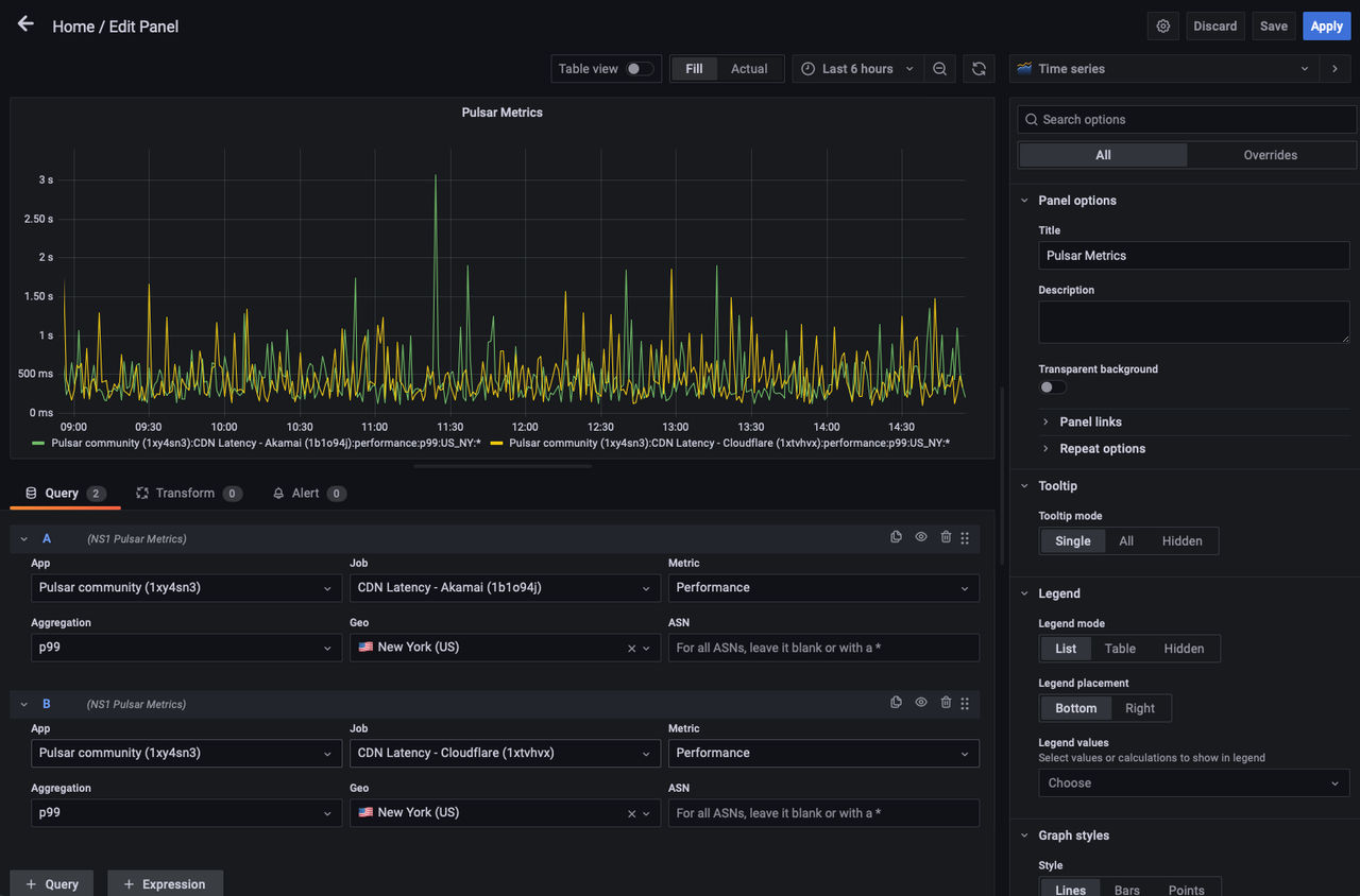

  7. Under Aggregation, select one of the precalculated aggregations (min, max, avg, p50, p75, p90, p95, p99).
  8. Optionally, you can select a Geo and/or ASN to filter the data, although it's recommended to provide at least a Geo to avoid having a chart showing the global behavior of the CDN, which will only be meaningful under certain circumstances.
  9. On the right-hand sidebar, enter a Title for the new panel and adjust the panel settings and preferences as desired. You will likely want to set the Y-axis units to milliseconds.
  10. Optionally, you can specify additional queries to compare performance or availability data for multiple Pulsar applications and jobs. See below for details.
  11. When you’re ready, click Apply to keep your changes. Click Save in the upper right corner when you are done. You will exit the edit mode.

Comparing RUM data in the Grafana panel
After creating a new panel in the Grafana dashboard, you can compare the performance data of two Pulsar RUM applications and/or jobs. To do this, configure a new panel or select an existing panel showing at least one set of RUM data.
Under the first query (A), click + Query.
A second query appears with additional settings.
Under the new query (B), select the application and job you want to compare with the first query. Now, the graph shows two data sets, one for each defined query.
Note: When adding additional queries for comparison, be sure to select the same RUM application, job, metrics, and aggregation so that you are comparing data of the same type.
