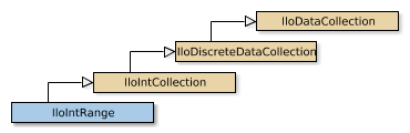

This class represents the domain of an integer range. It can be enumerated using an iterator. It is represented by a lower bound and an upper bound.
