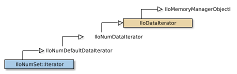

Map of IloNumSet::IteratorIloNumSet::IteratorIloNumSet::IteratorIloDataIterator
This class is an iterator that traverses the elements of a finite set of numeric values.
An instance of the nested class IloNumSet::Iterator is an iterator that traverses the elements of a finite set of numeric values (an instance of IloNumSet).
