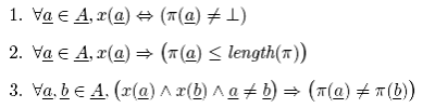

More formally, an interval sequence variable p on a set interval variables A represents
a decision variable whose possible values are all the permutations of the intervals of A.
Let
be a set of fixed intervals and n denote
the cardinality of
A permutation π of
is a
function π :
[1, n]
such that if we denote length(π) = |{
, x(
)}| the number
of present intervals:

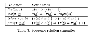

The formal semantics of these basic constraints are given in Table 3.

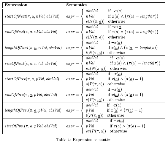

Two integer expressions are available to get the type of the interval that is next (resp. previous) to a given interval variable a in a sequence p. When interval a is absent or is the last (resp. first) interval of the sequence, specific values can be provided for these integer expressions.
More formally, let π be the permutation value of a fixed sequence variable p, and
be the value
of a fixed interval variable a in the fixed sequence variable p.
If
is present and is not the last interval
in π, we denote
the unique interval
that is next to
in π.
If
is present and is not the first interval in π, we
denote
the unique interval
that is previous to
in π.
Integer expressions startOfNext, endOfNext, lengthOfNext, sizeOfNext, startOfPrev, endOfPrev, lengthOfPrev, and sizeOfPrev provide access to the different attributes of the interval that is next (resp. previous) to a given interval variable a in a sequence p. When interval a is absent or is the last (resp. first) interval of the sequence, specific values can be provided for these integer expressions.
The semantics of these expressions are given in the table below.
