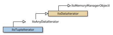

Map of IloTupleIteratorIloTupleIteratorIloTupleIteratorIloDataIterator
This class allows you to iterate on the elements of an IloTupleSet.
It contains an internal tuple that is reused at each iteration. There is no allocation of a tuple per iteration.
