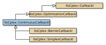

Map of IloCplex::ContinuousCallbackIIloCplex::ContinuousCallbackIIloCplex::BarrierCallbackIIloCplex::SimplexCallbackIIloCplex::ContinuousCallbackIIloCplex::OptimizationCallbackIIloCplex::CallbackI
