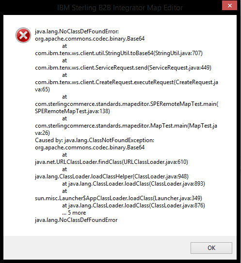

Sometimes, after you run the SI Map Test tool and switch to the SPE Map Test tool, you receive an error.
Problem
You might receive an error message similar to the following.
Cause
You encounter this error because you might have previously run the SI map tests.
Resolution
To resolve the issue, close the map test tool. Then, restart the map test tool and run the SPE Remote Map Test by using the Configuration Hub endpoint.
